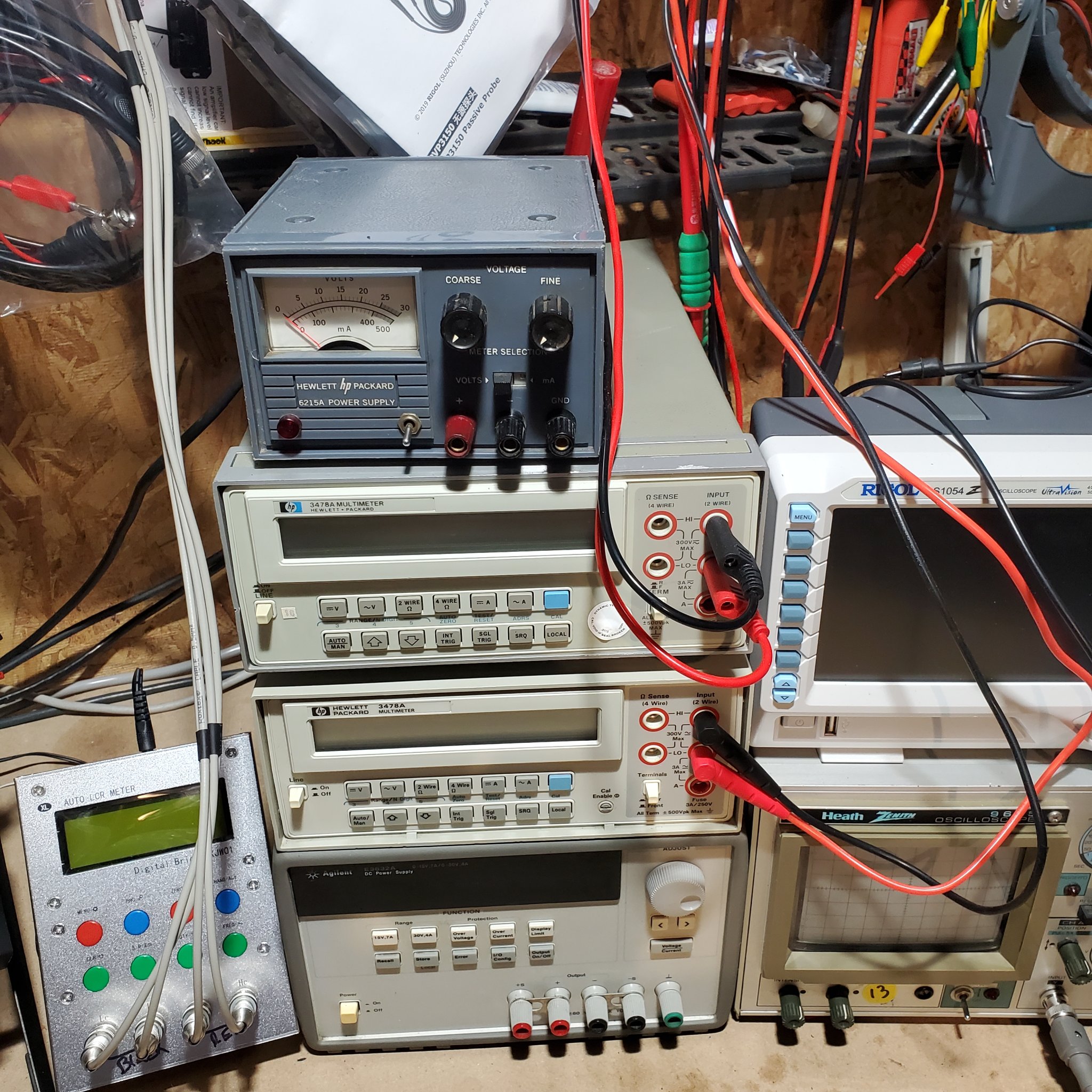

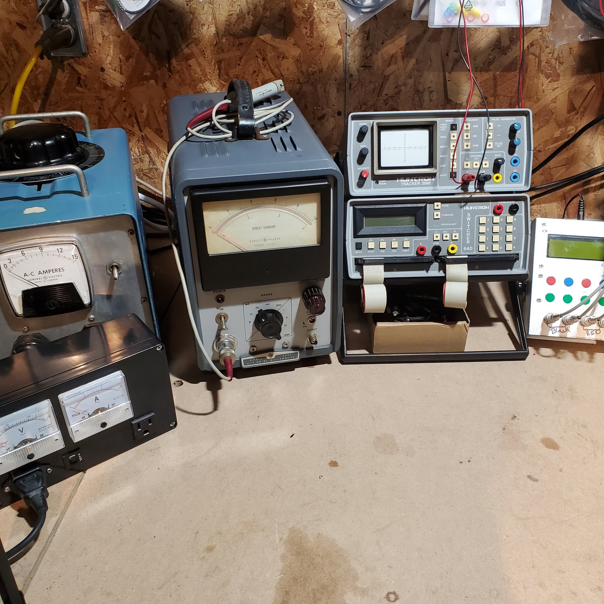

Well got the Huntron tracker 2000 home yesterday and checked it over , everything seems to be working fine and I really like it . Came with all the factory manuals, adaptors and jumper leads so it's very complete , the guy must have been a chain smoker because it took me an hour to get all the tar off but she is nice and clean now . it also came with it's mating Huntron 640 Switcher . Don't know what exactly a switcher is used for , anyone ever use one , something to do with checking IC chips I think . Also picked up a HP-428 clamp probe meter .had to pull the tubes and clean the sockets but now it's working fine, and finally a small more less novelty HP-3215 power supply but though it was cool . have pretty much all my basic's equipment now .cheers Roger
