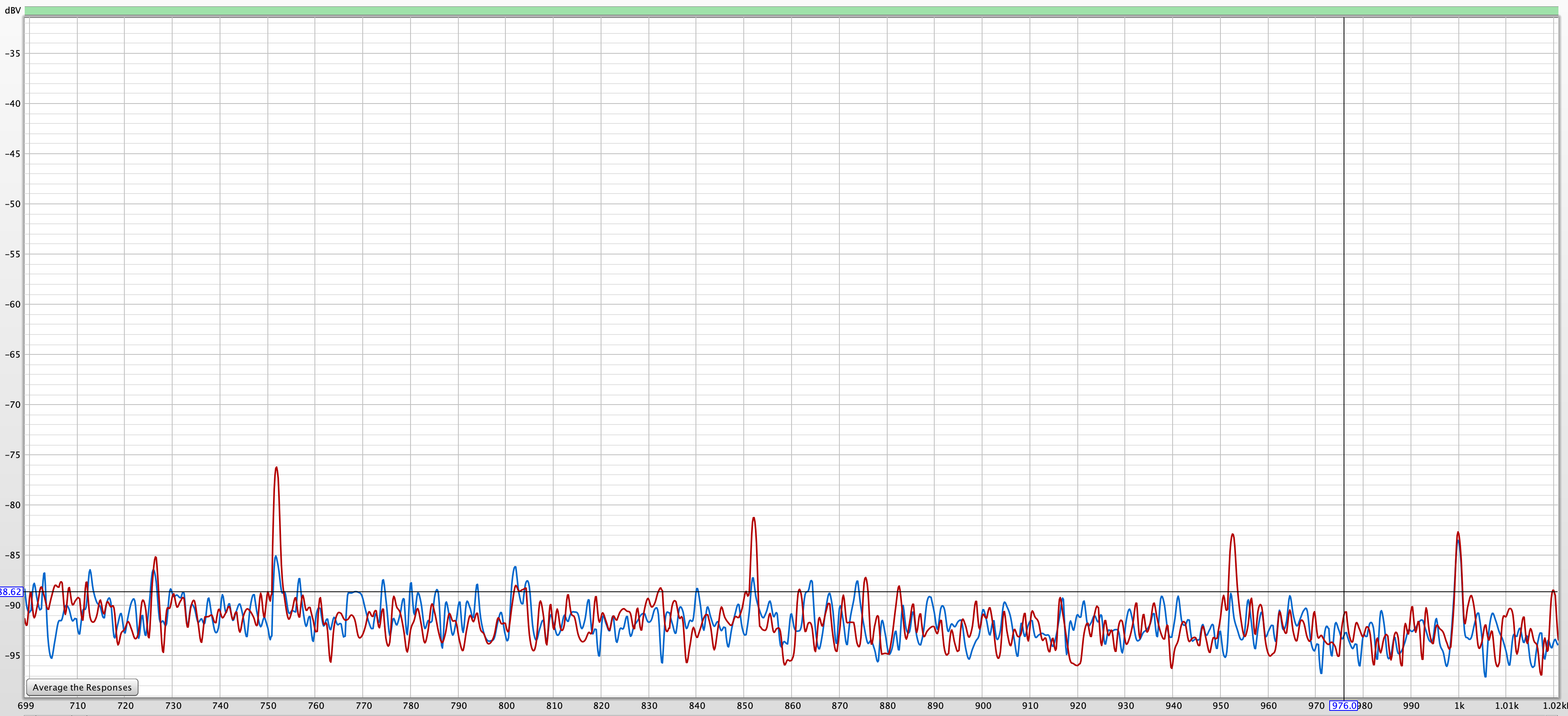

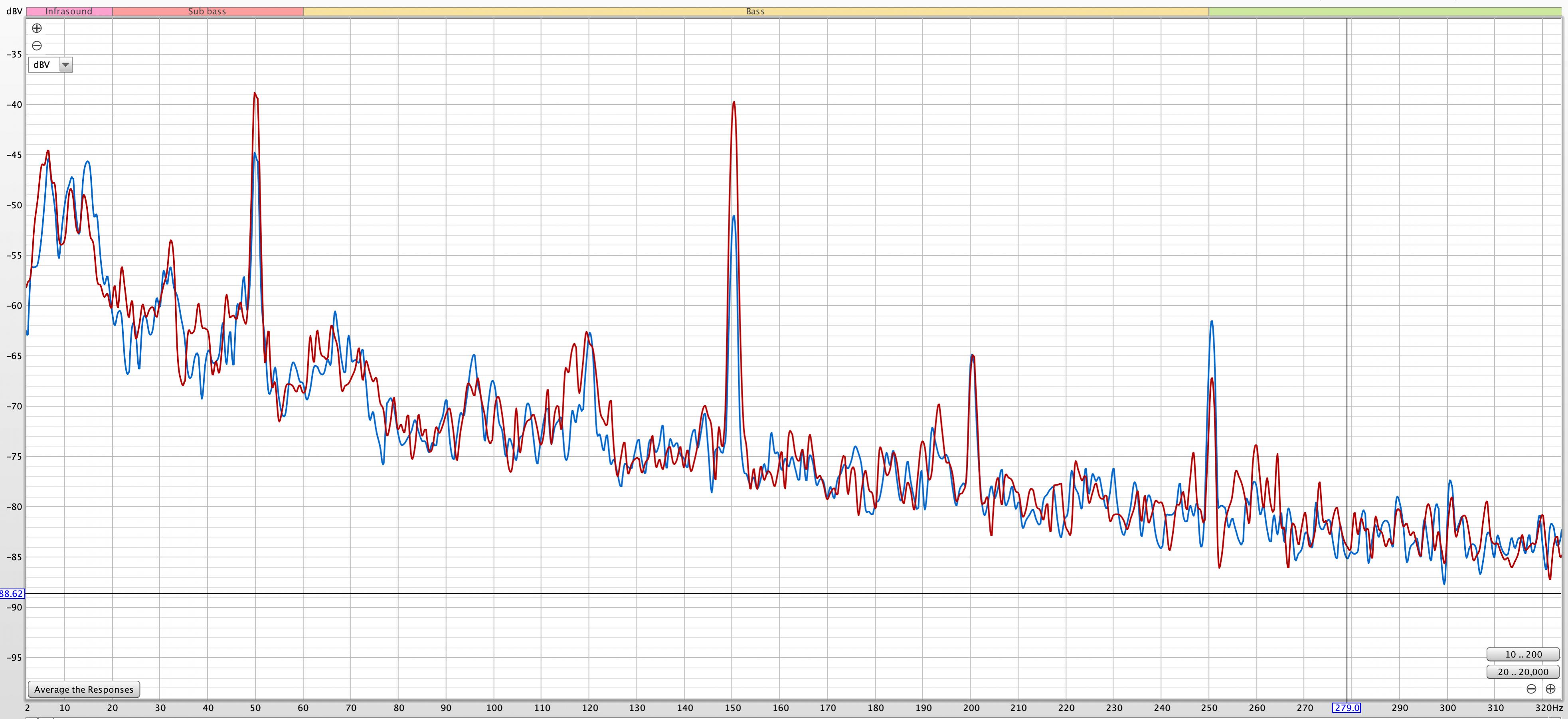

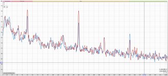

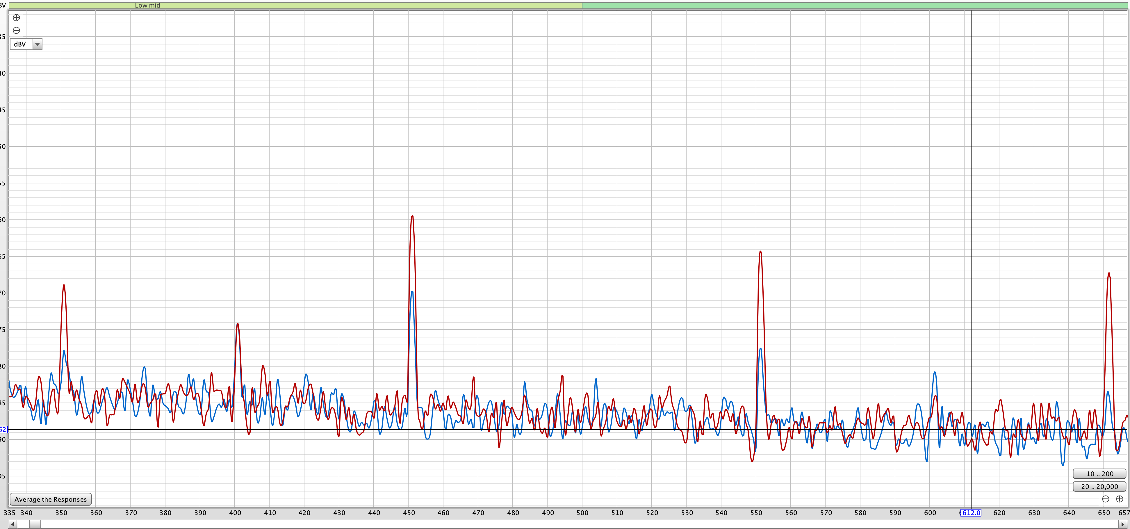

So I have got my hum down to a sort of acceptable level BUT it is still there. I have a friends similar preamp here and it is totally silent....but it is also a two box keeping AC away from the active signal stages.
My 'noise' seems to be intervals for 50 Hz, is there any way of determining if this is induced or coming from PS directly by looking at the frequencies?
The two traces are with no signal playing but unmuted and the red trace is at full volume, which is quite hummy/noisy.
Thoughts?

No obvious mains 2nd harmonic so its mainly direct pickup from the mains, not PS ripple which is strongly even harmonics.
I note the steel plate arrangement could be transporting mains hum field into the circuitry, the only sensible shield for a transformer is a mu-metal jacket around the transformer with no protruding parts that could leak flux. Pointy parts are where flux comes out strongest.
Distance is a good defence against magnetic hum fields as magnetic dipole fields fall off with the cube of distance.
The signal paths probably need screened cable (screen grounded at one end only). Ground layout and ground loops may be a factor. Deteriorating ground connections are worth checking for (tighten any ground points that are bolted).
I note a lot of large sized film caps - are these all the right way round (outer film to low impedance part of circuit)? Valve circuitry is high enough impedance that this can make a big difference to stray pick-up. For a coupling cap both ends are sensitive to pickup and these need to be kept away from any 50Hz source.
