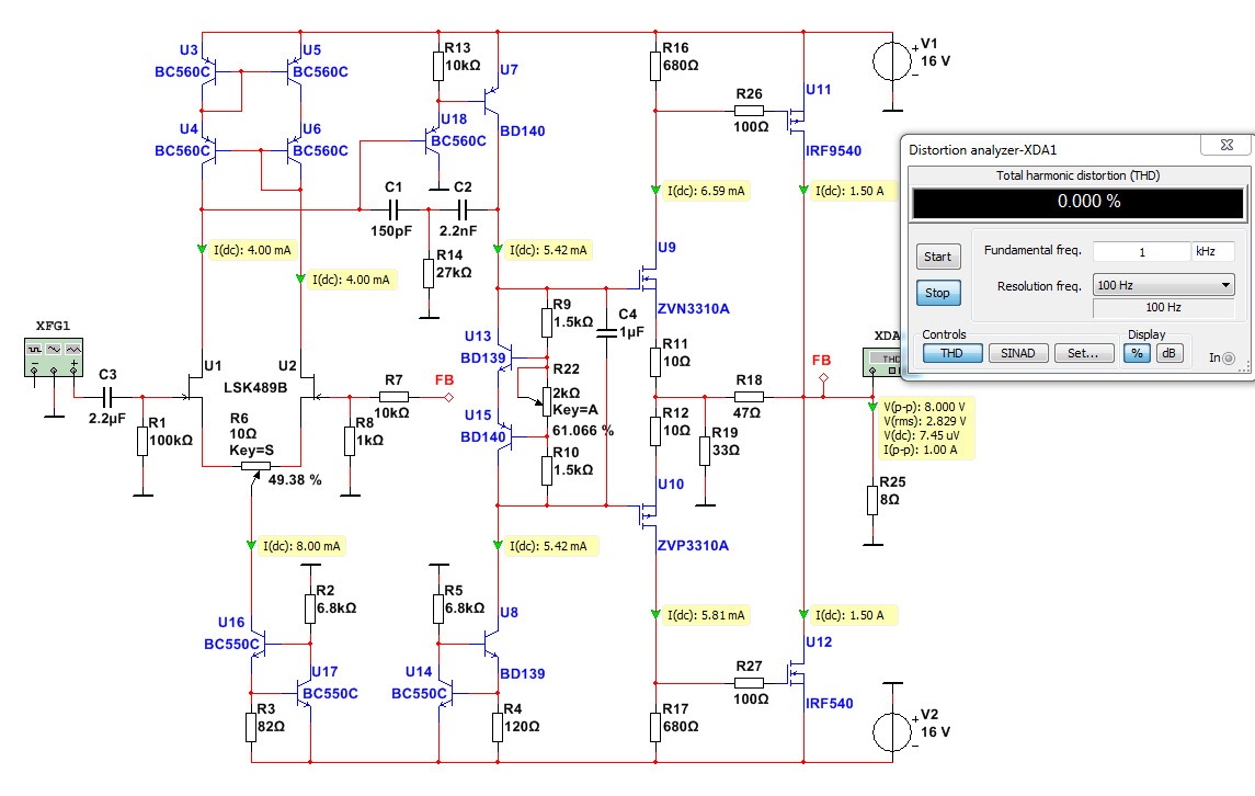

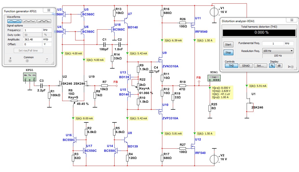

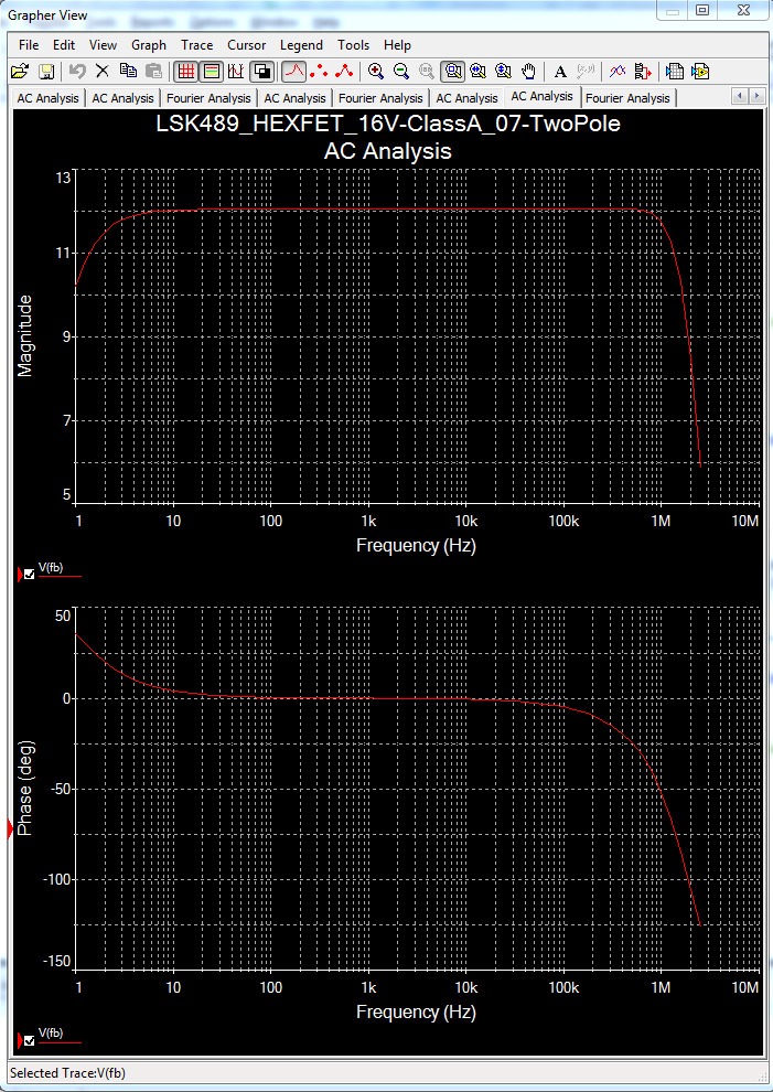

Humble Two. 15 Watt Class A. JFET input IRF540/9540 output.
