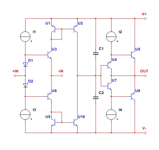

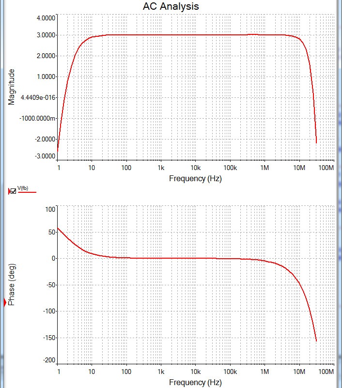

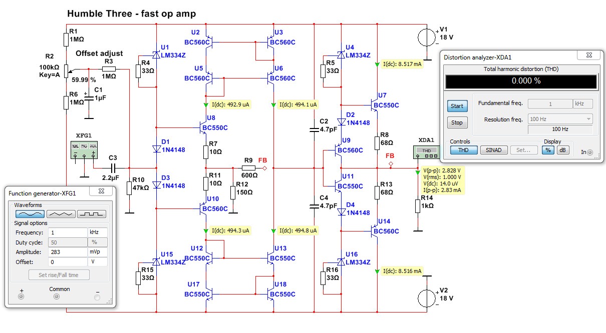

lineup Member Joined 2005 2022-06-10 7:24 pm #1 2022-06-10 7:24 pm #1 I show the simplified version to begin with. I'll be back with the real circuit after some more testings. Attachments HumbleThree-simplified.jpg 32 KB · Views: 168 lineup Member Joined 2005 2022-06-12 11:17 am #2 2022-06-12 11:17 am #2 Gain = 5. 1 Vrms into 1 kohm. Upper bandwidth ~25 MHz. Attachments HumbleThree-AD846-Clone.jpg 145.1 KB · Views: 142 AC-Analysis.jpg 181.1 KB · Views: 134 You must log in or register to reply here.
