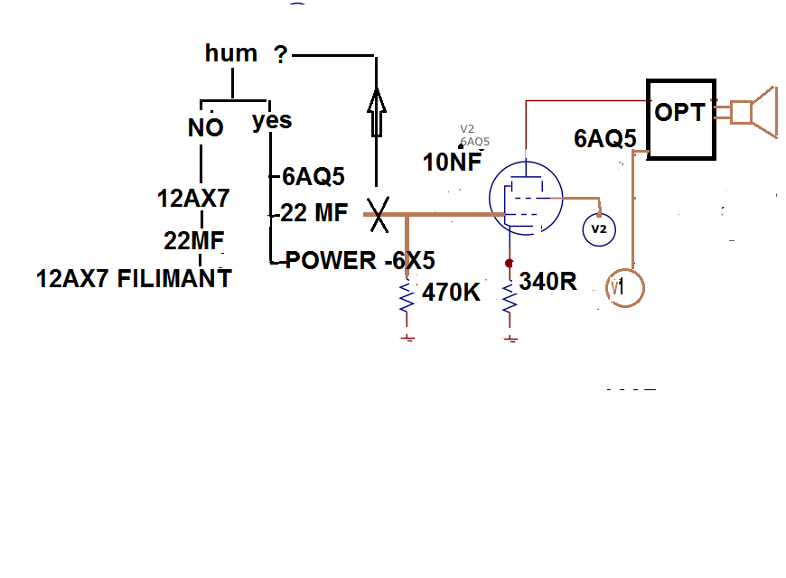

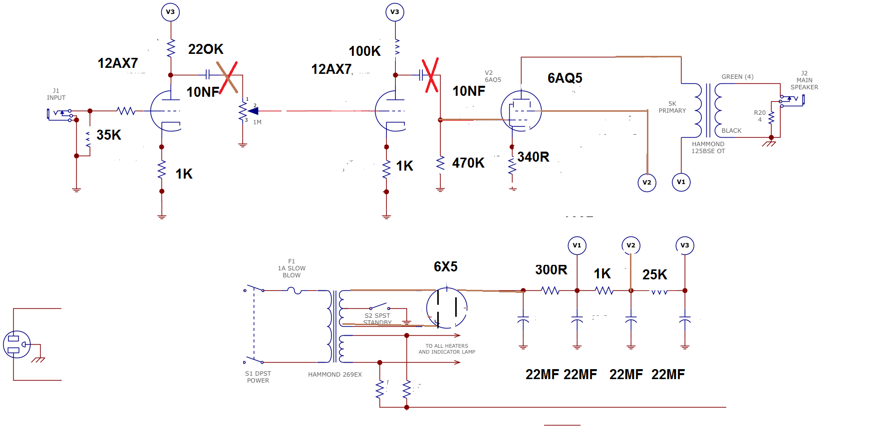

Hum
Cut the two marked points . See at which stage the ham is cut?

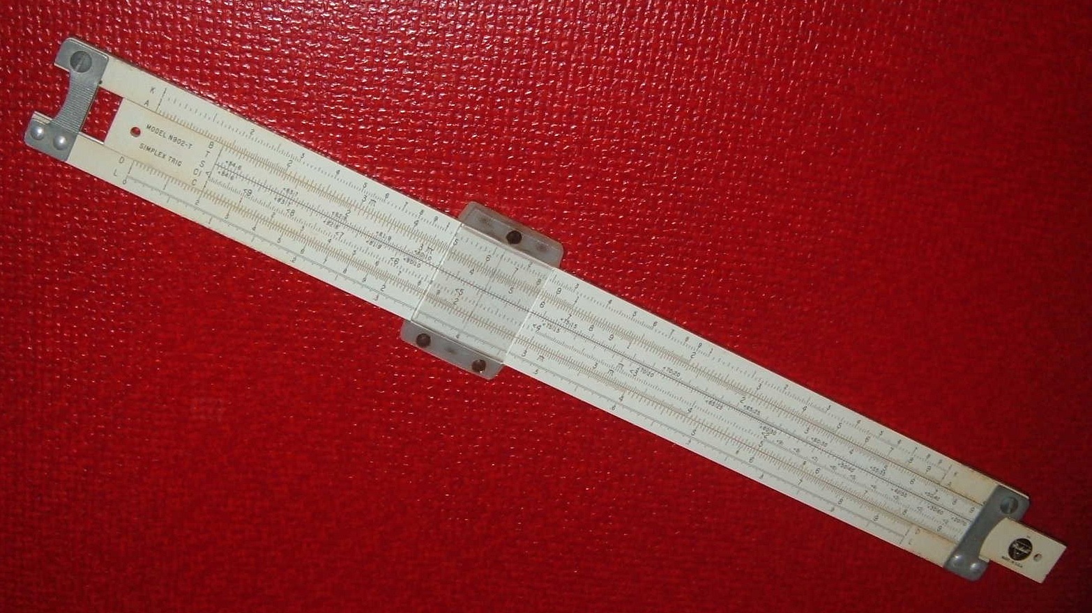

But am the only one (apart from 6A3sUMMER) using a slide rule in the very very past
I used a slip stick as I grinded my way thru the system.

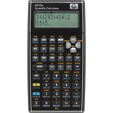

A few years ago I bought an HP 35s. The computing power is quite a bit beyond the HP 67. But the display is the sh*tz.
Both LEDs & small batteries have come a long way since Hewlett & his shirt pocket HP 35.
The 35s could have been a lot more usable with a better display.
The small collection of HP goes on, I've two 71Bs, a 75 all work on the HPIL, HP Interface Loop The commands are all in Basic.
Also a disc drive for the system, tape reader & interface board to a Windows Computer. Most not used now. The Slide Rule does
not hookup to the HPIL!😀
