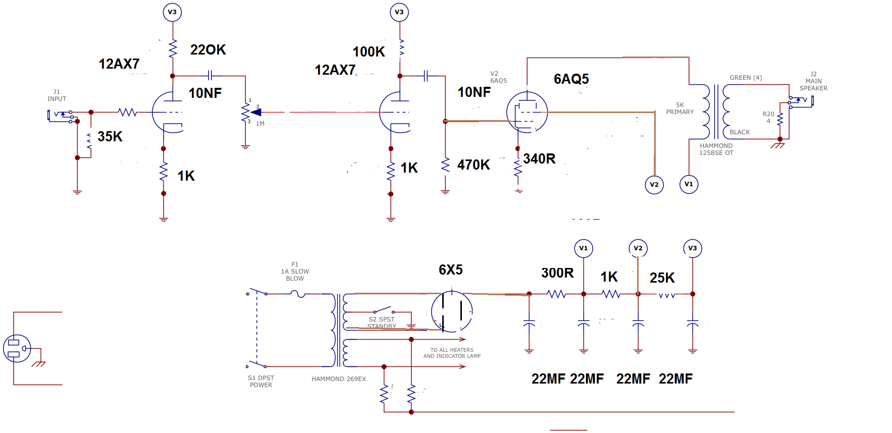

About 3 years ago I built an amp based on a Champ using parts from an old unidentified amp. It has recently developed a constant hum, regardless of the volume position. Its not really loud, but since it used to be really quiet, I want to figure out the reason. When building it, I used new good quality capacitors, but some resistors I did recycle, as well as the tubes that came with the amp. Before I open it up, I'd like to ask if there are points I should check with a volt meter to help find the reason for the noise. I've attached the schematic. Some resistor values have changed, and noted, but the updated schematics are inside the amp.

2. Note: Your attachment is Not a schematic. It Is a wiring diagram (but at least it is a Very Neat one; my compliments to you).

As Andy the Diabolical has said the first cap in the Power supply might be defective.
A quick & easy test is simply connecting a known good cap across the suspected cap with clip leads.
If the hum goes away you have identified the problem,👍

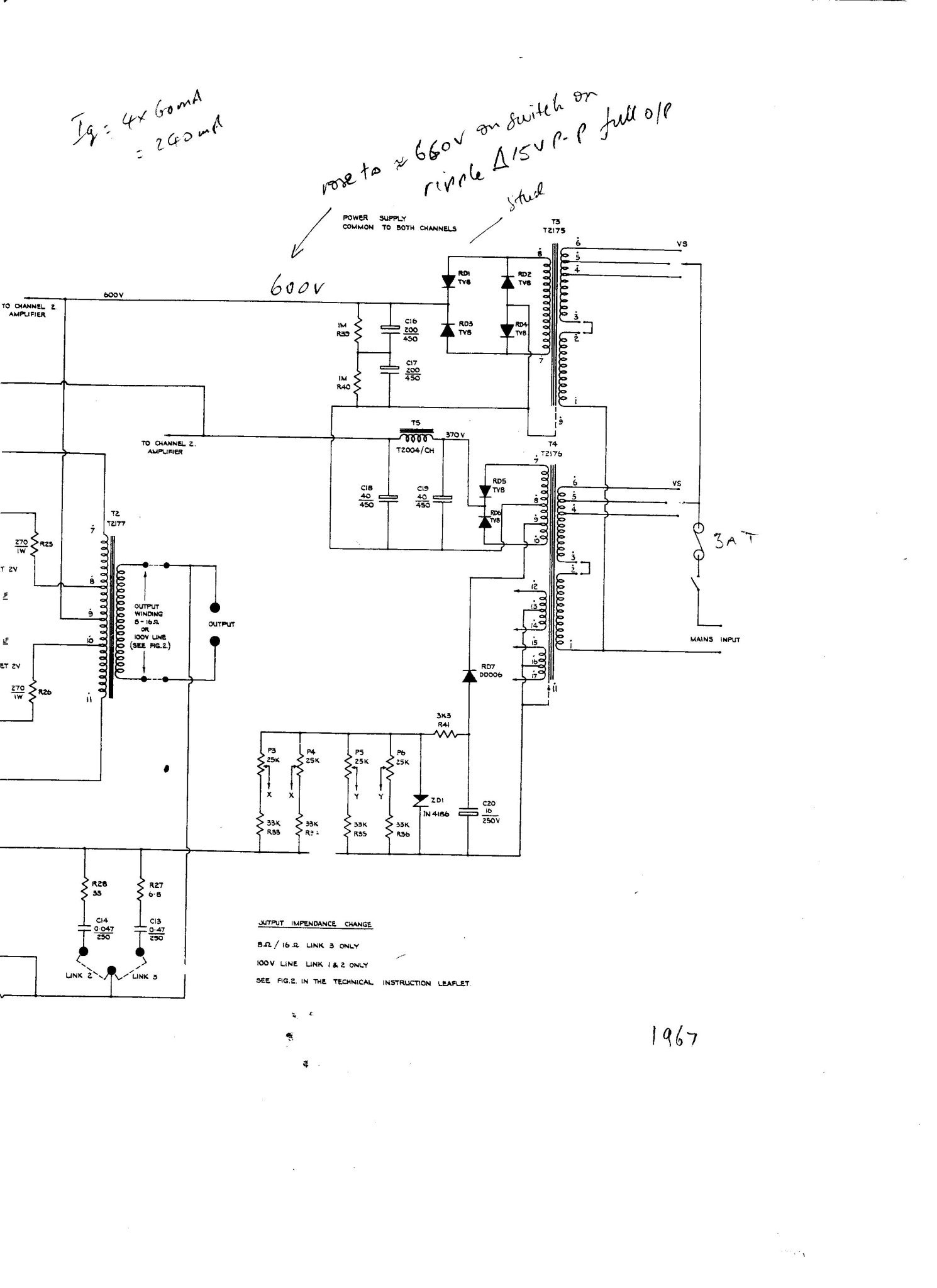

Power supply defective.....a warm reminder of the past. Some of us might remember power amp tube designs around mid 1965 were in a little flux as transistor amp types were making noises in the HiFi and general market place. The first casualty for tube amps was power supply revision. The indirect heated GZxx rects and others were often substituted with the early HV stud silicon and they failed, often taking out the short life smoothing caps. See enclosed circuit example in prolific use around 1967. I dread what computer simulation would declare. Having repaired one of these amps rated at 100W+100W fitted with KT88´s, the switch on power surge tripped my switchboard fuse. One got around that problem by running the amp from a long lossy extension lead and have spare fuses. Hardy an amicable solution.
However, directly related;
Another post mentioned cathode stripping; yes, the enclosed circuit would be nasty with DHT tubes, but notice 650V on switch on, falling to 600V on load, a nice reception for whatever cathode indirectly heated or not. My AC mains varies from 225 to 240V so more surge problems appearing. What a dreadful way of doing things, but who cared those days, it was only sales.
The designer of this amp quoted a tube life of 10 years (phew!) with MOV tubes at an undefined duty cycle. At that period the hard glass CRT B/W 405 line TV set was lucky to function anywhere half that time without being clouted.
Any method of reducing all this brutality on running tubes in our late days is worth every grain. Soft start, whatever configuration, do it.
