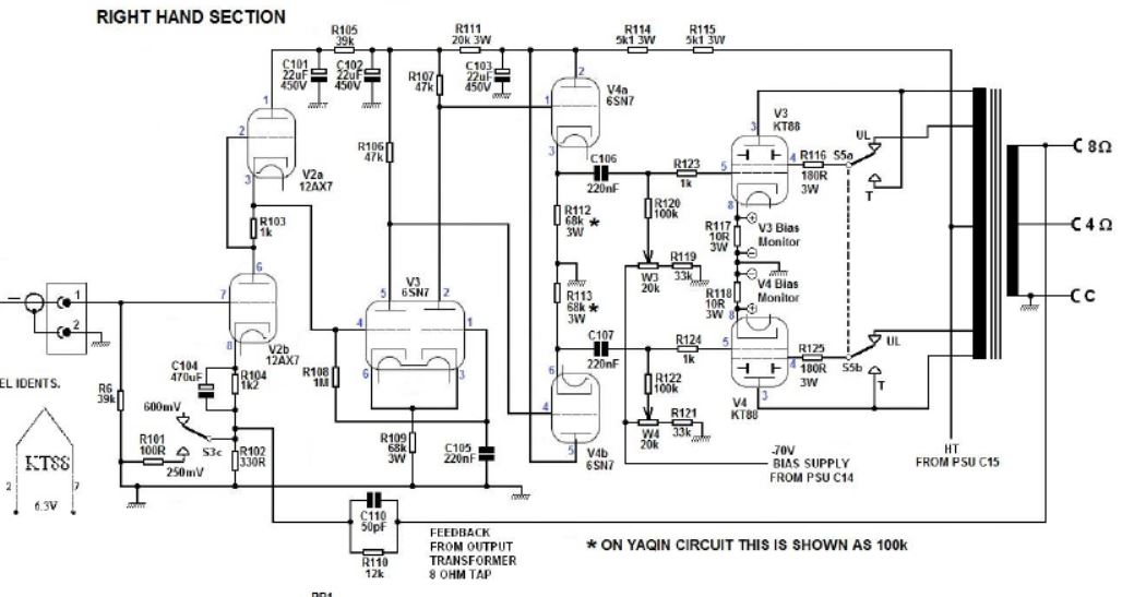

Does anyone have integrated tube amp that encounters with hum or bug sound? At 1/3 volume, it's great but when I turn the volume to 1/2, I can hear hum on both speakers. So my best way is to hook up with another preamp to use the volume while setting the tube volume at 1/3. What other options to fix it?
If the hum is max when vol pot is in the middle position and the pot is high value above 100k a quick and dirty solution is to fit a 47k resistor across the pot

I tried only 1/2 because the hum is louder so I didn't go for max. There is no hum at 1/3.
If the hum suddenly starts at a certain point in the volume control, there could be
a physical problem in the control, perhaps related to the loudness tap.

I can't see a volume control on the Yaquin schematic you posted...am I missing something or did you add a volume control?
How much hum, ______ mV?
What frequency? Hum, 1x and 2x the power line frequency? Oscillation? Motor boating? Noise? What kind of "Hum"? It is interesting that the hum is in both the woofer and the tweeter.
Did you disturb the wiring position when you replaced parts? Did you change where the ground of the pot connected to? Did you change any other parts, transformers, feedback parts, or tubes?
There are 3 DC coupled gain stages. There is lots of gain in the amp, and it has global negative feedback. It might be on the margin of unstable.
Nothing change except the pot and caps.
All hookup wires are the same, except swap between the tube and SS amp.
No, I removed the pot then put back to the same location
I did change all the upgrade tubes but swapped back to test again and got the same problem. All the original tubes have label from V1 to V5 so I put in all the same location. Even I tried the swap the upgrade tubes around still not help.
Both UL and TM are the same problem when turn the volume to 1/2, otherwise no hum between 0-1/3. When turn between 1/3 to 1.2, the hum keeps louder, can be heard at 6 feet away.

'Upgrading' coupling caps sometimes means swapping physically small caps for physically large caps (e.g. polypropylene). In some cases this can cause direct hum pickup, or instability via capacitive feedback. Try putting the old caps back and see if that solves the problem. Another thing to try is adding a grid stopper resistor to the first triode. The symptoms you describe could be caused by parasitic oscillation, or just old-fashioned lack of shielding on wires.
The 'Input switch' actually selects between two 'amounts' of Negative Feedback by changing the resistance to ground for the NFB.Is there a problem with both positions of the Negative Feedback Switch?
