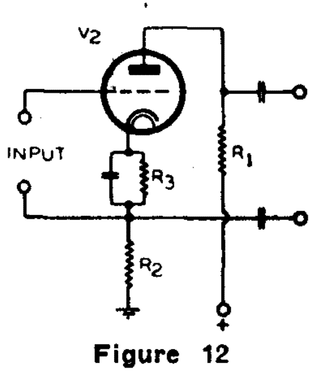

Vcelkamaja, I was doing some late night reading and stumbled across something that might interest you. I have a hard-copy of the Radiotron Designers Handbook, 3rd Edition (sadly, not the legendary 4th edition...), and on page 11 the author mentions a hum problem very similar to the one you experienced.
The circuit is a simple phase splitter. Since R1 and R2 are approximately the same value the triode V2 cathode is at a relatively high voltage with respect to ground. The high cathode voltage is exactly the condition that the upper triode in your amplifier SRPP stack has - which is why I found this to be applicable to your situation.
The author states that "... hum may be troublesome. Part of the hum is due to the considerable difference of potential (voltage) between the heater and cathode V2. This (the hum) may be reduced by operating the heater of V2 ... connected to a suitable point in the circuit which is at an average potential (voltage) approximating to that of the cathode. "
In plain (i.e. - American :)) English, the author is suggesting to bias the heater up closer to the cathode to reduce hum. By putting in your bias network to raise the heater voltage closer to the cathode potential, you have implemented exactly this correction!
This is one of those rather "not-obvious" conditions that can cause trouble in these tube circuits. I am particularly surprised that the kit-design did not take this into consideration - the design itself should have relieved you of the trouble of this type of troubleshooting. This is more a case of what you might encounter when designing your own amplifier - unintended consequences and all that.
Well, at least it has been a very good learning experience! I have certainly learned a lot, watching over your shoulder! And I'm certain others who read in here might pick up something new, too - it's just too bad the original design didn't allow you to build your amp and start enjoying it right away!
But I believe that once you have solved the remaining issue, your amplifier will sound all the sweeter as you enjoy something that you not only built but worked on to get it to operate properly. Much more enjoyable (in the end, anyway :)) than just putting a bunch of parts on a circuit board and turning it on :D
If you would like to read a bit more on the technical theory of tube amplifiers, there are several mirror sites that have PDF versions of the Radiotron Handbook - one of them is here: Tube Amp Schematics, Tube Amp Information, Tube Amp Projects
The reading can be pretty heavy, but it does start from pretty basic ideas and has interesting little connections like this one. There are other books that might be better for learning tube theory, but once the theory starts to make sense this book is loaded with information that turns up in surprising places!
Best luck to you, I hope you have your amplifier playing beautiful music in the near future!

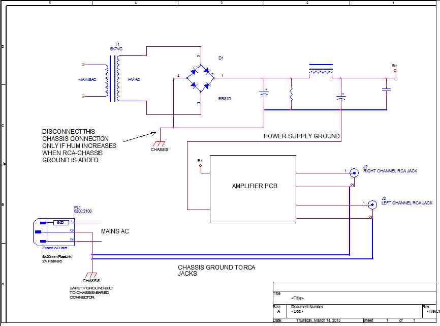

OH - that puts the problem in a new light...
If I understand correctly, the amplifier is quiet (no hum) with the RCA / Twisted-pair connected to the PCB but with no external cable (to your source) connected to the RCA jacks.
If this is true, it sounds like you have a ground-loop in your system and not in your amplifier.
I think the solution to that is to take your RCA negative side (shield) back to your chassis-ground with another wire. That is, run the twisted-pair to your PCB just as you have it now, and run another wire back from the RCA minus to your chassis-ground.T his wire should not run to your star-ground - take it to chassis (safety) ground back at the IEC connector safety-ground connection to your chassis.
This may set up a ground loop inside your amplifier - but it provides a drain for the external cable.
If the hum gets worse with the new ground-wire, then you may need to lift your amplifier circuit connection between star-ground and chassis to break the internal loop. Your amplifier will then go to safety (chassis) ground only through the RCA-Chassis connection.
The star-ground still keeps your power-supply noise under control and keeps the rectifier ripple out of your sensitive input connection. Running chassis ground to your RCA connectors should not carry any power supply current - and thus should not pull power supply noise into your input section.
You may get an acceptable reduction in noise by simply grounding the RCA connector to chassis directly at the RCA connector - but doing so will cause the external power line noise to take an unknown path through your chassis back to safety-ground. Better to manage the path with a wire, I think. better yet, use two separate wires to chassis ground, one for each channel.
The capacitor from RCA negative to chassis was too small to take 50-60Hz noise to ground - it was still riding on your twisted-wire inputs. That is why it had no effect.
Hope this helps.
~ Sam

A picture is worth a thousand words...
Here is what I was suggesting.
You may or may not need to break the chassis-connection back at the star-ground (where all of the power supply returns come together).
The RCA-chassis ground keeps the ground loop currents (from the external source) from crawling through your amplifier PCB to get back to chassis.
~ Sam

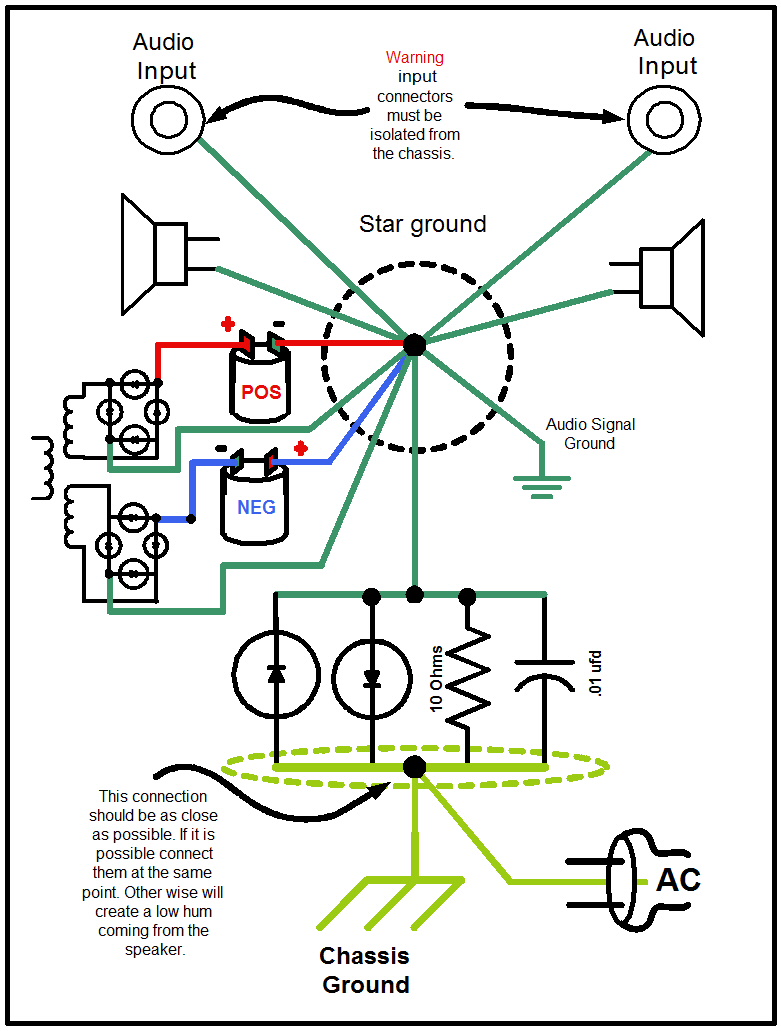

Also you can try the back to back diode to connect the PS ground to hearth ground. It worked for me.
Attached it is a drawing of the start ground showing how to connect the two back to back diode.
Excellent diagram, Tauro. I am just starting a buildup, trying to get my grounding scheme in order. This is good information, another one for the "bag of tricks". Very concise diagram, well done! (although I shouldn't want to connect my PS outputs to ground! :no: )
Just be sure that you use diodes (or a rectifier bridge) that can carry significantly more current than any circuit breaker or fuse that it is likely to be powered through. In a fault condition, if the diodes fail before the building's circuit breaker or fuse does, then you could have an ongoing high risk of electrocution.
And the connections for all of the components in that network should not be connected with solder, since it could melt and disconnect before a circuit breaker or fuse could trip or blow. Bolts or brazing (welding) should be safe-enough.
