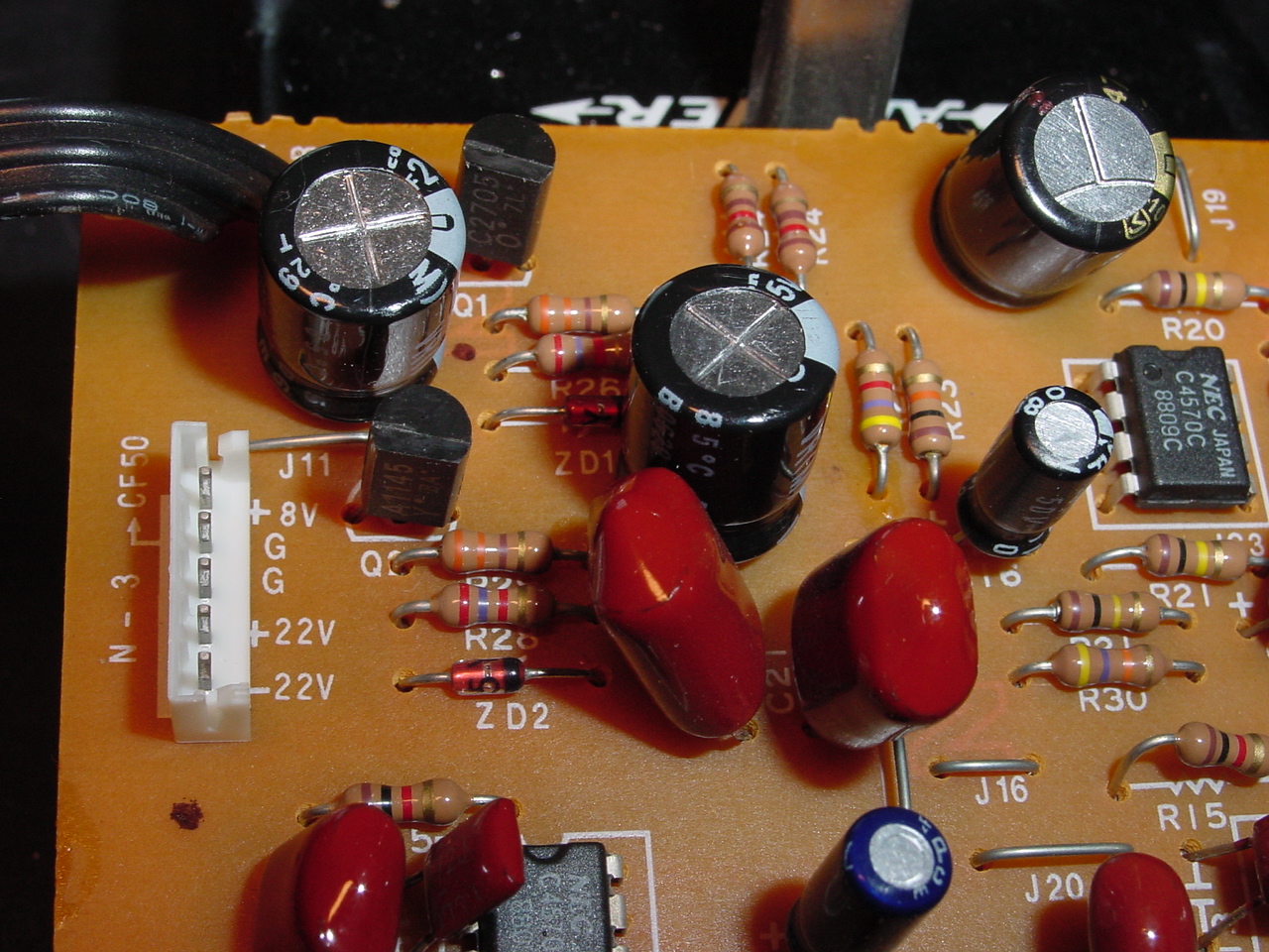

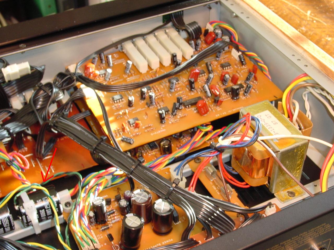

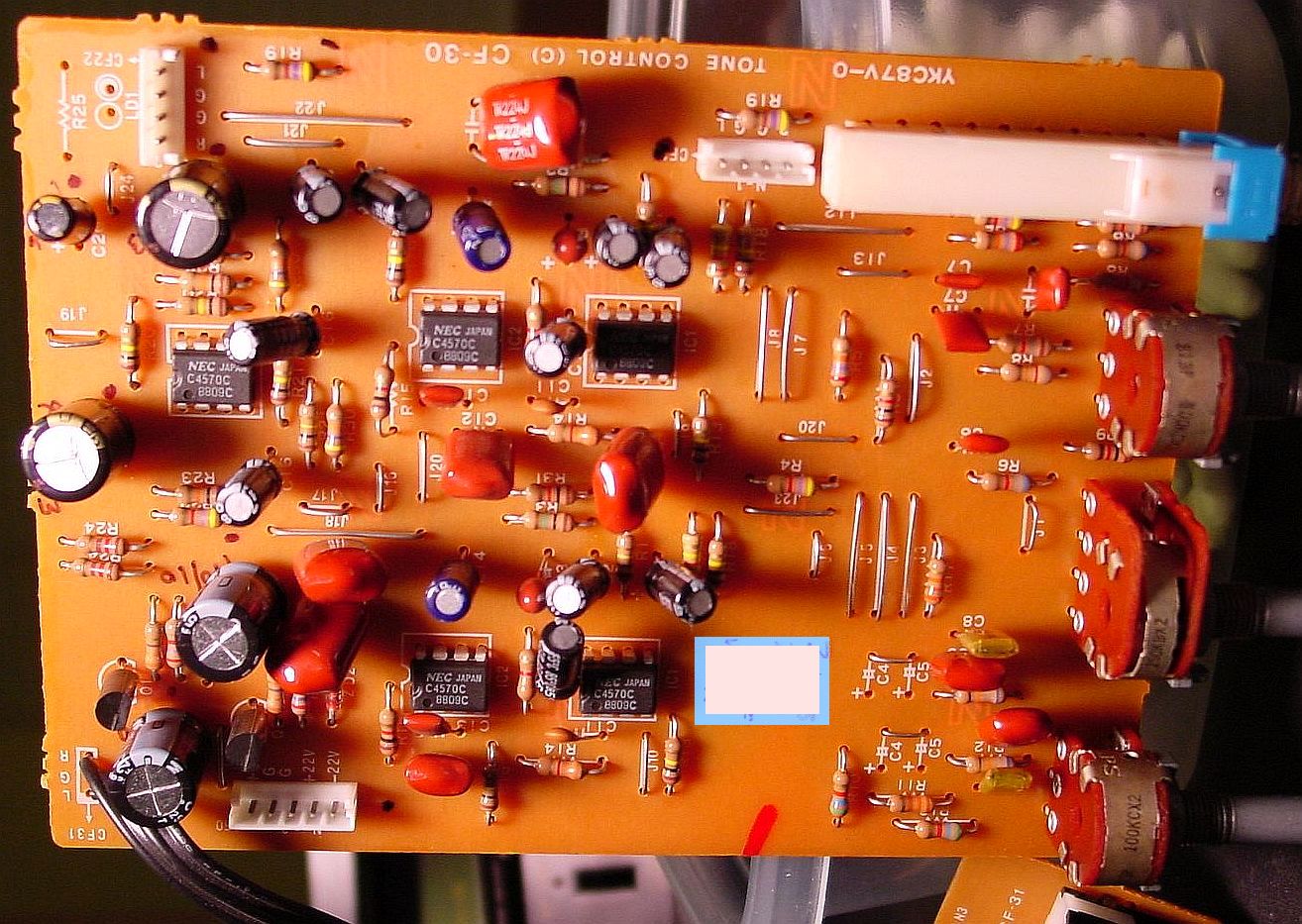

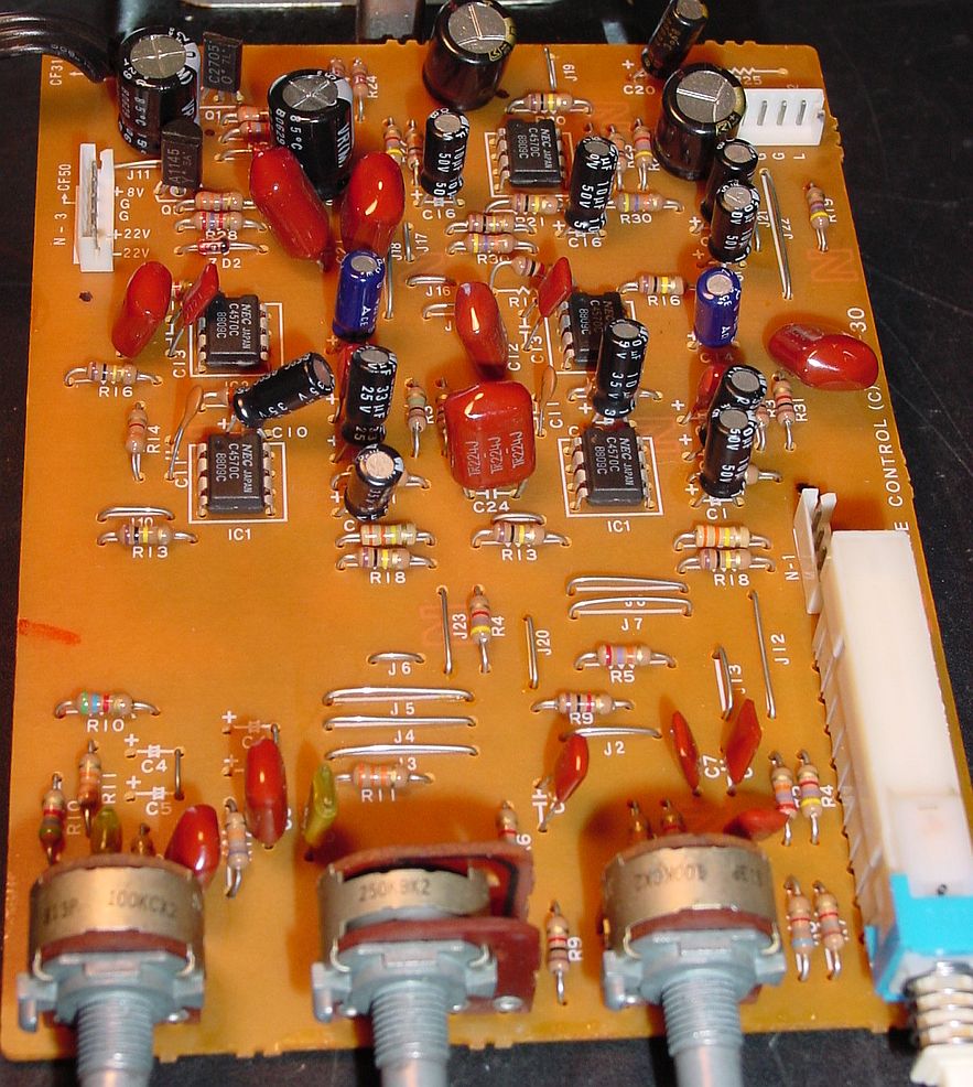

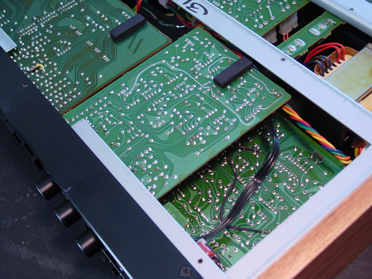

Here are some pictures. The board sits bottom left corner as the unit faces you. The only thing under it is the metal cover. The braided color wires are the power supplies.
There are two transistors on the board too, they are audio type 2SA1145Y and 2SC2705O. The regulation seems accomplished by two Zener diodes near the power entry connector. The other semiconductors on the board are the 5 NEC 4570C ICs.
I am supposing that one of the above semiconductors could be the problem, I could not readily see a ground loop potential, but who knows.
What would you all try first?

You really need to scope it. Can you determine the nature of the hum. Is it a very deep pure line frequency or is there any harshness to it (harmonics( which may give a clue as to where it comes from. Pure line and it's probably pickup. If it's twice line and harsh then it's possible it's PSU or ground related.

Is the amp sat on top of anything that has a transformer in it ?
Have you tried unscrewing and rotating and moving the mains tranny to see if it affects it at all.
You mention altering the caps lowered the hum albeit slightly... I would not expect any audible difference tbh with regulated supplies. Just confirm the supplies on the opamp supply pins are OK. As mentioned by others the reg for the board is by two zeners and transistors where the 22v enters. Check the voltage over each zener and make sure that less aroun 0.6v appears across the supply pins of opamps assuming they are configured as simple series pass regs.
I bet that PCB would run ok off two 9 volt batteries in series (centre to ground) if you isolated the incoming 22v. That would prove if supply problem to board in absence of scope.
