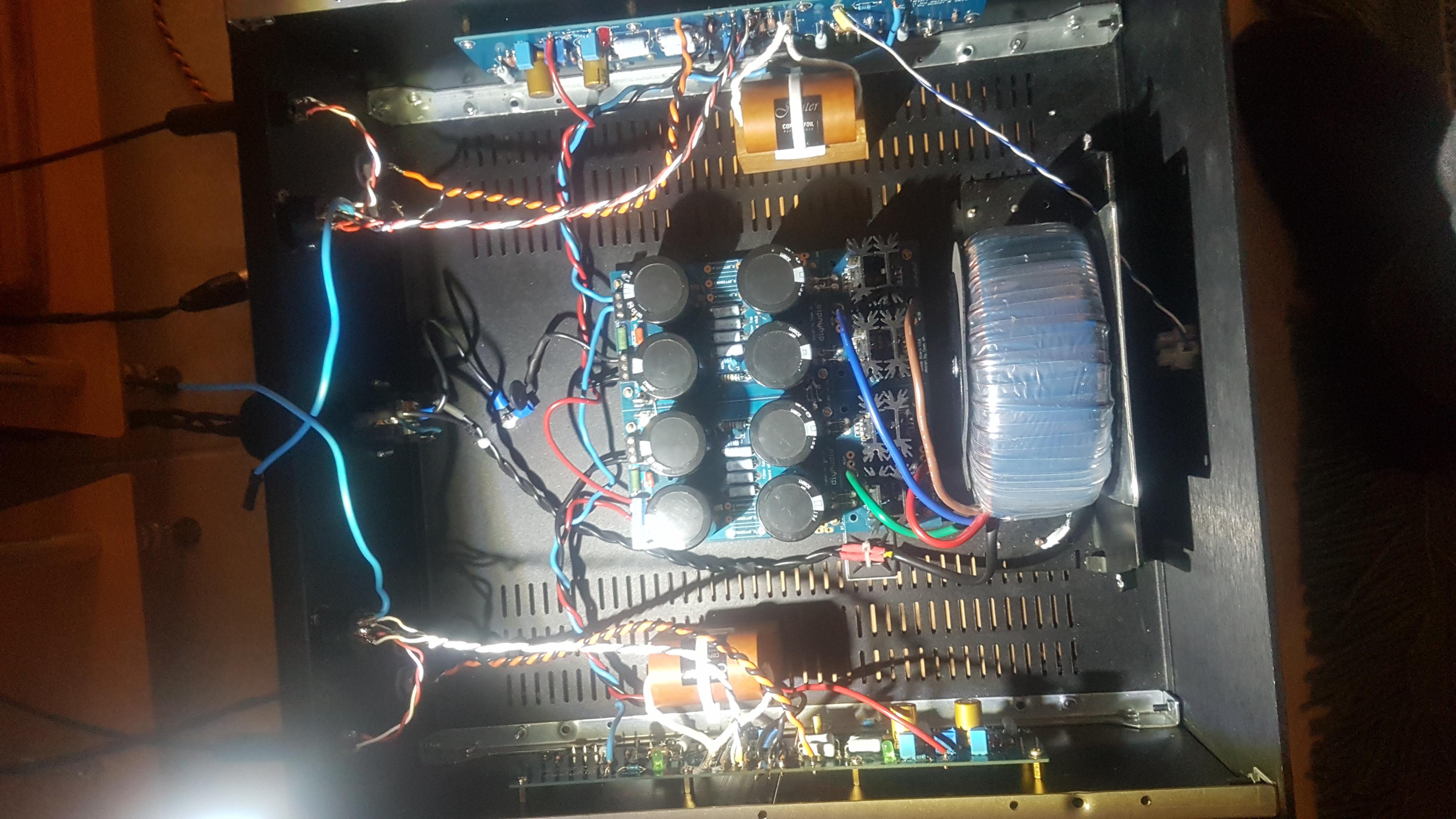

Hi, I have connected ground and plus to rca
The blue wires is ground wire for experimentation.
If I use the blue wire for ground instead of ground to the cards on each side it's less hum. You can see a thermistor between chassis ground and power connection ground. The best solution is If I remove ground to each cards on the sides and connect one of the blue wire to chassisground and the other one to powersuply ground. Then it will be quit in one chanal and a litle bit hum in the other one.

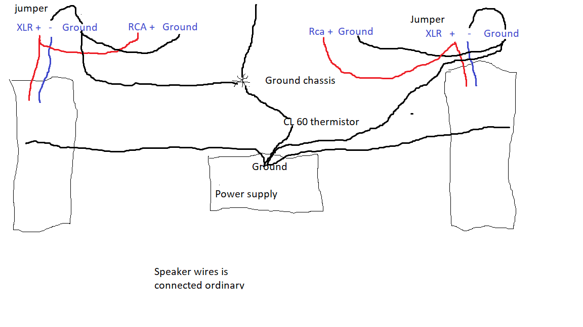

I'm still working with the ground in Aleph J to keep it quiet. With XLR it's completely quiet, but with RCA it's noisy.
If I connect as shown in the picture, it will also be quiet when using RCA. I then connect ground from one XLR to chassis ground and from the other XLR to ground in the power supply. It's a CL60 thermistor between these ground points.
Are there any disadvantages to grounding this way?
