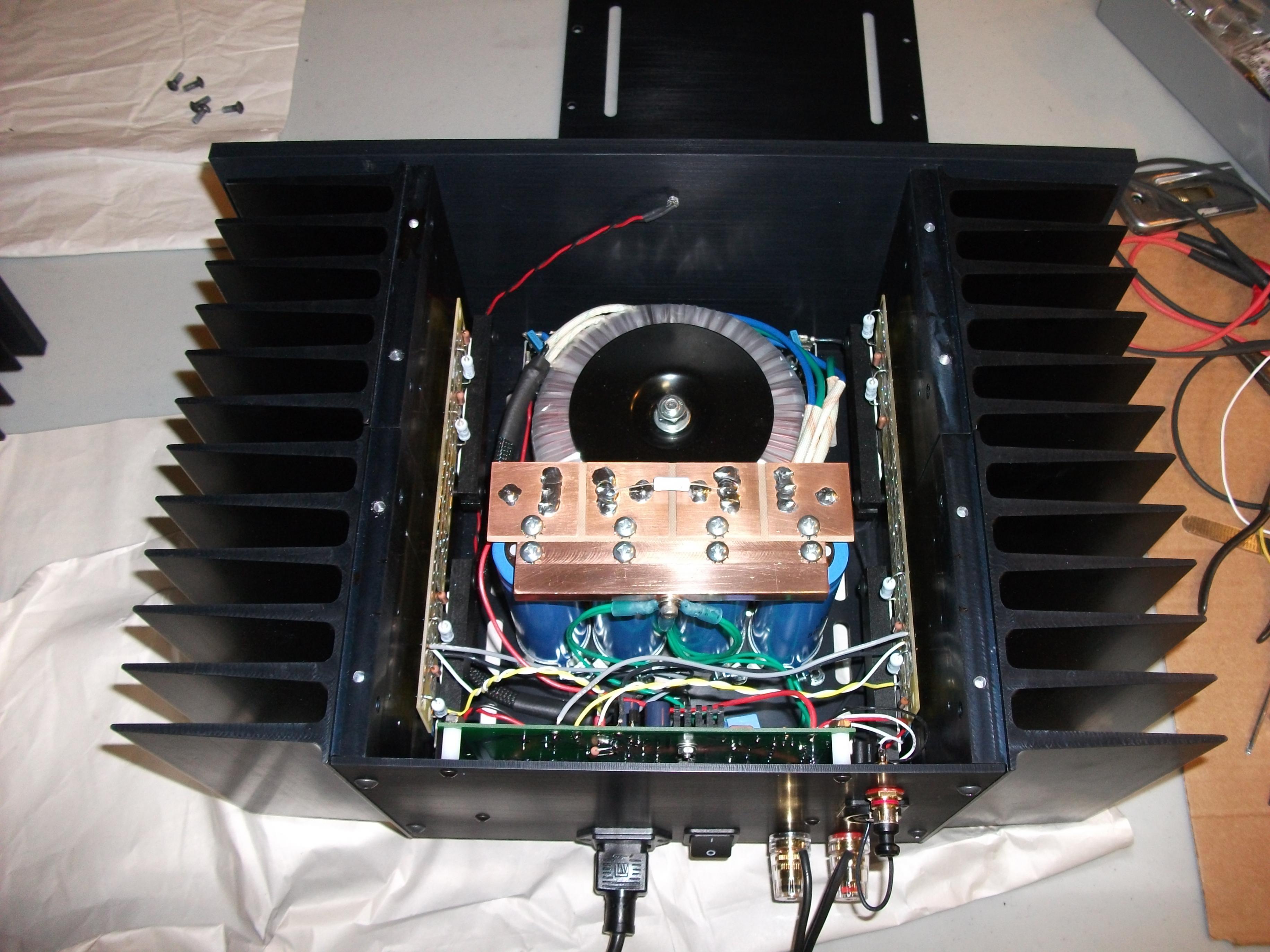

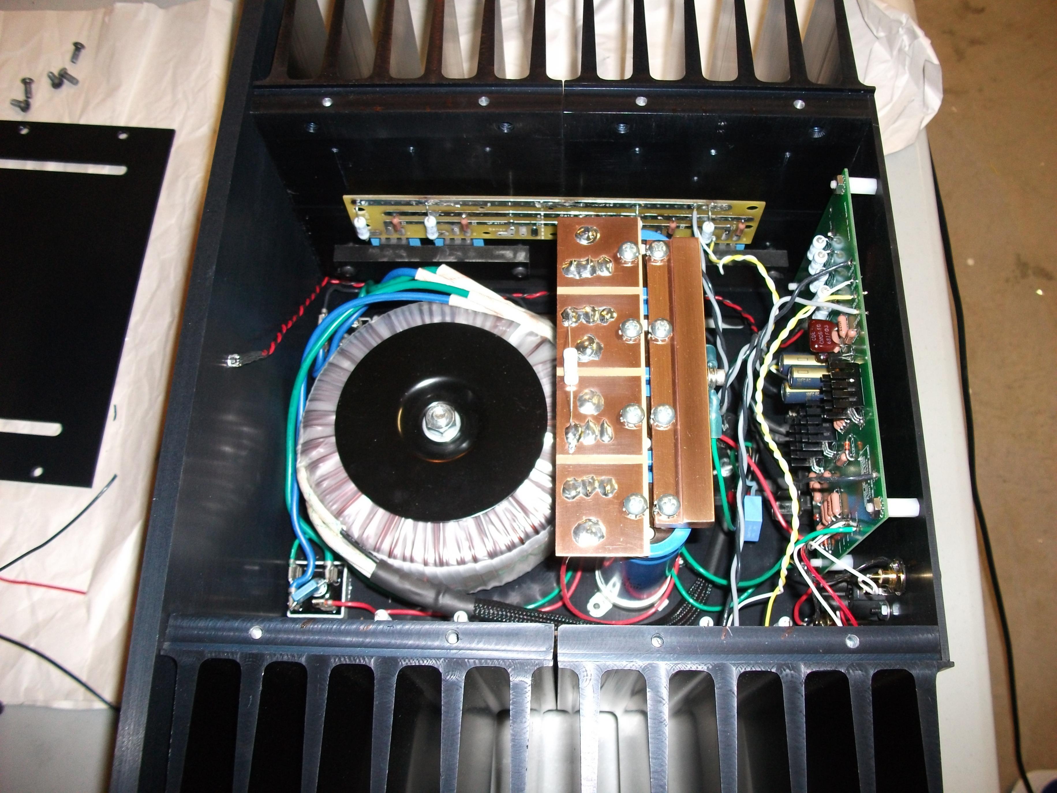

Sorry I'll link to the pics in my other thread. Both amplifiers are shown in these pics. The one with the twisted gray/black pairs at the back is of course the noisy one.

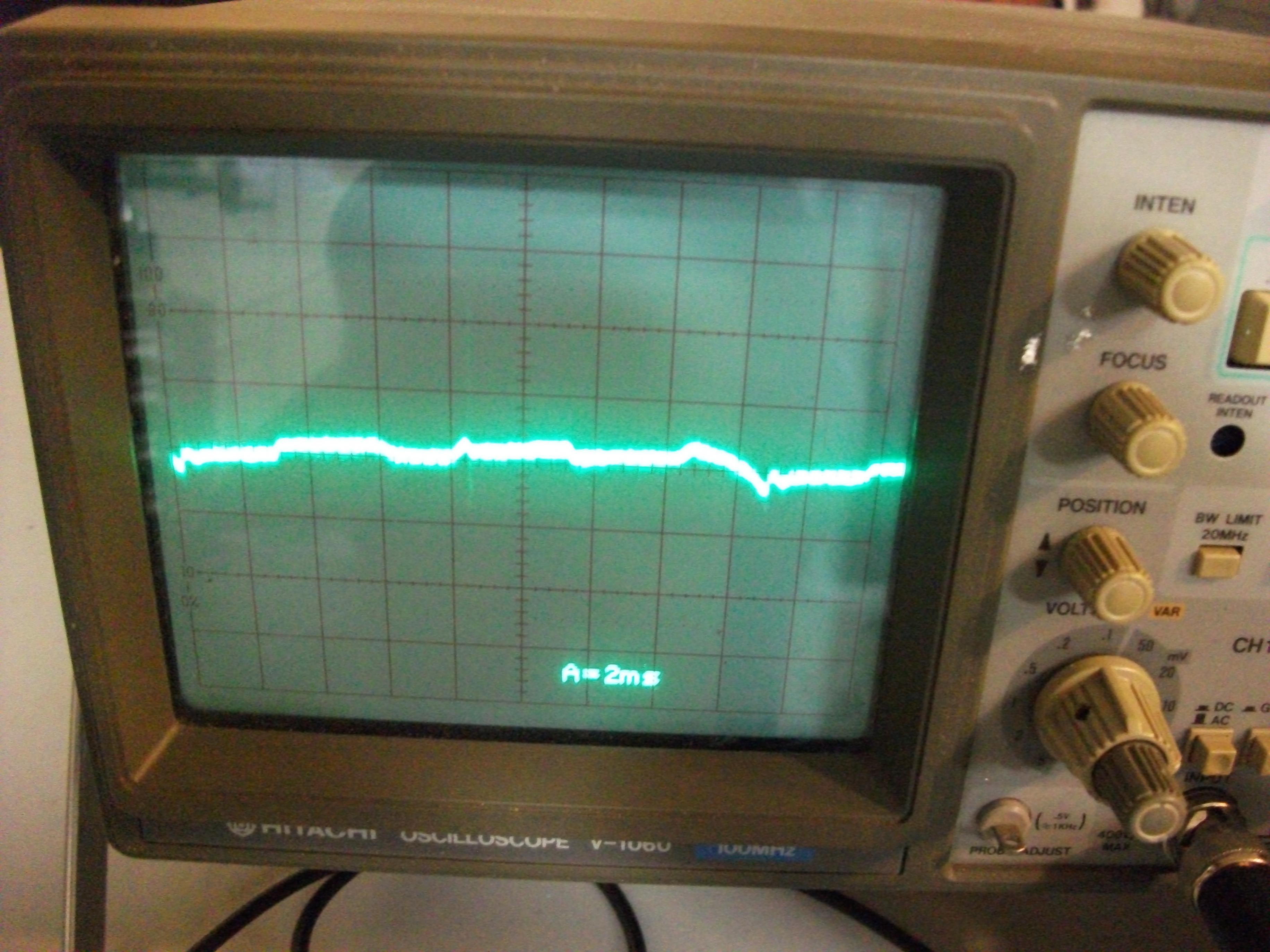

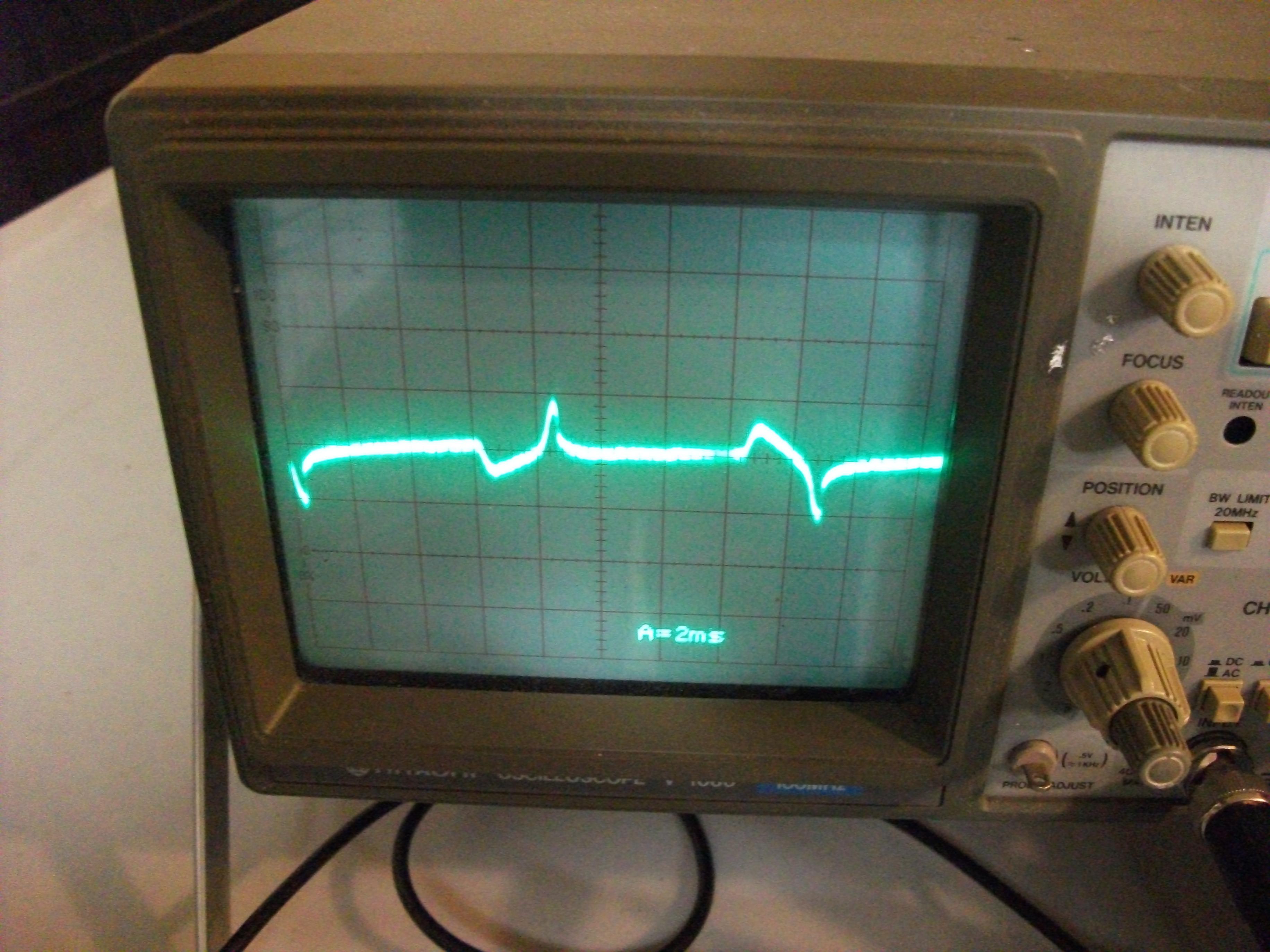

Here are a couple of pictures of the scope trace from the amp with the hum. 10 mv per division setting.
The noisier trace is with the RCA shorting plug installed, the quieter of the two traces is with the RCA plug removed. This seems backwards of what I would have expected.
