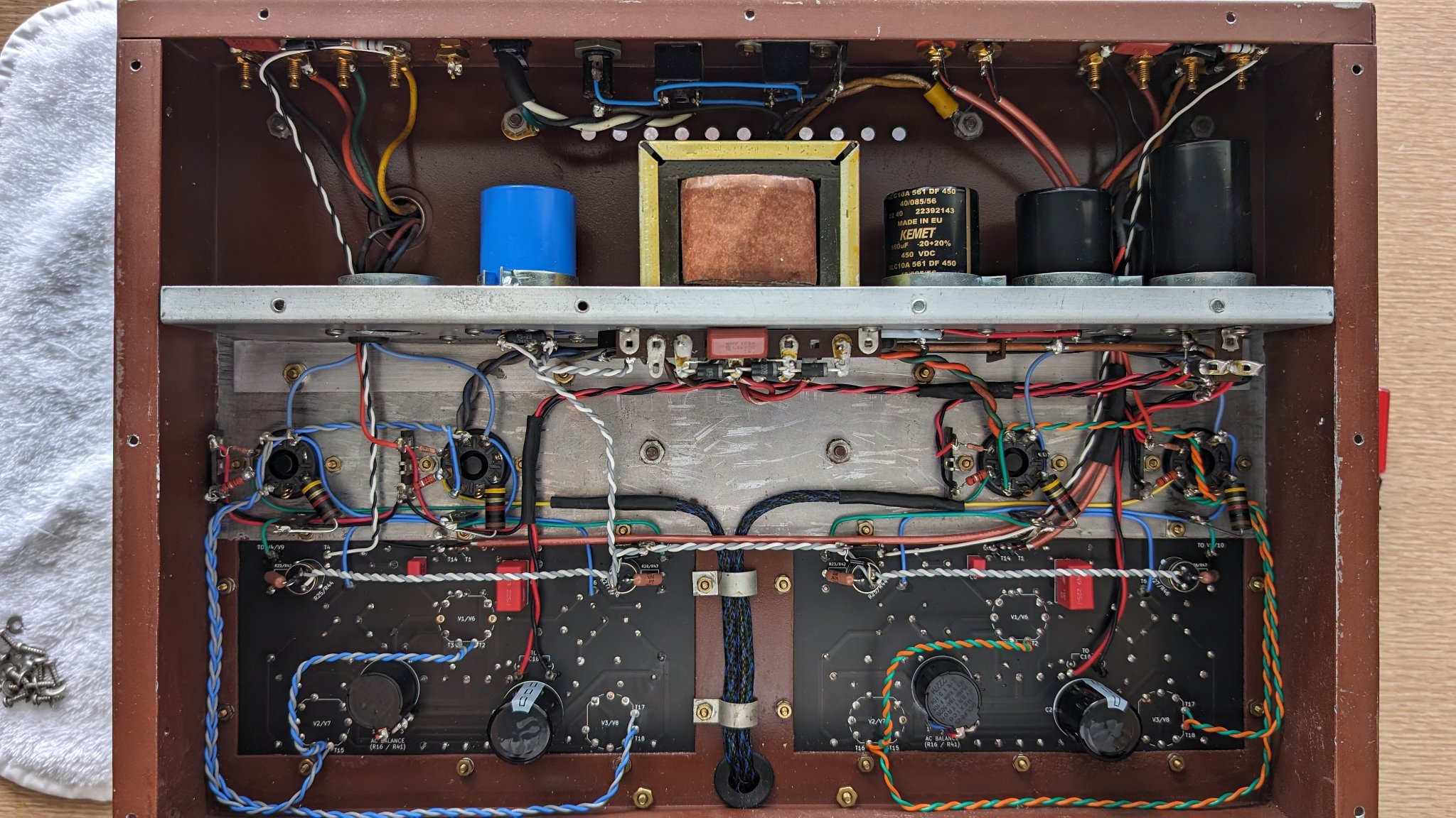

I rebuilt a vintage amp and noticed that while its noise performance is good, one channel has significantly more residual hum than the other.
With the two channels' inputs grounded:
Channel A @ speaker terminals: 1.22mv RMS (60hz) = -87dB vs full power
Channel B @ speaker terminals: 0.399mv RMS (60hz) = -98dB vs full power

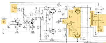

So I began comparing the two channels using my PicoScope's spectrum analyzer to see where along the audio chain the two channels' performance diverged. I found that the problem starts at the anodes of V4 and V5. There is no sign of it beforehand. If anything, the bad channel's hum performance is slightly better than the other channel's until the anodes of V4 and V5. Here's what I found at the anodes:
Channel A 60Hz hum: -35.8 /-38.5 dBv (V4 / V5 @ pin 3)
Channel B 60Hzhum: -52.1 /-51.2 dBv (V9 / V10 @ pin 3)
Pretty huge difference.
I triple checked, and no difference in hum between the channels shows up at the grids, screens, or cathodes of the power tubes, nor at the B+ center tap of the output transformer. And again, at the grids of the power tubes, Channel A's hum is actually slightly lower than Channel B's.
I thought maybe my power tubes were the issue. So I swapped the power tubes between the channels, re-biased, and tested. Exact same result.
I've jiggled and moved the OPT leads. No change.
I jiggled and moved the filament wiring. No change. And surely if they were the source, the hum would appear elsewhere in the output stage. But it only appears from the anodes and forward to the speaker terminals.
edit
With the power tubes removed, the hum remains unchange
Thoughts??
The channel in question is at the left side of the attached pic. Is the hum maybe coming from the speaker terminals' proximity to the mains power? Perhaps coupling between the output transformer and power transformer?

I didn't mention in the original post, but I have channel-swapped the preamp and driver tubes as well. Hum is unchanged.What amp is it if you don't mind me asking?
jeffI would swap driver tubes too. Just in case it is a cathode insulation problem.
I hadn't thought of that. I'll give it a shot. I'm sure everything can handle the boosted voltage for the few seconds it would take to test it.Also if you leave the power tubes out, could you measure noise? Could be a transformer coupling problem though also could be input stage coupling on one side too.
vinylkid58 said:What amp is it if you don't mind me asking?
jeff
It's a Lafayette KT-550
The hum is unchanged without the power tubes.
Hearinspace said:Why is the capacitor clamp at top left empty?
It's not needed. I made new PCBs for the amp that allowed me to, among other things, move the decoupling caps from the PSU bracket to the PCB.
Did you have a chance to measure hum before the rebuild? Just wondering if something in layout changes could have anything to do with it. Maybe retracing those steps?
Just talking in hopes of nudging your insight.
Nice looking boards and rebuild BTW. far cleaner than the original for sure.
