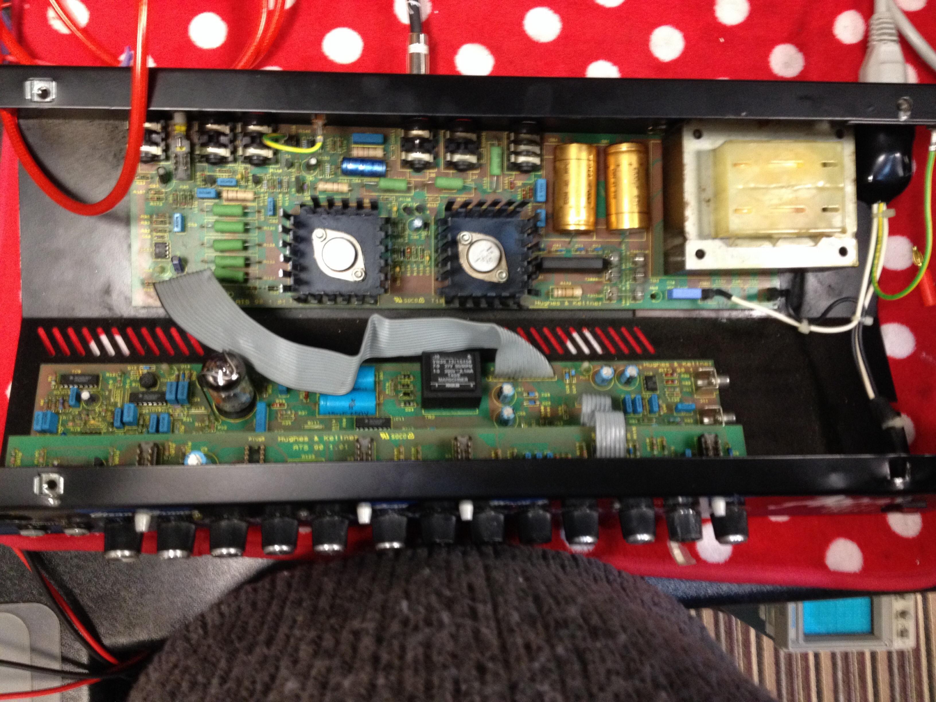

Hi everyone,
I've received a Hughes and Keittner Attax 100 guitar amp that is blowing 2A fuse when the speaker or 8ohm load connected.
I powered up the amp on my work bench with an isolation transformer and variac with a 100watt lamp in series as a current limiter. On first power up the lamp lit bright. I removed the power and checked around the power board testing resistor values, checking diodes, and checking caps for ESR and values. Some caps are away off value but esr are ok.
There is no short at the speaker out connection when powered off.
I have not removed the MJ4035 and MJ4032 transistors from the board yet to test as I thought I would seek some advice before disturbing anything.
I would be greatful if someone out there could lend me a hand to repair this amp.
I have attached some pictures
Many thanks
Paul

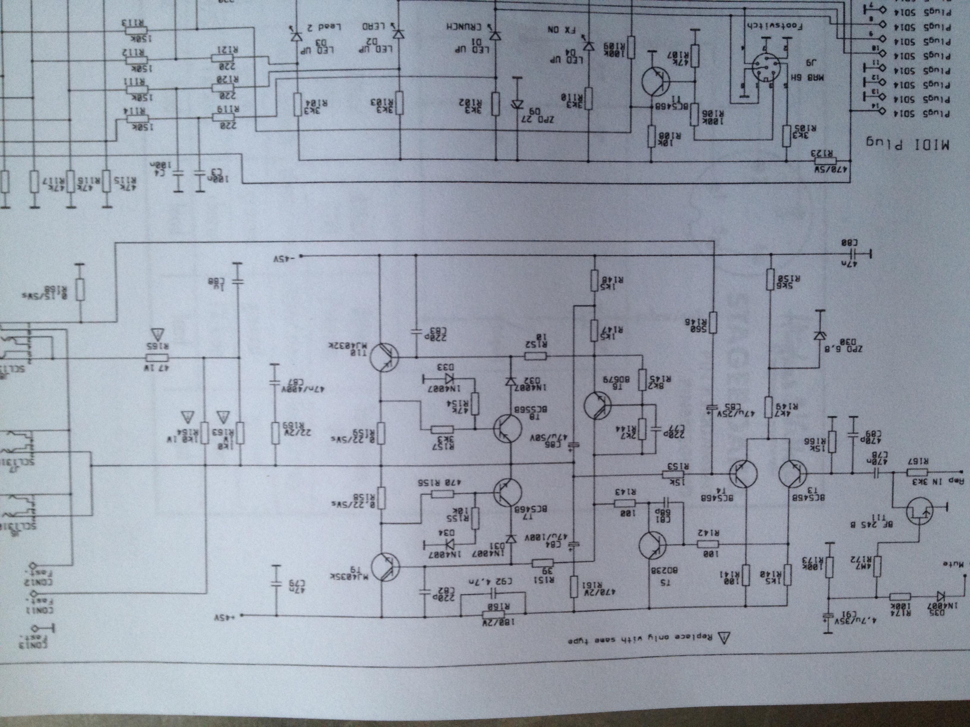

Try to get the schematic and post or link it here so we all talk same part numbers.
Or straight ask it from H&K .
Maybe they don't want it on the Net, but you might scan and crop just the relevant part, say the power amp without preamps, supply, effects or switching, and that would qualify as "fair use", in this case getting help from fellow Techs for a real needed repair.

I have attached a schematic of the Attax 100 power amp section.

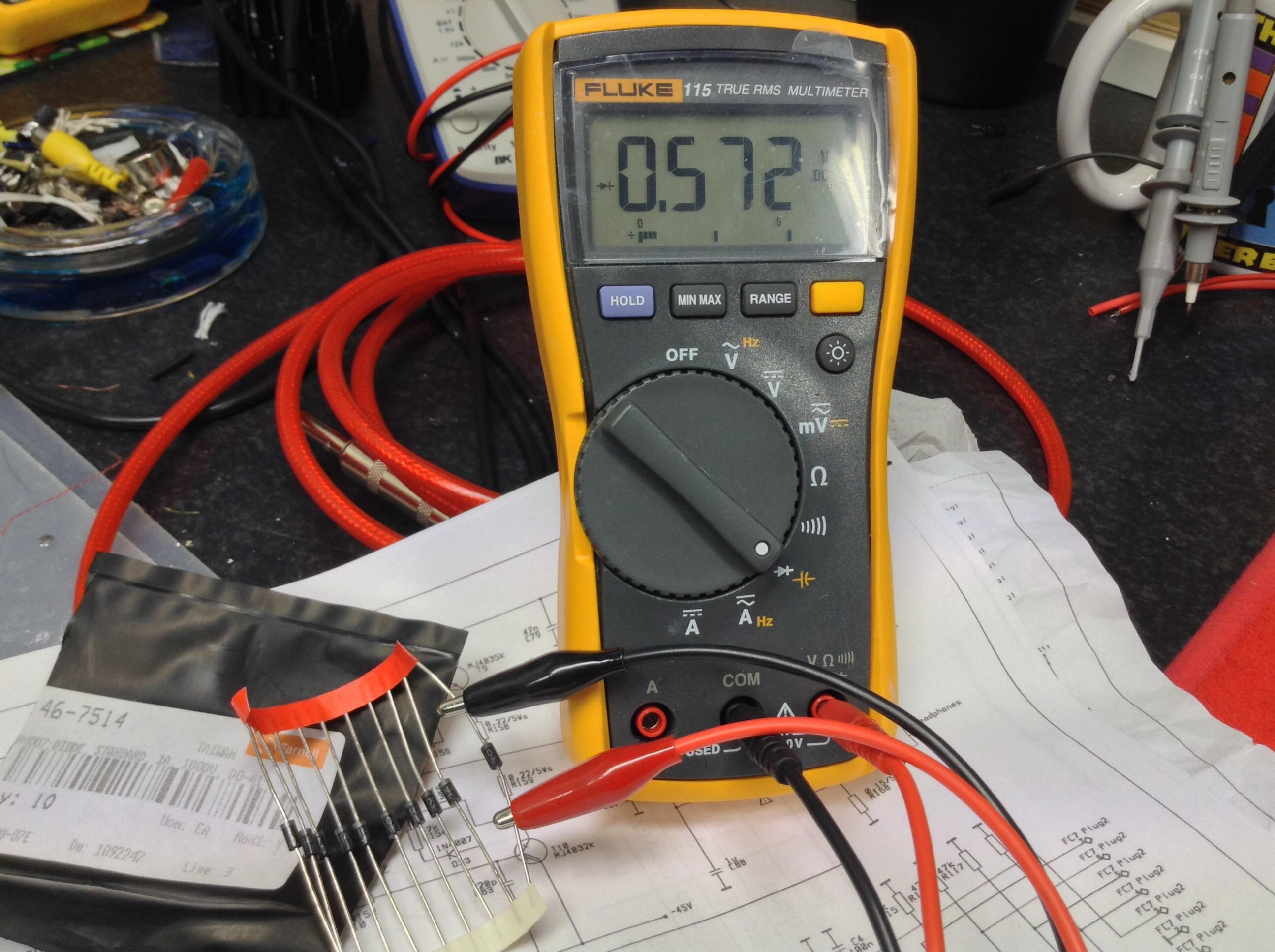

Just to be certain we are talking the same, please also measure both ways and post results found when testing a generic diode (a 1N400x type will be fine).

Using the diode test scale I've tested a regular N4007 diode.
Forward bias test - red probe to cathode, black prob to anode = 0.568v
reverse bias test - red probe to anode, black to cathode Open.

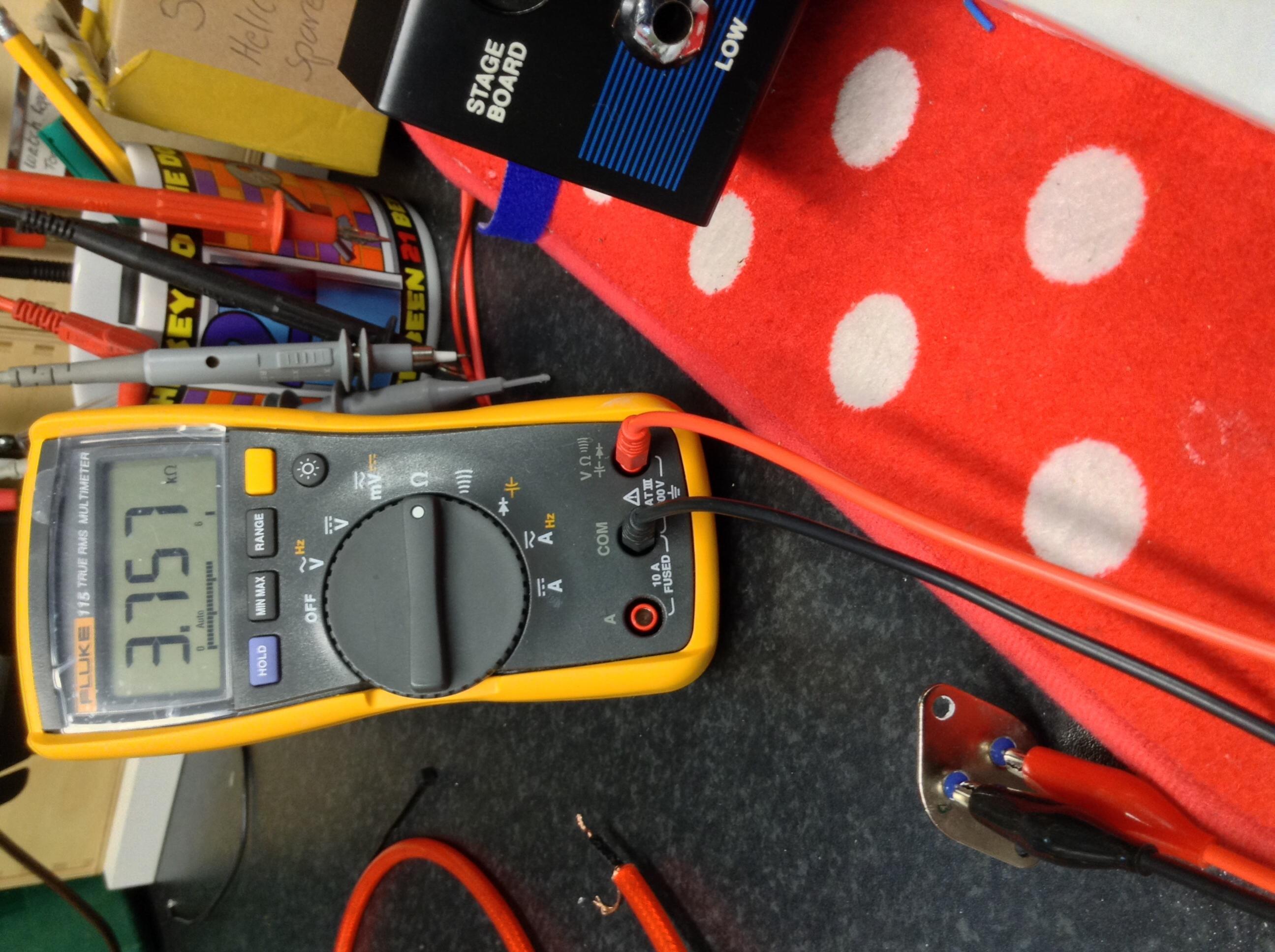

T9
Negative lead to Base & Positive to Emitter = 5.119 ohms
T10
Negative lead to Base & Positive to Emitter = 3.764 ohms
(I used the auto range on my fluke 115 multimeter to measure all ohms values )
ballast emitter resistor R158
Leads 0.1 - 0.3 = 0.2 ohms
ballast emitter resistor R159
Leads 0.1- 0.3 = 0.2 ohms

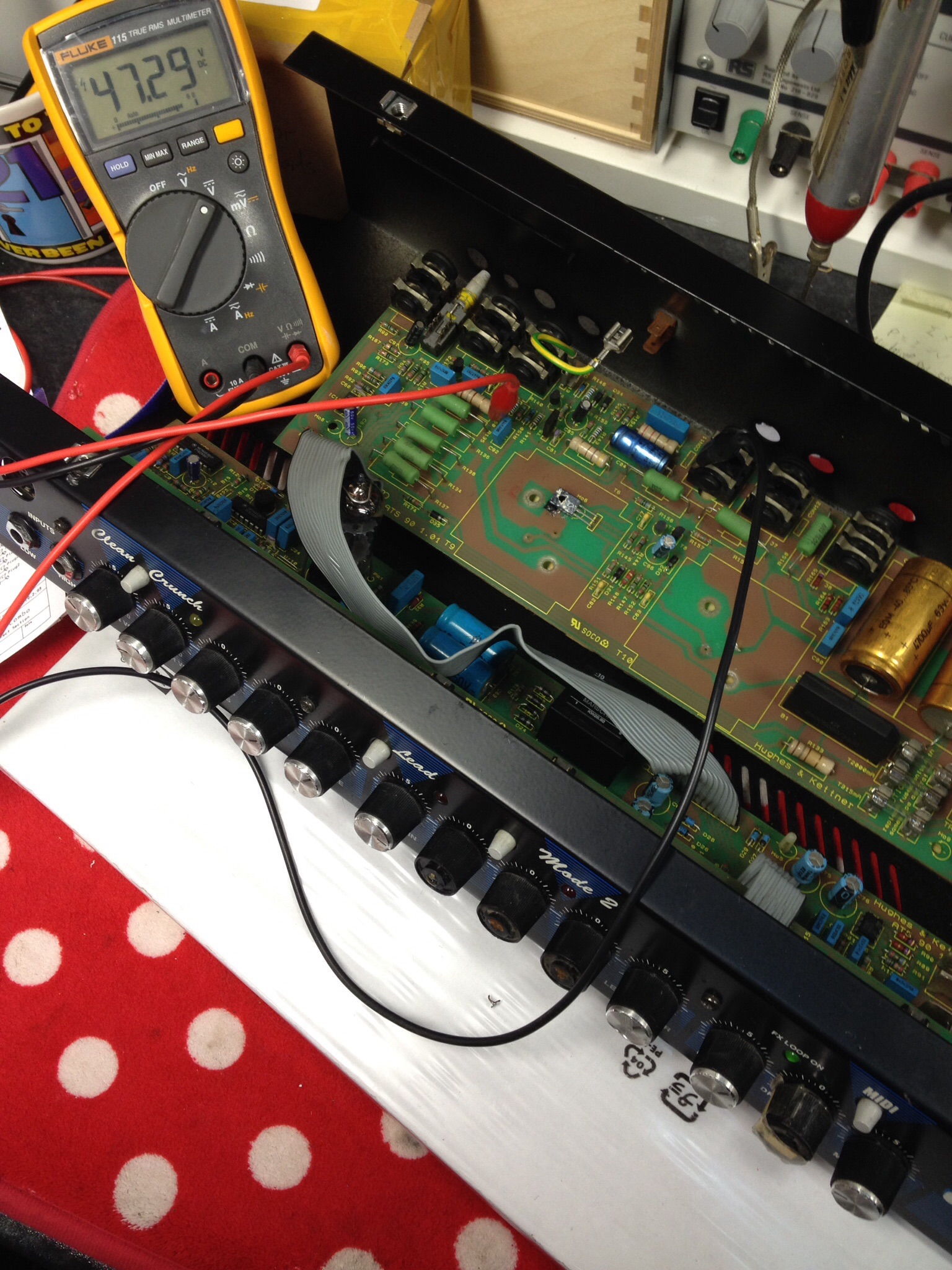

Re installed T9 and T10
Shortened out T6 C-E with short wire
No load connected & No signal connected.
Powered on slowly with variac and lamp current limiter (100w) - all ok, no light from current limiter.
Measured DC voltage at speaker out = 0v
Measured after being on for 20m still 0V
Measured DC rail voltage 45.75v & - 45.63v
I had to use the hold function on the metre to get a settled reading after the decimal point.
All seems ok
