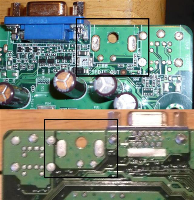

Where I need Help
The mobo only has analog output support from the manufacturer. In examining the mobo, there are S/PDIF solder points next to the onboard VGA adapter. I'd like to be able to tap into these and pass the AC3 audio onto the video card to be muxed into the HDMI cable and be passed onto my DSP.
How do I tell which of the solder points is the ground and which is the signal?
I've attached a picture of both top and bottom pics of the mobo mount area.
Thanks for the help!

In the top pic the small pad on the left has four small traces running from the pad to the surrounding ground plane, so that is the ground.
I'm far from an expert ont the subject, but you might need a resistor in series with the output an/or prefferably a SPDIF transformer.😕
EDIT: Actually, after looking at the pic more, there might not even be a signal present there. It looks like there are other missing components that the output might rely on.
