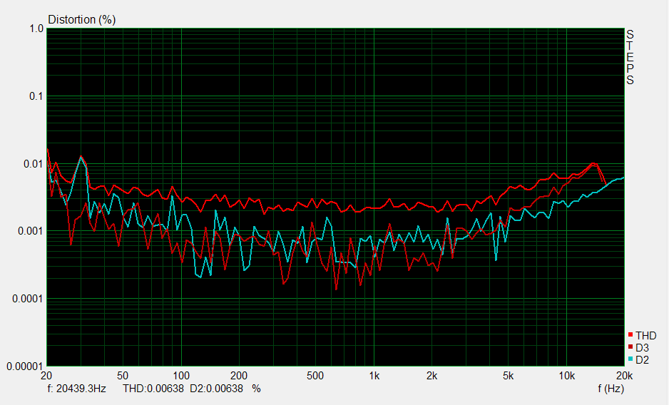

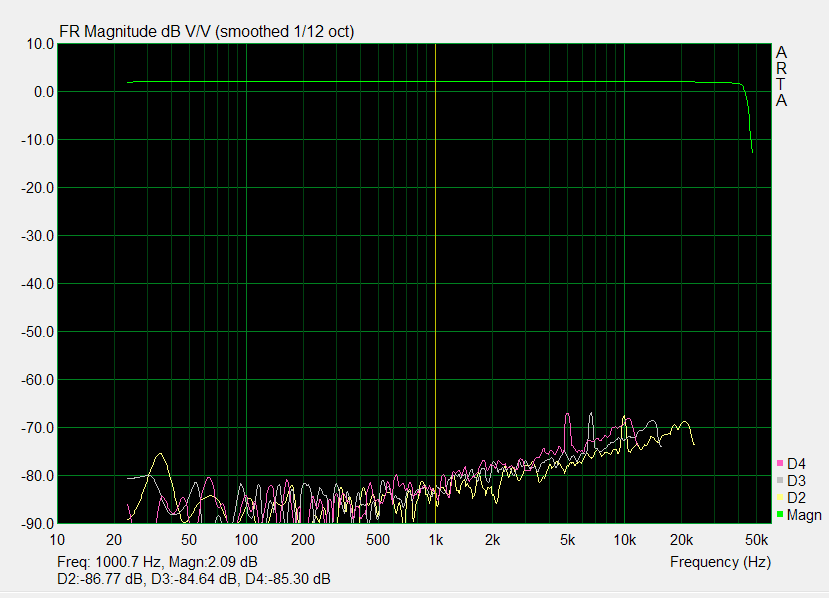

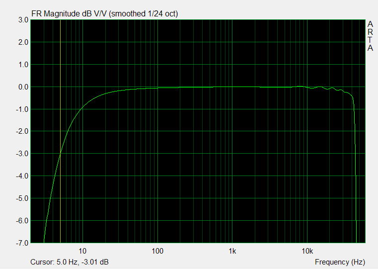

I'm currently going down this road. I have written and tested (but not yet released) some LADSPA plugins that can be very easily used under linux to process audio in real time into N filtered channels, e.g. to implement an N-way crossover. My plugins implement filters using an IIR digital scheme, which keeps the CPU demand to a minimum. If you want to consider that route, you likely do not need to throw so much money at the computer hardware.
For example, in order to build and test my plugins I recently put together a bare-bones system (motherboard, RAM, HD) for about $175 in parts. The motherboard has onboard 7.1 channel audio, can be powered by a DC supply (laptop brick type) providing as little as 24Watts (I verified this), and has passive CPU cooling for four cores. This makes the system very quiet (it would be totally silent if I used an SSD, but its nearly so already). I tested the audio I/O, supplying audio via the line input and taking audio back out via the "front speaker" outputs on the rear panel to my test gear. Frequency response, S/N and distortion are about as good as an early model CD player, but not mind blowing. Keep in mind that these measurements were made by going from the digital domain in my test gear computer to analog, then back to digital at the mobo line input, then through the filter, then back to analog, and finally back to digital at the input of my test gear. For $175 I was not expecting something that was top of the line, but it's certainly more than adequate for loudspeaker crossover work. Even with all the A-D and DA conversions the measured performance compares favorably to some hardware-based DSP crossovers, but comes with the versatility of a full-blown computer with an OS. See attached images for my measurements - NOTE, these were made using a 96kHz sampling rate while processing the signal internally using a single IIR filter that only modified the amplitude by -1dB.
If you are looking for better audio specs you might check out some of the 7.1ch cards that are available. Some of these are not expensive (e.g. <$100) yet have very impressive performance (on paper at least).
