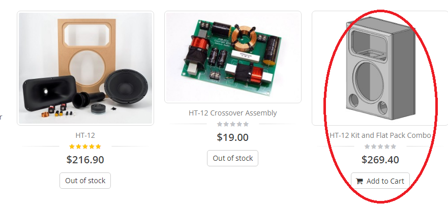

Here's what I see;
attachment.php
Perhaps these aren't available to you because when I go to this page I put a pair into the "cart" ( to check quantity availability ) effectively reserving them for a limited bit of time .
I imagine that means the pair aren't available to anyone else to buy until the software auto-releases them ( from my cart ) once I decline to proceed with the purchase.
IOW; try again in a few 10's of minutes.
Stupid me, I saw the picture and assumed that was just an add-on flat pack.
I am not in a hurry and can wait if the HTMs are coming back.
I am mostly looking for confirmation that building these and sticking them behind a screen is the way to go.
Or, am I just unaware of better ways to go for similar $$$?
For the price the DIYSG stuff can't be beat since the kits are full on kits ( which include knock-down cabinets and assembled crossovers, if wanted ).
