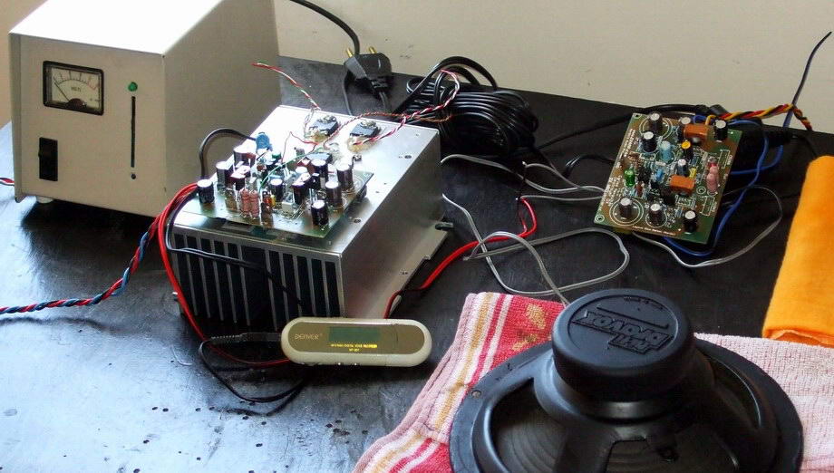

Here you have video i have made hours ago.... HRII rebuilt and listening the unit... the noises you will listen, while the video is reaching the end, are because of the MP3 output plug..contact... damn toy!

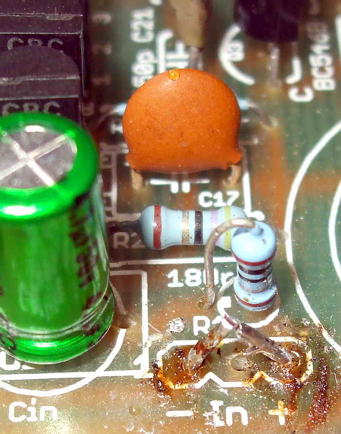

Into the input i am using bipolar 4.7 uF condenser…. In series with signal
and connected to drivers base, the 470 ohms resistances were substituted
by 100 ohms resistance…I am not using the treble booster..it is switched
off, my speakers, the ones I have now a days, are flat (not to much unflat).

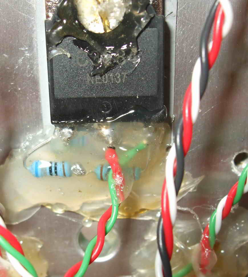

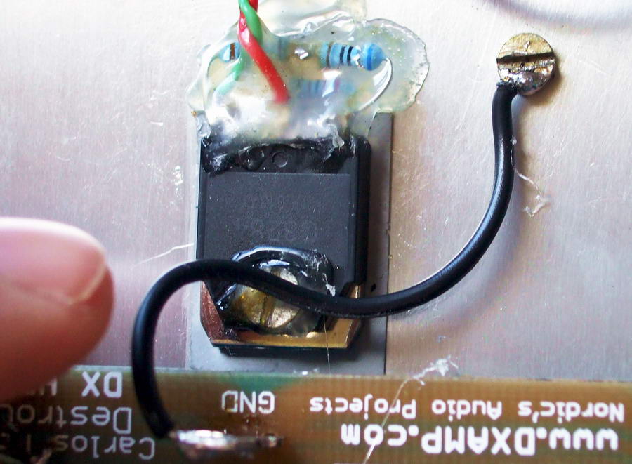

I have installed a big transistor as heat sensor... and
i have fixed the one, insulated, under the board... no trimpot... resitances fixed... 2K2 and 820 ohms.
This is hot glue... it melts bellow 90 degrées... and my amplifiers never reach this temperature... this same glue is fixing my board into the heatsink.
Will melt?... i don't think so.

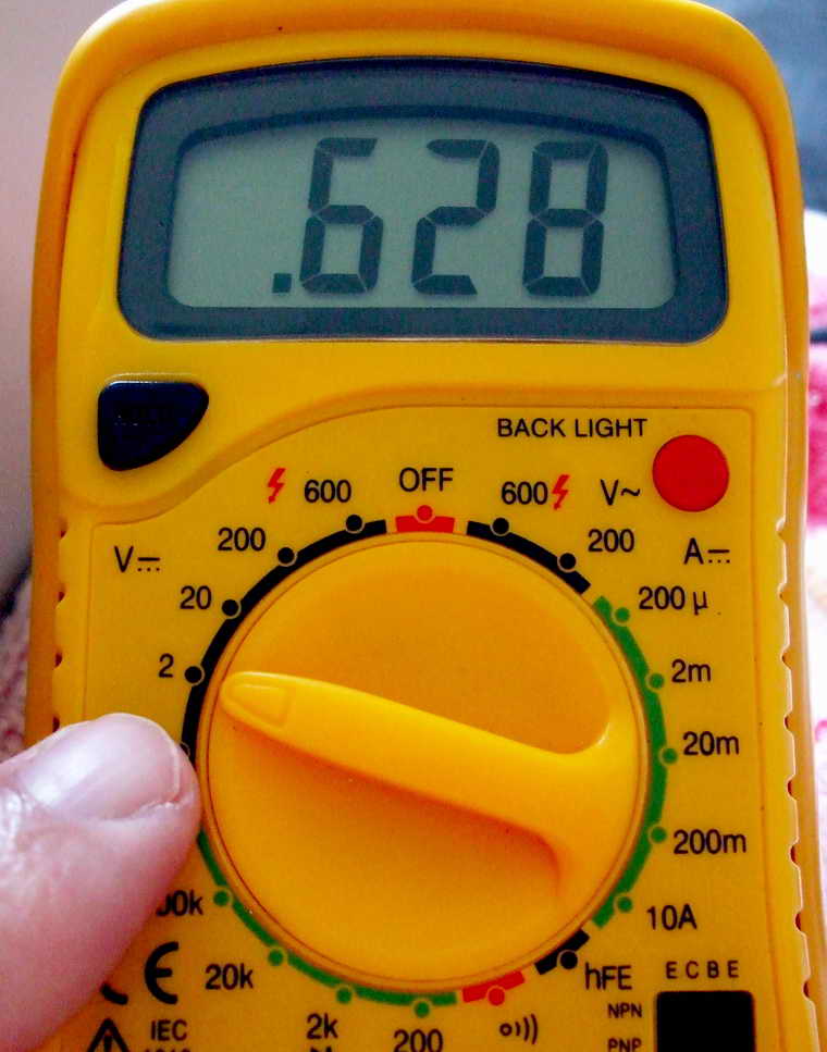

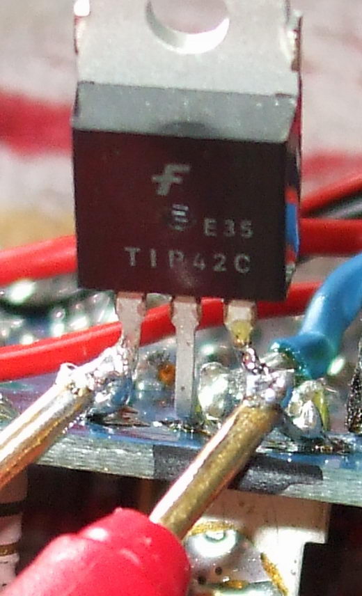

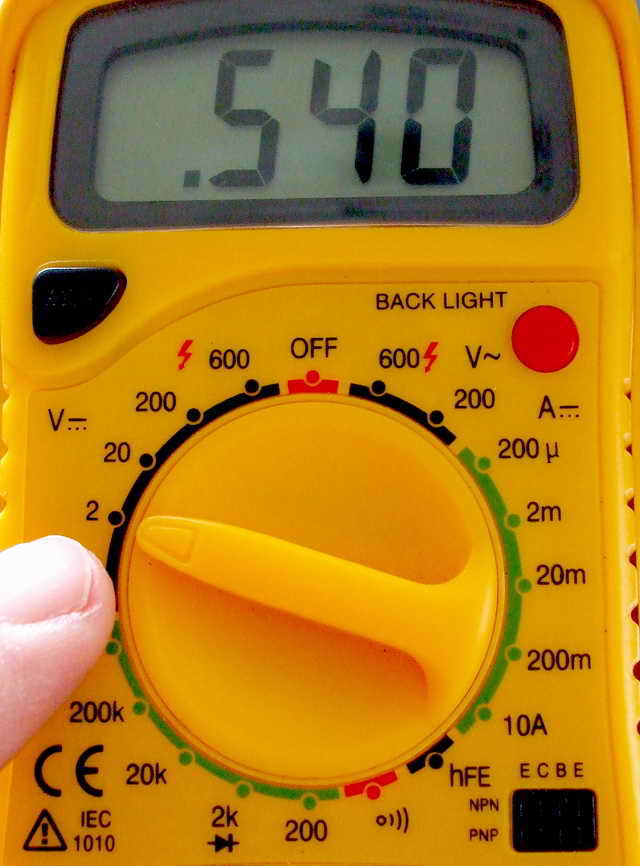

Check VBE into the output transistors... also
do the same with drivers, and also do the same with the voltage amplifier, also into the differential and into the rail regulators.
The voltage must be from 500 to 640 milivolts into the HRII.
But, the best voltage is 575 milivolts.... higher goes to the Vas transistor and 700 milivolts goes to the rail regulators base to emitter voltage.
This voltage is stable, as not drift or offset... and try to clean your probe point... i did it soldering to be sure...also i was observing thermal drift and VBE results.. studying the unit to perceive details to inform.
regards,
Carlos

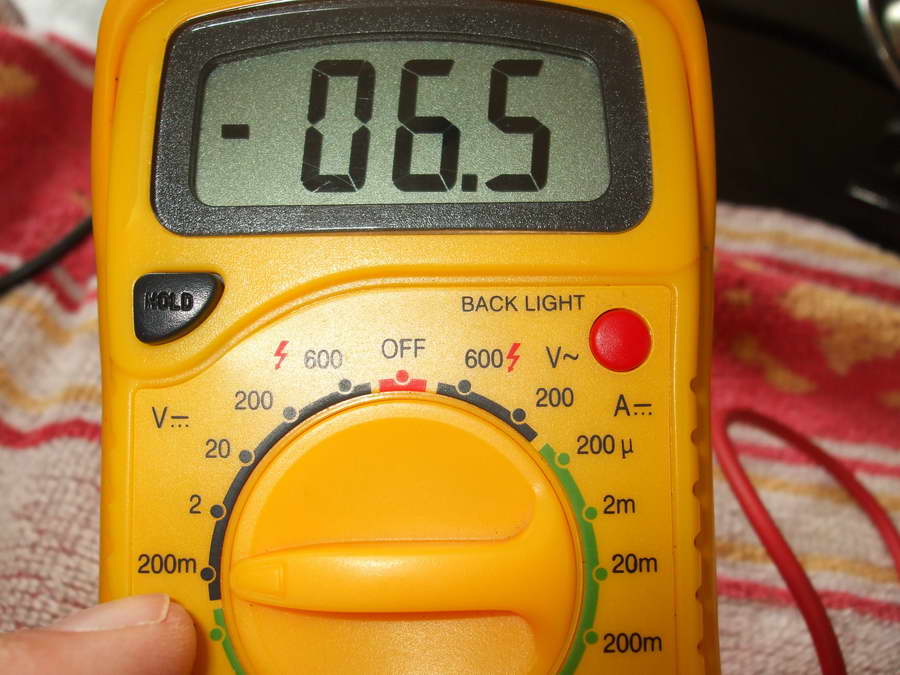

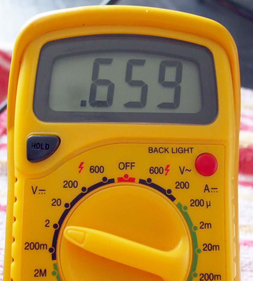

I found this adjustment fine...i could match because of this adjustment
the NPN and PNP output VBEs.
Observe the voltage measured over the protective resistances... this is sligtly different into the positive compared to the negative because into the positive side you have 10 miliamperes only to bias the zener diode you have into the input.
This is divided by 10 ohms (if you use 10 ohms as protective of course) and will result into 60 miliamperes... the unit is fine from 40 to 80 miliamperes... and can operate with lower and higher than that without problems too... this is the suggested range.
regards,
Carlos
