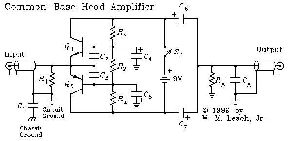

For certain phono cartridges, the common base stage has certain advantages. It IS linear, and it can be very quiet. However, it loads the cartridge, significantly, and many MC cartridges don't sound as good loaded this way.
This is why the JC-1 DC, and its bigger brother, the JC-1 AC actually failed to be as popular as I had hoped. I modified a JC-1 AC to be either inverting (Hi Z) or non-inverting (Low Z) with a switch. Making A-B comparisons, we found that, in general, the (Hi Z) position sounded best. This meant that the common base connection actually compromised the sound, somewhat. This was especially true with the JC-1, either AC or DC, because the parallel common base connection, halved the effective input impedance, for a given operating current. However, with a 'starved' Iq, the input impedance would increase, perhaps high enough to sound optimum, but it would be more noisy, to be sure.

Unfortunately, with the common base configuration, it is difficult to control the cartridge over any sort of range, without adding significant noise or distortion. Syn08 was trying to warn you of this, in his last input.
Actually, common source topology is really better for most situations. It is just as quiet, and it can give a loading from 10 ohms (or even less) to 1 meg ohm without special effort.

As I said, Van den hul wanted the phono stage to be Low Z. The easiest way to do this, 'naturally' is with a common base input. He should have hired me to make a variation of the JC-1 AC into his phono preamp.

The JC-1 operates as "common base" and the SSM2017 from Lehman phono cube as "common emitter"
For use the JC1 I it must to be select MM-input at the Lehmann phono cube with 47 K input impedance.

For me this gives only one conclusion: By high class commercial and diy MM/MC RIAA head amps there must be present (in all cases) both basic internal circuit variants for MC: common base and common emitter - in addition to the already mostly existing termination resistor input network !!!
But for me the actually question is follow: why I don't get high sonic transmission by cartridges with low internal resistance (like the above mentioned) at a common emitter input circuit, even, if I select external low termination resistance value around 5 ohms until 20 ohms?

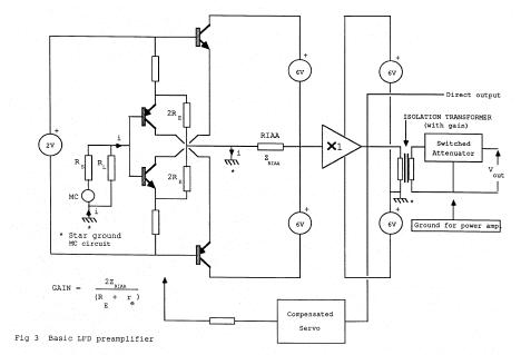

New for me is the use of an emitter follower stage as input for phono (as mentioned by start of this thread. This topology I have never heard and tested in real live, because I don't know commercial phono pre amplifier brands with such input stage.

Riaa networks with only inductors are new for me. But I have heard about RIAA network designs, both with capacitors and inductors. As I know, there are the advantage of a not complex load for the voltage gain stage before network. But I don't know, if this a real advantage or only a cosmetic advantage? Are additional advantages known (perhaps more exactly equalizing - e. g.)?
