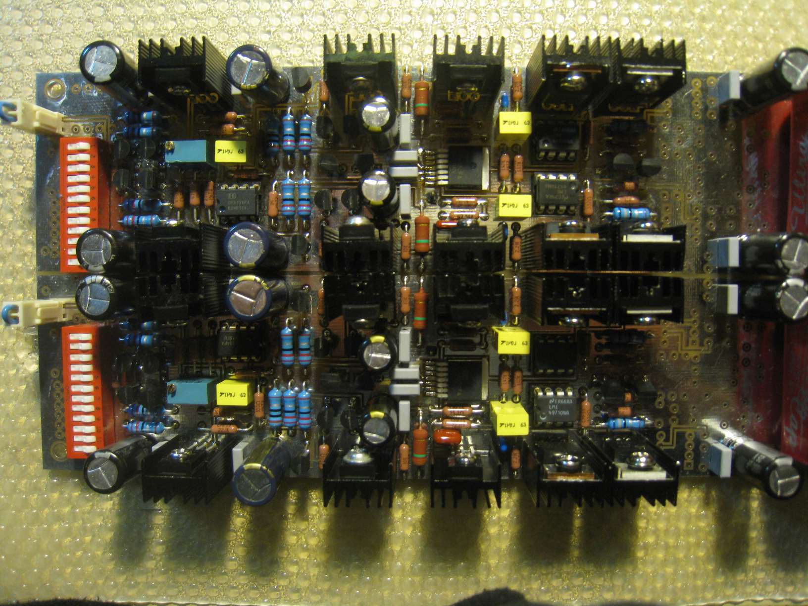

No need to use an LM337 here. As the current source is a true two pole device, you may use an LM317 as well - just connect it reversed.
Exactly, and the 337 is particularly bad, see the measurements made by Walt Jung in his article on current sources
Maybe (I doubt it's simpler though) however, from a performance perspective, even a 22 ohm resistor is already doing great.

The parallel regulator has 150dB loop gain and 2.6MHz unity loop gain. This makes the current source (be it 337 or a simple resistor) impact practically negligible.
There is a problem with this power supply, far from obvious and not related to the AC performances or anything that Spice can reveal. Hopefully it will not require HPS4.1

Probably right, except that LM337 has a low roll-off, but maybe I am nitpicking again. FWIW, if I cascade two even half-decent regulators in ltspice I get extremely high rejection figures.
P.S. What are those other power supply issues you are talking about?

And the problem is?
Heat distribution. I'll be back with details about.
Heat distribution.
I guessed that was the problem.
Is it only the power supply, or is it the same problem with all the heat sinks in the mid row?

The parallel regulator and the current source. They need to be in the proximity of the low noise input stage (running at high currents, to optimize the noise performance following Ic=Vt*SQRT(Beta)/Rsource). Dissipation (about 4W) is high enough to raise the temperature so that any noise benefit is slowly (in time) vanishing. It ends up into 0.5nV/rtHz and it's clearly audible in my horns.
HPS 4.1 is on the way, PCB is due next week. Jung regulators (far away from the low noise stage) and local cap multipliers, exactly as in HPS3.1. The local cap multiplier dissipate about 1W, that's ok. The other option would be to lay out away the parallel regulator and use force/sense. The overall PCB layout will then become a gamble.
I somehow saw it coming, but I said it's worth a shot, at least to estimate the AC performance (can't really breadboard something like this, with 160dB open loop gain and the open loop unity gain frequency in the MHz range). AC performance is absolutely superb, better than HPS3.1.
Another excellent news is that the input bias current can be trimmed down to under 100nA, which makes a high input impedance impedance possible. With a symmetrical layout (input stage devices approximately on an isotherm re: the OPA552 and the local regulators), it's perfectly stable with the temperature. I used the ro-theta web site online simulator to find out the approximative isotherms.
