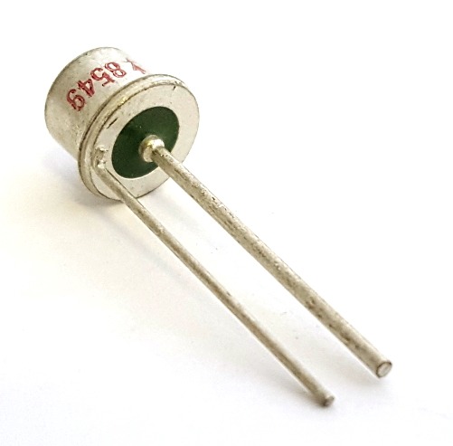

Q6 shows hFE 88, Ube 506mV, Ic 6.4ma
No idea if this is good since it's like many HP parts with no specs.

Since output voltage is high, I interpret Table 5-5 to say the issue is likely Q6, Q7, CR11, etc.
I decided to check Q6; then I got trying to figure out what specs Q6 had. Failing that, I
found them as NOS for $14 apiece or so.
Don't seem to need a replacement, as you confirmed, so that was a waste of time.
I was confident that pursuing the voltage specifications like we did would lead to the solution but that was inconclusive.
I'll use the multimeter method too but I'll Q7 next too.

I managed to break a lead on CR11 while taking it out. The TC1 tester shows uF=570mV, c=275pF, Ir=6nA
The solder sure seems hard to melt. HP says to heat from the top but I sure don't see how for a lot of the components.
The solder all the way through the board maybe makes it harder? idk

I believe CR11 is a generic diode to protect Q6 from reverse voltage; assuming it's not a high-current device, a 1N200X should suffice.
