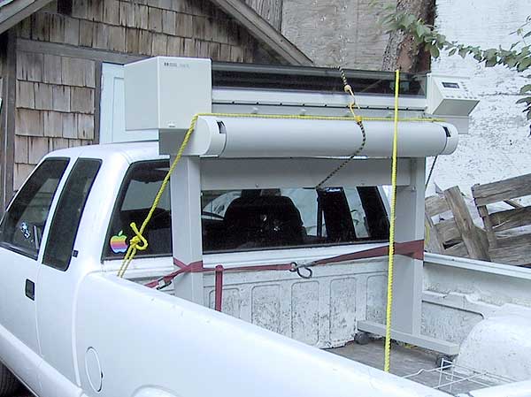

Attached is a pic of the 1st Design Jet shipped in western Canada (we delivered it in 1991 or 92) -- now come back to me. It is so old it is just a Design Jet -- no numbers. As far as i know it still works fine, but has been sitting unused for a bit. If i get it functioning, we'll use it for reprinting out-of-copyright sewing patterns.
