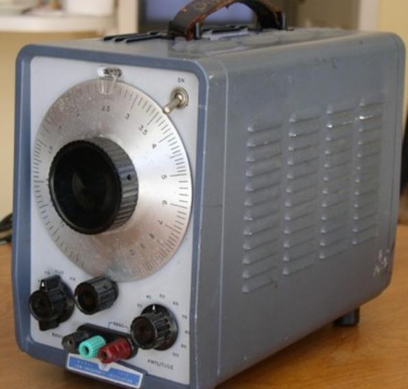

My HP 202C signal generator is acting up, used one for years, now it just oscillates, and can't use it. The sound is what my dad used to call "motor boating".
It has tubes, should I start there?

The vacuum tubes are a possible candidate. In the days when every neighborhood drugstore had a tube tester (which was when there WAS such a thing as a neighborhood drugstore), checking tubes was a quick and easy first step.
Given the age of the instrument I'd place wagers on a faulty electrolytic capacitor as the culprit in this case. A dried-out bypass or filter capacitor will have less effective capacitance than necessary to do its job, or a leaky coupling capacitor will upset the biasing of one or more stages.
I haven't looked but I suspect there are several copies of this instrument's schematic, or complete service manual, posted on the 'net. I'd start by checking the voltages in the power supply section. If they seem to be acceptable and not widely jittering I'd look at the voltages on each tube pin in an attempt to determine which stage has the motorboating problem, then focus on the electrolytic capacitors associated with that stage.

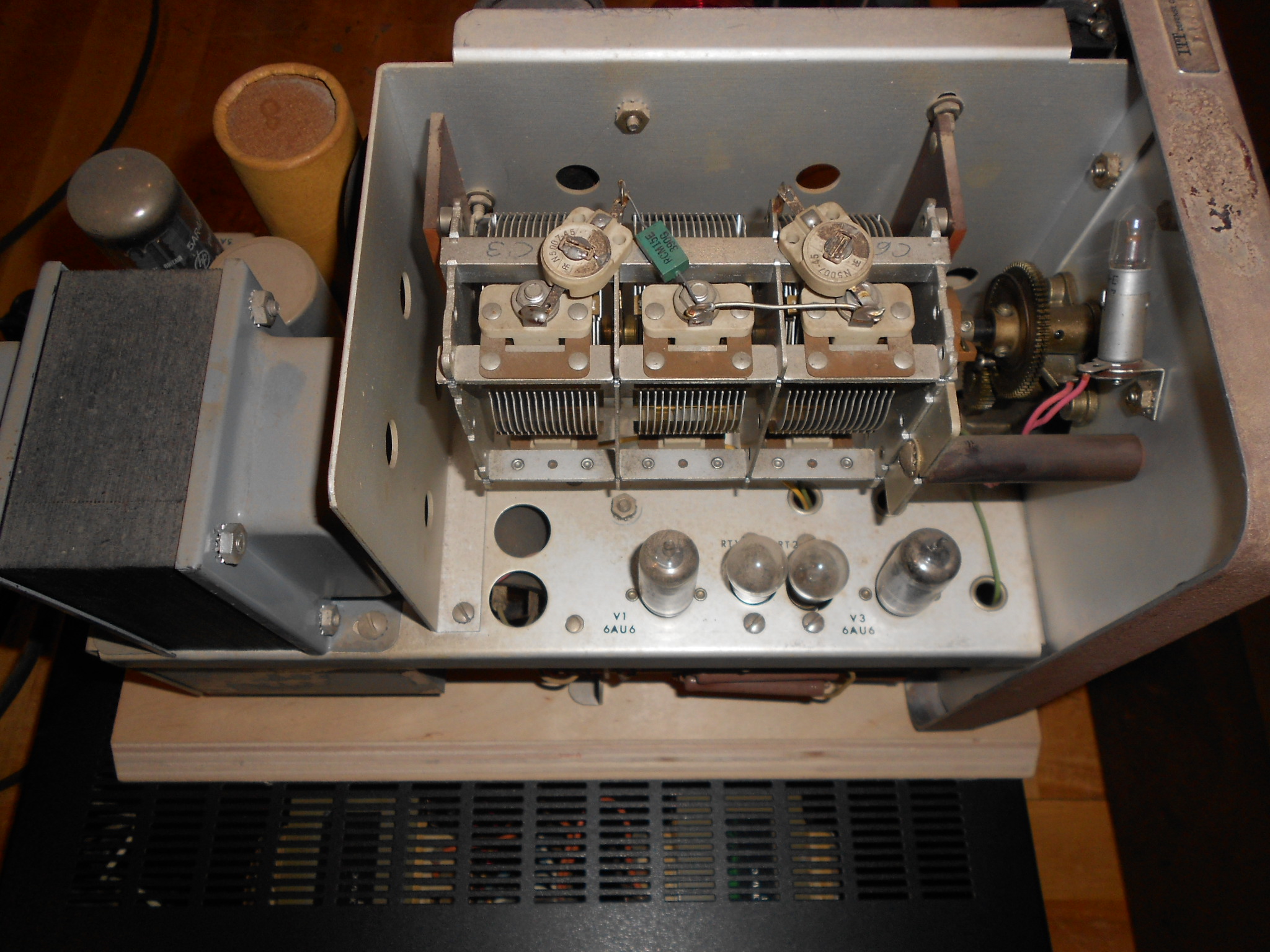

Thanks for the posts. I'm kicking myself for taking a peak inside the other day; talk about bad karma (it was still working then). The tubes looked good and hot; noticed there was not much in there, I did see several caps and they looked easy to replace.

If you intend to keep this generator in service as a working instrument (rather than ornamentation on the nostalgia shelf, or a "completely stock" museum piece) I'd replace all the electrolytics on principal. Modern capacitors of the same electrical ratings will probably be physically smaller and may require some modifications of any mounting clamps, etc, that may have been used. Pay close attention to the voltage ratings but it's probably OK to use the next larger capacitance value if you can't find an exact replacement value.
I think there's only 4 tubes in that generator, and one of then is a dual rectifier (probably 5Y3 or 6X4). In retrospect it's amazing what circuit designers from a couple generations ago could do with a handful of active devices.
Your frozen tuning dial may be nothing more serious than some congealed lube, either in the dial mechanism or the variable capacitor itself. The repair is conceptually simple - just flush out the old grease with a suitable solvent, and replace it with a dab of silicone grease - but it takes a fair amount of disassembly to get to the parts.

Yes thanks Dale, going to need to soon I bet. That would be a job to disassemble the spare, and it probably needs caps also. I did drop small drops of oil at the mini lubrication holes on the gears/shaft and letting it sit.

Had to bring out old scratchy (back up generator) I did oil the bearings a few weeks ago and it works much better, still sounds like something is scraping when turning the dial.
This look the same on the outside, all different inside, smaller tubes, etc. I don't think I can switch any parts. It does seem to be loud and clear as far as tones.
