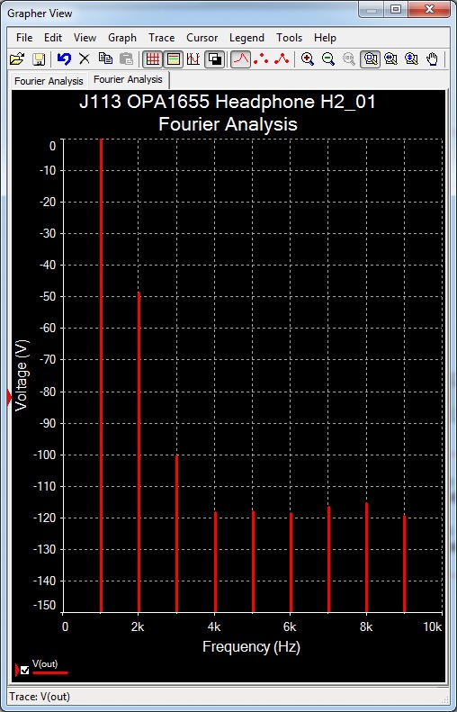

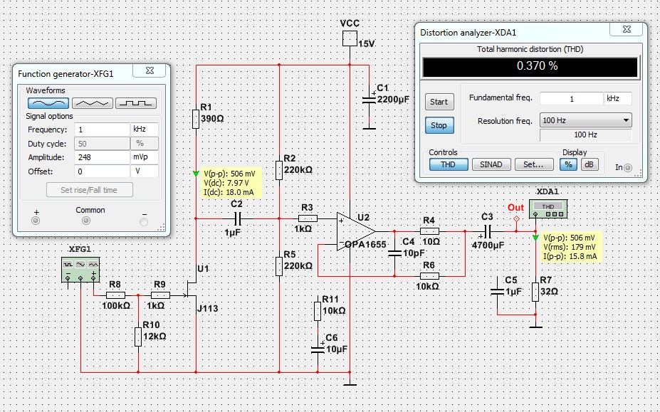

Here is a new version using H2 Generator.
The level is 1mW into 32 Ohm = +0dB.
R1 should be adjusted to give like 7-8 Volt across the JFET.
As can be seen we now have lots of H2 at this lower level.
Actually, two OPA1655 in parallel drive 32 Ω pretty easily. That's what I do in the HP-2. You can see the performance with 32 Ω load is the Specifications and Performance Graphs tabs of the product page: https://neurochrome.com/products/hp-232 ohms load... for the standard OpAMP. 🤣🤣🤣🤣🤣🤣🤣🤣🤣 Enough. 🙂
The OPA593 provides 250 mA output current, so that might be an option for a headphone driver as well. It's pretty noisy, though. YMMV.
Tom
Should R11-C6 have been connected for this sim run?
10mW (1.6Vpp into 32ohm) is +20dB. So it would be 120dB in Grado.
Since my Grados produce 100 dB SPL with 1 mW, they will produce 110 dB SPL with 10 mW. A factor of 10 in power is 10 dB. A factor of 10 in voltage is a factor of 100 in power so is 20 dB.
