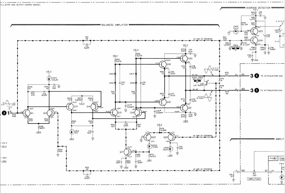

Assuming the power rails are OK :
(1) Take a look at the signal at R44, the input to the balanced amp. It should be 3v peak to peak and a perfect sinewave. Probe both ends - they should be near identical. if this is OK then the problem is in the balanced amp
(2) Check the bias point (voltage) at emitter/collector for Q13/14 Q15/16 against the figures in the schematic. Check the voltage accross R64 (should be ~11.8v and nearly dc) this provides the tail current for the Q15/16 diff-amp but is modulated by the DC balance R74/75 and C32 at higher frequencies.
(3) check the signal at the O/P R76/77. if this is very asymetric it will pull the tail current for Q15/16 out of whack - you can disable this by unsoldering Q22 base and connecting it to 0v to ease diagnosis.

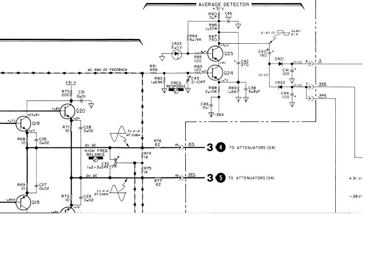

Yopu know that C40? the 180uF? Well, where is it in the schematic because the schematic you posted is not the section you are referring to for this capacitor. I am thinking you could possibly substitute the value for maybe, 160uF or 200 uF. But I need to know the function of that cap. By the way you can check mouser, I'd rather buy there, they have more oddball components. And if that doesn't work then try Jameco, or maybe Newark.
Color test.tomato, does it work?
yea, that schematic was posted by DRC. I bought the whole manual on pdf, great resolution too, if you would like a copy Ill just email it to you, or tell me how to post it on here.
Ill try to upload the schematic of where C40 is. I am not sure if this capacitor is what is making the output be only half a sine wave and no movement on the meter...but we will see. I think its one of the transistors in the balanced amp.

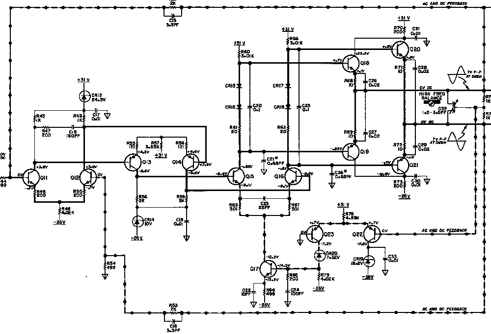

Hi again deyjavont,
Well you're going to have to post the part of the schematic where you find Q11, because it's kind of hard to tell why you get those signals on its pins, without knowing what's connected to it. I mean it could be the emitter resistor (if Q11 serves as a common emitter or emitter follower amplifier) of Q11 is bad, it could be that Q11 is bad, it could because the voltage supplying that part of the circuit is not correct because of some other component no so far away.. You know?
So post that part of the schematic, and we shall investigate further...m'yes.

Hi again deyjavont,

DRC posted a fuzzy version of the schematic I am posting. Q11 is to the far left in the middle. it is the first transistor in the balanced amplfier. the buffer amp is what precedes it.
I am a little hazy on my knowledge of balanced amps, and how you split up the signal to have the two signals 180 degrees out of phase. ( or are they just inverted?)
My circuit analysis professor suggested I should replace all the capacitors in the balanced amp, considering the unit is from 1968. But he didnt know what that waveform means. haha.

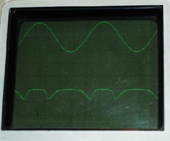

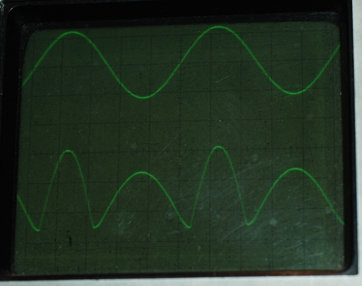

I'm a bit confused about the waveform posts ...
Post 30 - 2 traces : is this the base and collector of Q11 ? If so it looks fine ...
Post 31 - 2 traces : not sure what these are, maybe Q12 ? If so, looks like some crazy compensation going on but looks OK, ie a fault somewhere else causing this - ** possibly **
Post 32 - 2 traces ; again i'm confused, is the lower one the output ?
OT, just back from 3 weeks in the USA so i'm a bit lagged
Here's how i would invesigate the output amplifier, 1st stage :
(1) Connect CH1,CH2 probes the Q11 and Q12 collectors, with the same channel gain and DC coupled, indicating where the 0V point is. This will show the DC bias conditions. The schematic shows the nominal values ...
(2) Switch to AC coupling (adjusting gain on both channels). This will show the dynamic signal at each collector, each may look somewhat distorted but this is OK ...
(3) Switch to "difference mode". The difference signal should not look distorted ...
repeat for Q13/Q14 and Q15/Q16
my guess is that at some point one of the collectors will be missing OR the fault is in one of the OP buffers Q18,19,20,21
Chris,
Without any expertise on these particular things (so take all this for what it may be worth), it looks to me like Q11 looks unhappy because it maybe isn't getting any negative feedback. NFB is supposed to be coming in by way of Q12, making it go ugly and not follow the whole waveform.
So what is the AC signal at the base of Q12? It should look pretty much identical to that at Q11's base since it is the global NFB feed point. If not, look down the line at the collectors of the other gain stages (Q13&Q14; Q15&Q16) to see if the signal suddenly gets lost somewhere down that chain.
What is at the emiiters of Q20&Q21 (they should look about the same)? Those are where the NFB to Q12 comes from.

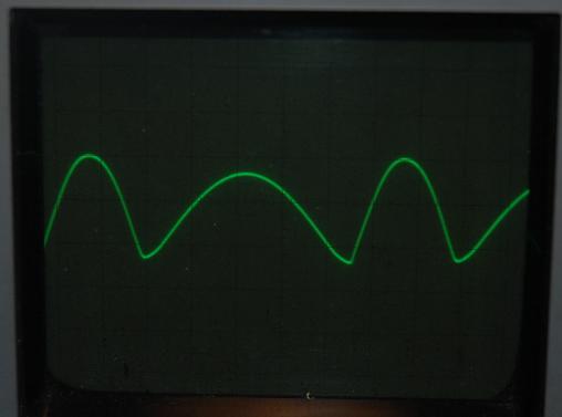

okay guys. sorry for the lack of replies, been soo busy with midterms and lab reports!
Ill attach photos of what is happening in the circuit and i will try to be as specific as possible. I am almost thinking that it might just be a bias problem, but we will see. I suspect that Q11 is bad, biased wrong, or something totally different.
thanks again, if you are still with me...
this picture is of Q11 Collector.
Q13 base, Q13 collector and Q14 emitter are the same as this (or same waveform)
