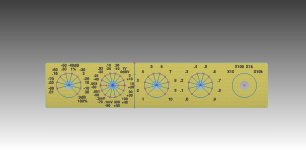

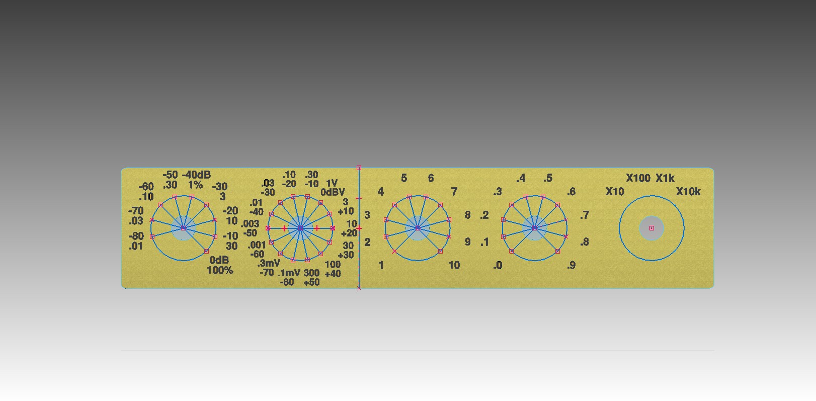

I had a bit of time to redraw the overlay plate this week. I attached the revised plate for my Option 1 339a. I also have a 12 range plate design. The option 1 plate with 14 ranges makes for a cluttered dial. I had to drop the font sizing to .110" down from .120" on the other knob dials.

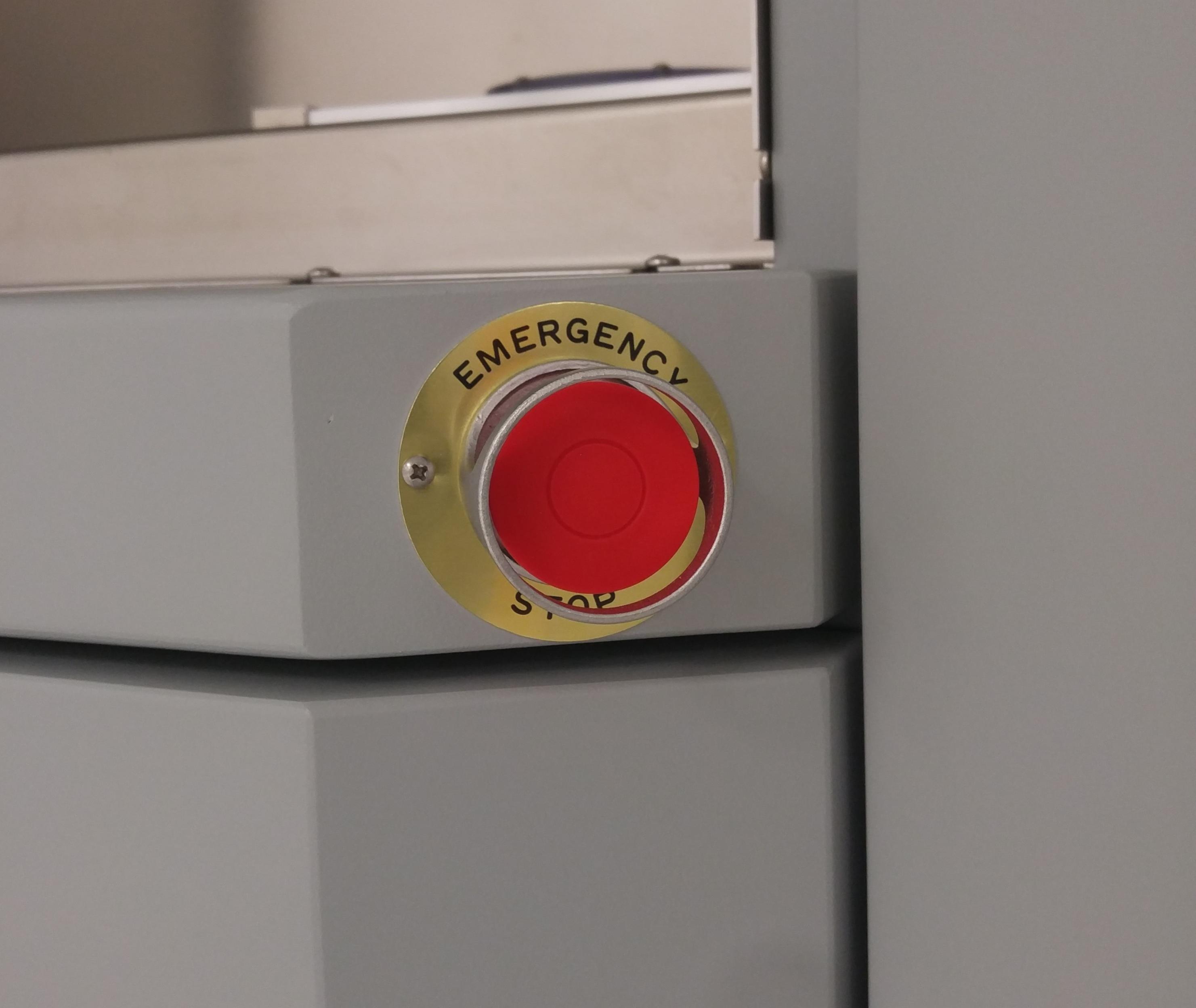

I'm leaning heavily towards the gold background with black lettering. I realized this week that one of the systems I support has a gold with black lettering plate on it and the contrast is very good. I attached a picture of it.

Sorry, I've been sidetracked with some things and haven't been able to get back to this project. I'll look at my drawings tomorrow and see what I've got on there. I ended up dropping the holes and making the plates shorter in the last version of the plate. In the original plate that had the holes I made the holes slightly larger for LED's to make sure they were not blocked in any way.

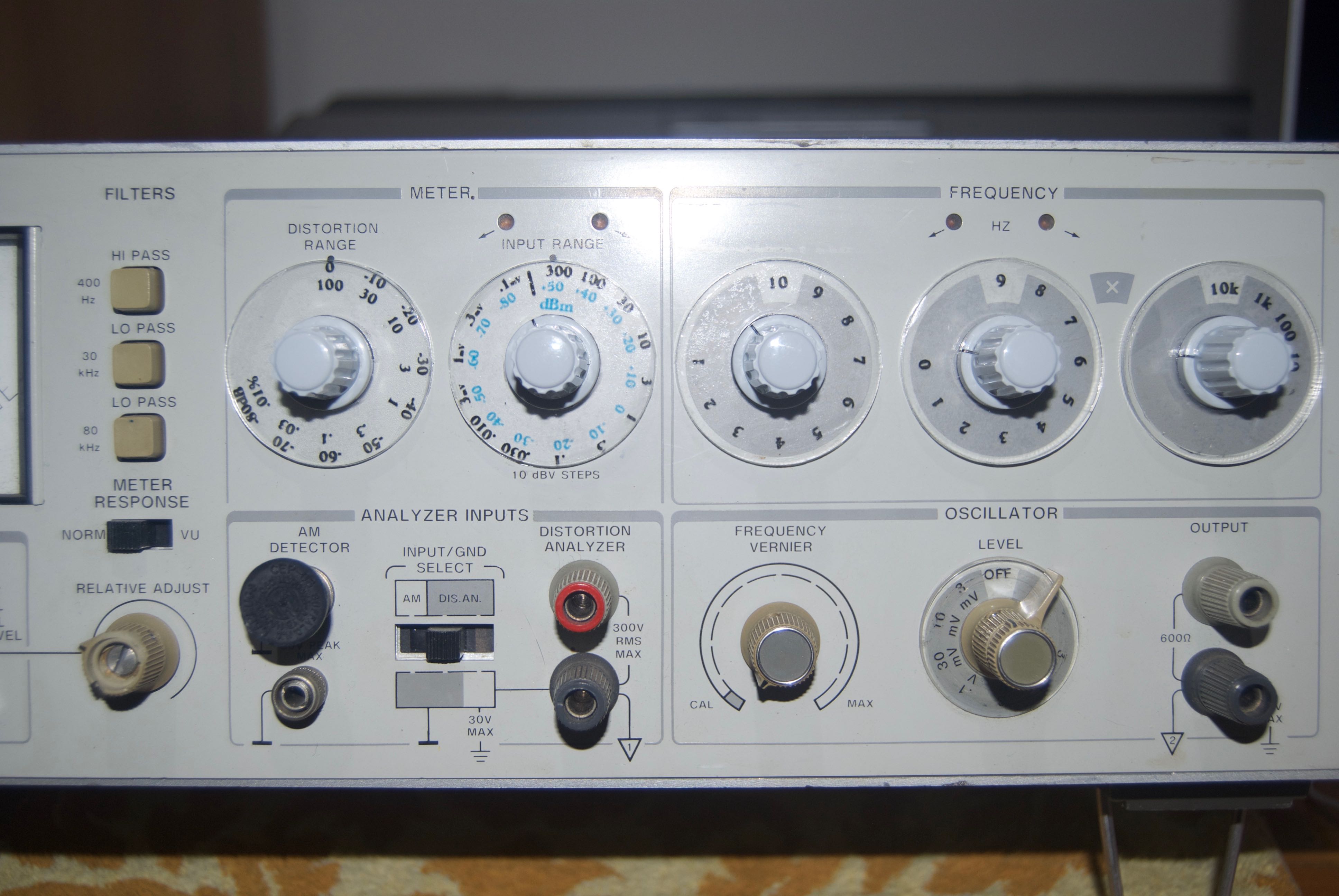

I finally got around to replacing the missing top row knobs on my HP 339A. Used Elma knobs with an acrylic disc skirt glued on and printed decal lettering on the back of the disc.
A fairly easy fix and seems to work OK, even if it doesn't match the originals.
Photo attached

Looks very good and I like the visibility of the lettering you selected better than the stock HP lettering.

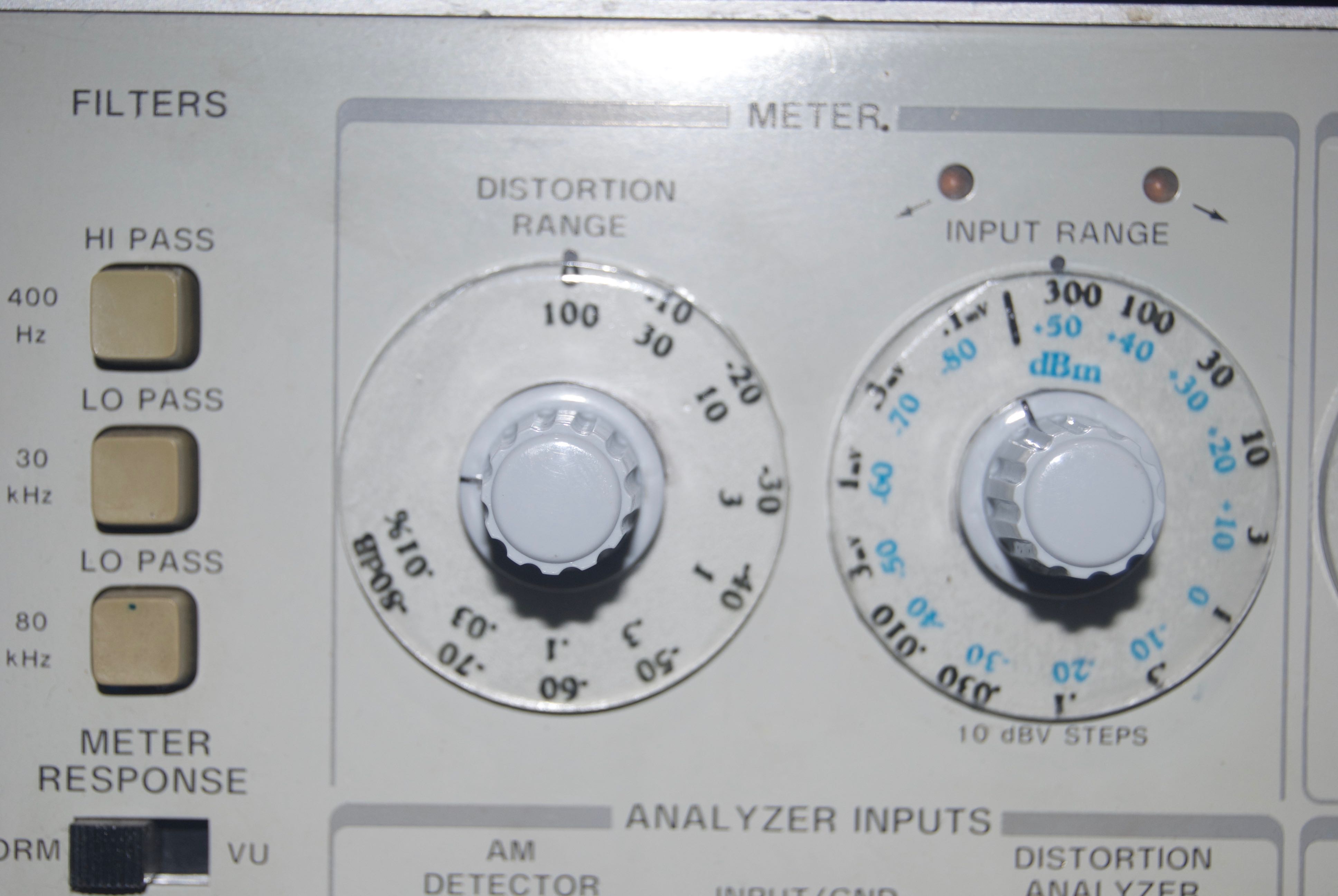

Thanks for the feedback Chamberman and Anatech. I've attached a closeup photo of the distortion range and input range knobs - which unfortunately does show up some of the flaws.
Also a pdf file of the lettering for all 5 knobs. The lettering was done using The Print Shop 3 for Mac, but I couldn't upload the psf file because its not a valid file extension for the forum. Printing probably is cleaner using Print Shop, but the pdf should work provided actual size is chosen in the Acrobat print box.
The knobs used were Elma 1/4in 020-3510 collets, together with 044-3110 nut covers. Laser cut 2mm acrylic discs - 42mm diameter with 13mm centre cutout - were glued to the nut covers with JB Weld. The lettering was done using an inkjet photo printer on waterslide decal - mirror image so that it could be fixed on the back of the disc.
The main problem is that the decal can lift at the edges from the acrylic disc when dry. A glue stick can fix this if it happens. Also the knobs are a bit small and so the switches are stiff to turn. Probably why HP originally used the winged knobs. There is an Elma winged knob (022-3510) that would be better, but I couldn't find a supplier who sold it in grey.
