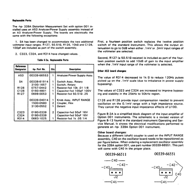

Anyone out there add Option 001 to their 339A's themselves?
The HP 339A ....with option 001 installed used an A53/Power Supply assembly instead of
an A3 Analyzer/Power Supply. The boards are electrically the same with the following exceptions:

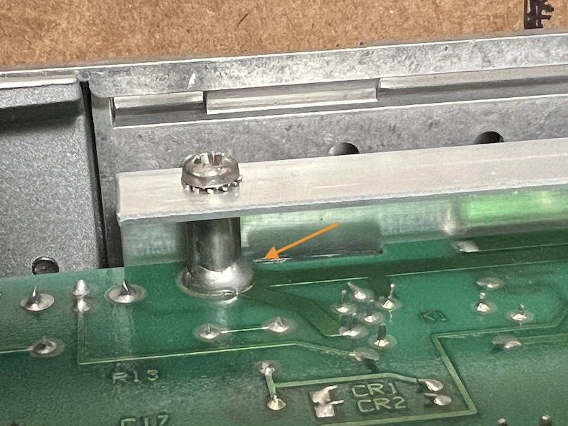

This is interesting, on the back of my A2 board, one of the posts seems to be soldered to the pcb:

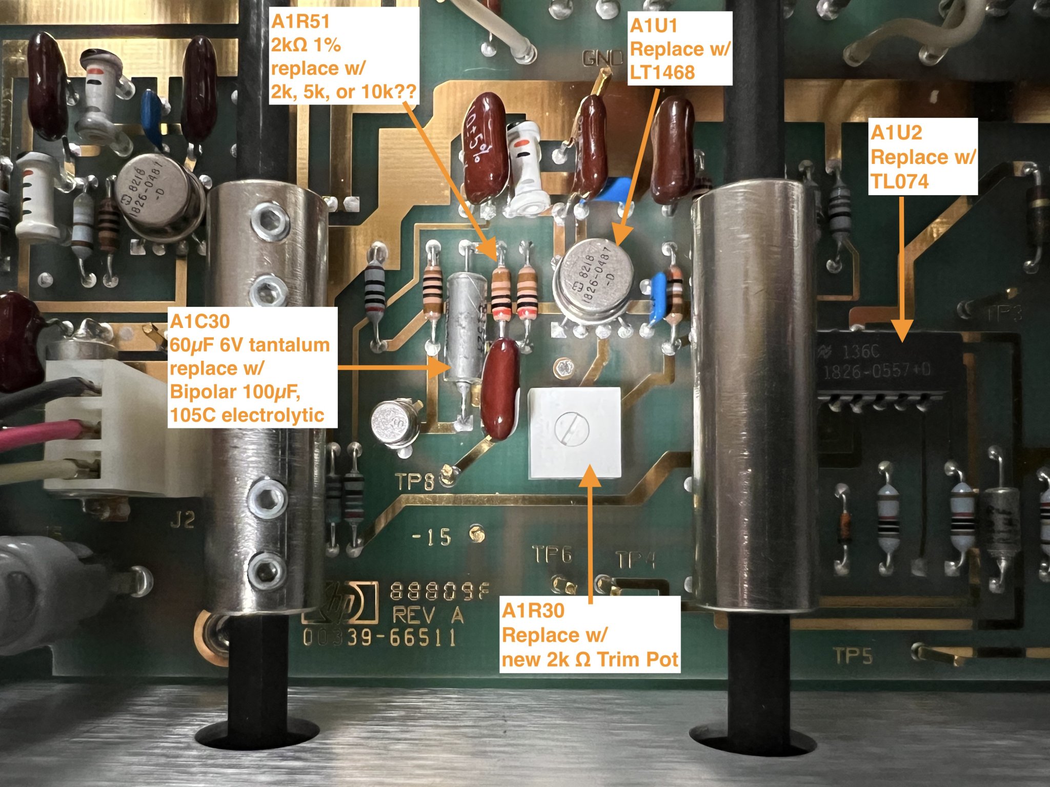

Question for anyone out there, on the oscillator board, I've seen three different trim pot replacement values for the AR51 (2k ohm 1% 1/8W resistor) including a 5k pot shown in RNMarsh's post (picture shows trim pot with 502 markings-> 5k ohm). As well as 2k (same as original resistor value) and also 10k ohm trim pot. Any reason to use a trimpot value other than 2k for R51?

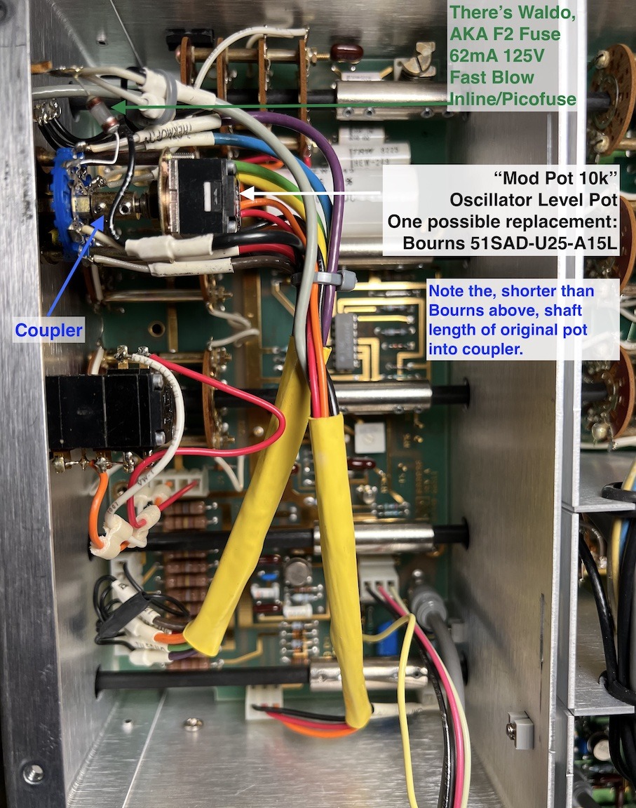

Two blown fuses,
the chassis F2 osc level pot inline mini fuse,​
62mA, 250V, Fast-Blow, .281 x .093" (mini/pico fuse)​
and the A3 board (F100) cartridge fuse,​
100mA, 250V, Norm-Blow, 1.25 x .25" are blown.​
The A2 board (F1) cartridge fuse is the only good one (along with the .250A mains fuse, as the unit does power on).
62mA, 250V, Norm-Blow, 1.25 x .25".
