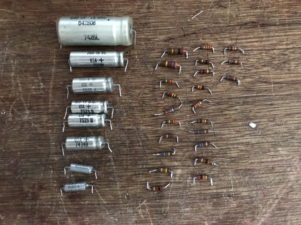

I initially recapped the power supply ( as it was easy to pull out the card), the thing is otherwise built like a tank; lovely quality actually.

I've opened it up again to re-cap all of it and have discovered that the carbon composition resistors it uses in presumably non critical locations all seem to have drifted high, out of tolerance.

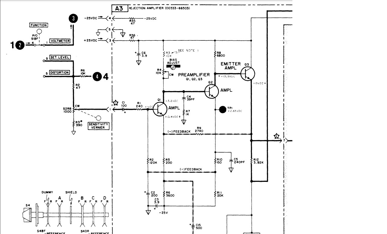

I'm therefore rebuilding the boards one by one, starting with the easiest to get at, the Rejection Amplifier PCB no. 00333-66503. The circuit diagram is on page 67 of the service manual: https://www.davmar.org/pdf/HP334A.pdf
My first question is for some reassurance, I'm planning on replacing C13 & C15 (500uF 15V Sprague axials ) with 1000uF 50v jobs as the old ones are so huge that I have space and reason that doubling the size of the output coupling capacitor and the feedback capacitor won't deleteriously affect the function of the circuit. If this were an cap coupled audio amplifier I would not hesitate but test equipment is above my pay grade at this stage and there may be subtle factors or interactions at play that I am unaware of, any comments please?
The second question is about the tantalum capacitors (C3 and C6, same page of service manual) that filter and bypass the power rails, they test fine but I want to replace them as a precaution, they are 3.9uF 3v jobs. I've read on datasheets for three pin regulators that "an output cap of 1uF tantalum or at least 10uf electrolytic may be used". Is there some sort of convention whereby a tantalum cap should generally be replaced with an electrolytic of ten times the value in power supply decoupling?

I also replaced all of the carbon resistors, they had drifted high by 10-15% across the board though some were strange values and so I had to parallel two resistors to make up the correct value.

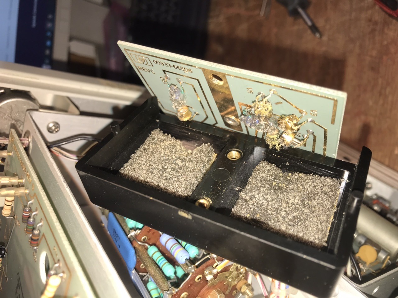

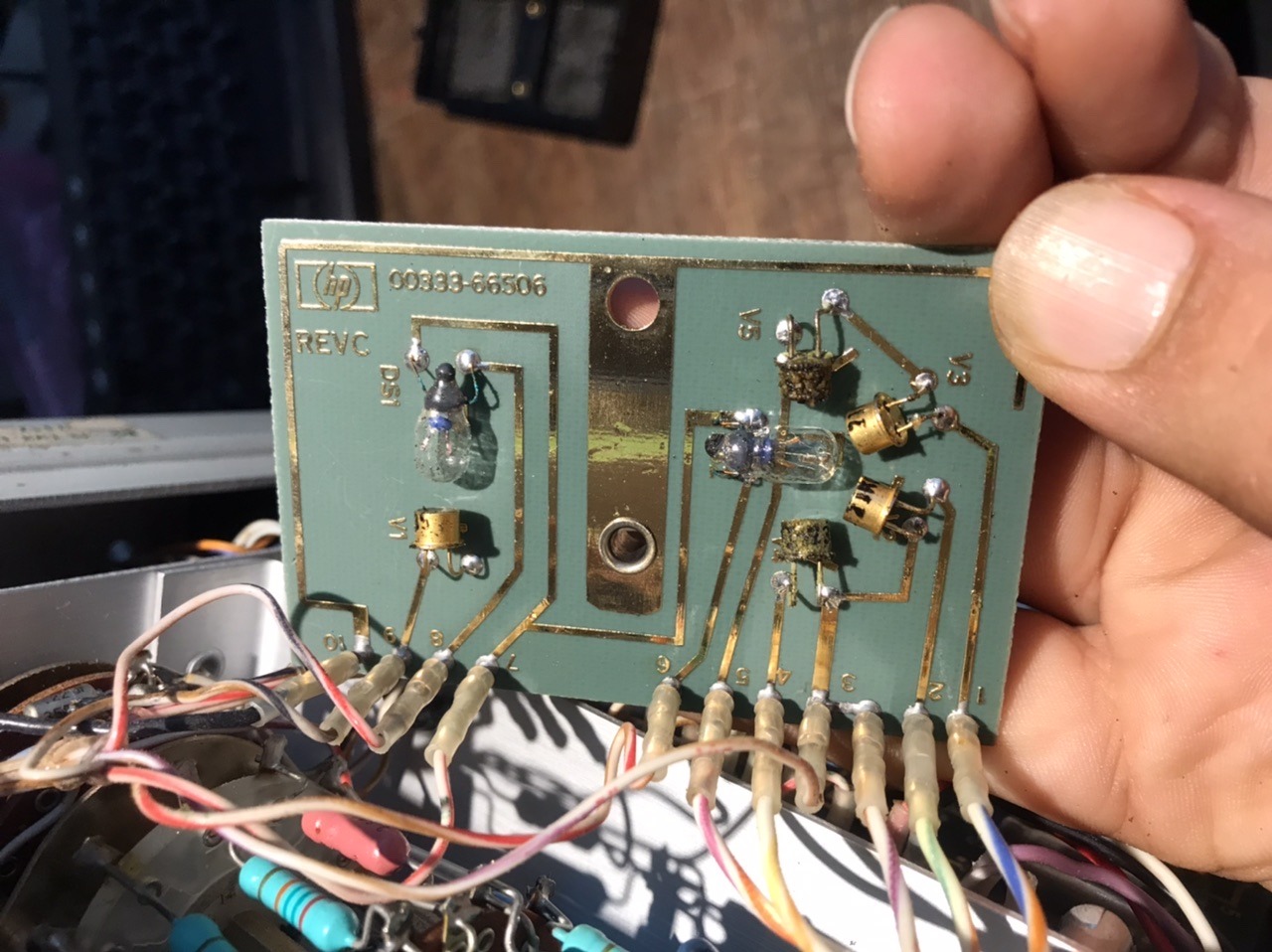

I'm going to tackle the LDR/lamps portion of the circuit next, it looked a bit grim under there with foam rotting and coating the bulbs and LDRs in sticky residue. I'm attempting to find a solvent to clean them but am wondering whether to replace the rotted foam and if so, what with?

The larger value and higher voltage electrolytics seem to be fine but it's the low value and particularly low voltage ones seems to have suffered with their capacitances seeming rather high and showing electrical leakage in some cases.
Photoresistors need calibrating:
Before:
V1 (30k) : 20.95K
V2 (15K) : 41.75K
V3 (15K) : 94.95K
V4 (150K) : 825.5K
V5 (150K) : 61.15K
One bulb is also noticeably dimmer than the other one.
(page 39 of the service manual above)
I swapped the bulbs around and the dimness is related to position rather than the lamp.
the lamp that serves the photoresistors V2-V5 is the dimmer one and all of the readings from that lamps are lower than they should be, I wonder if there are more issues than a bad photoresistor or two?
The figure in brackets above is the service manual expected and adjust to figure, the second figure are the actual measurements from my unit.

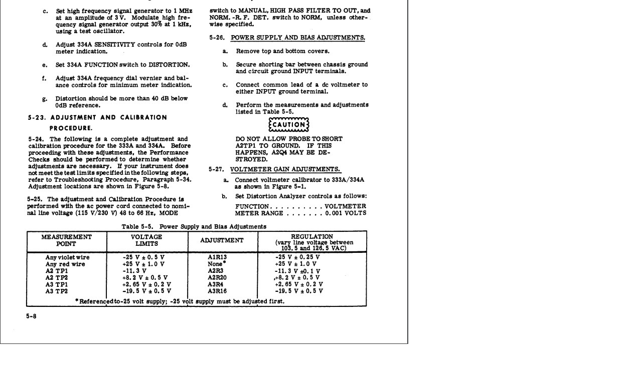

The service manual gives the following checks to perform:
All voltages were either in spec or able to be adjusted to spec except for the bias of 2.65v at TP1 on the A3 (rejection amplifier) board. I don't think this has anything to do with the bulb issue but had completely re-capped this board and replaced all the carbon resistors.
The lowest I was able to get the voltage here was ~3V.
According to schematic:
the bias current through Q1 is set by R3 and R4 if I have understood correctly and therefore the easiest way to reduce the current is to increase R3. the R3 in my unit was actually 200ohms, rather than the 10K shown on the schematic above, I'm thinking of swapping it for something like a 560 ohms, does the idea sound reasonable or should i go for the schematic value of 10k?
It's worth a try but I'm wondering why R3 it is 200 ohms when it was spec'd to 10k. The backdated info (Appendix C, Change #8, page 85 of the pdf) states that A3R3 was 12k for some models. I am wondering if A3Q1 might have an issue if someone had to drop A3R3 from 10k or 12k to 200 ohms. I assume you verified that A3R3 in your unit is 200 ohms measured with that resistor isolated (at least one end of the resistor lifted from the board). Or maybe you were looking at A3R1 which is 240 ohms?
Reactions: The Lord Flashheart
Yes, I was surprised to find a 200 ohm in that position, it was definitely a 200 ohm resistor though; red, black brown (gold). Definitely factory too, no one has been inside this unit before me.

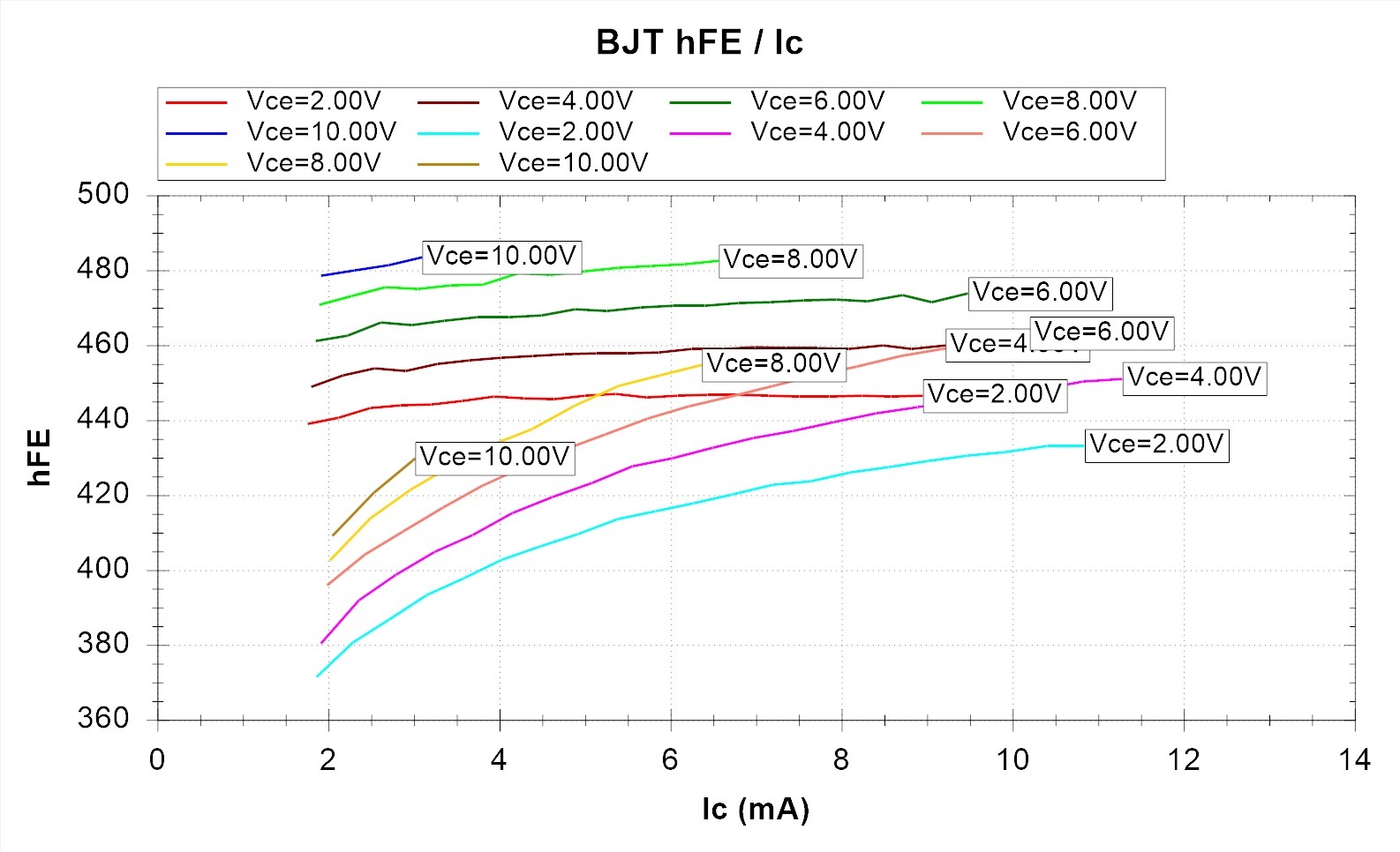

The bias current was around 4.5 volts when first measured but Q1 was a 2n3904 from factory rather than a 2n3391 as per the parts list and I wonder if the higher bias current suits the replacement transistor?
In any event changing to 560 ohms made very little difference and putting a 10k in there allowed the bias to be adjusted to spec.
Before:
V1 (30k) : 20.95k 18.9k
V2 (15K) : 41.75k 15.4k
V3 (15K) : 94.95k 53.8k
V4 (150K) : 825.5k 392k
V5 (150K) : 61.15k 22.6k
After replacing all the resistors/caps and setting the voltages, I have the new resistances above in red. This gave me some hope that not all the photocells are bad and so i had another go moving the photocells around in the cover.
I was able to adjust V1 to 30k as per the service manuals but the others, i.e. all around DS2 are not able to be adjusted to spec. DS2 is also still noticeably dimmer than DS1, even after the refresh. Measuring the voltages going into them , the DS1 has 16v on pin 8 as per the service manual spec whereas DS2 is reading 18.5v on pin 6.
I reasoned that the higher voltage was due to a lower current draw by the bulb and swapped them around, no effect. The dimmer bulb stays as DS2.
Given that the the photocells need more light to show a lower resistance and and 3 out of four (V3,V4,V5 but not V2) all seem to indicate they need to be closer to the bulb, I think the fault may be related to the circuit driving DS2.
Tracing it back to the lamp driver transistors, I have correct voltages on the bases and emitters of Qs6&Q14 but 2 volts higher on the emitter Q14, which is the channel with the dimmer bulb.
Worth pulling the transistors and testing for gain? It would mean disassembling the swinging board mechanism again... 😀
Ok... not sure what happened but as I was poking around to confirm voltages the issue somehow seemed to correct itself... The transistors remaining in their transposed positions I started probing the voltages of the components upstream of them. All voltages appeared as per the schematic and then I noticed the bulbs were now equally bright.
It seems there must have been some sort of loose connection or bad solder joint that is now good and I was able to calibrate the all photocells to resistance spec apart from V5. That one showed a low resistance (~60k) even when moved as far away as possible. It, of course, being one of the impossible obtain ones I had a flash of inspiration and coloured the front lens in with a black marker until it balanced. It still seemed to respond to light level change like the other one and so i put it back together. The instrument seems to work now, much better than before and with a much reduced warm up time.
