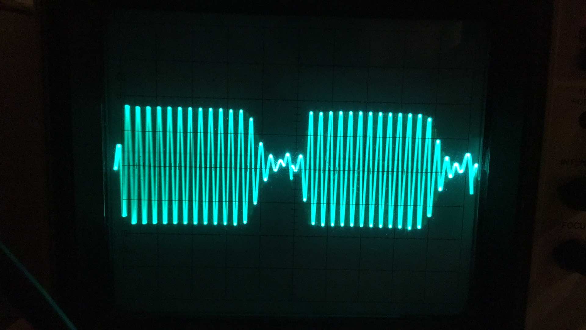

I am trying to crack down a fault with a function generator that I recently acquired: HP 203A. The output waveform has a repeated distortion (see attached picture) and this happens on every output channels and multiplier selection and frequency. I checked the supply voltages (+15 and -15) and they each have periodic ~.1V jumps every 2.5ms (see the -15V supply in attached picture).
I suspected that the Power Supply portion of the function generator is to blame so I went on and focused on it. When I lifted C2 can capacitor from the circuit and measure it's capacitance, it's value showed up as 0.1nF and slowly climbing when I should be reading 1000uF. The C1 capacitor reads 1100uF which is acceptable.

Hi - If C1 measures bad and C2 measures Ok, help me understand the reasoning you are using to replace C2. Maybe I'm missing something.
Also - If you post a picture of those C1/C2 capacitors, we may be more helpful on guiding regarding specifications.
When I lifted C1 can capacitor from the circuit and measure it's capacitance, it's value showed up as 0.1nF and slowly climbing when I should be reading 1000uF. The C2 capacitor reads 1100uF which is acceptable.
I'd start by replacing it with a similar-value cap on hand. That said, if the ripple on the supplies really is only 0.1V peak, it's unlikely to be the cause of the issues you're seeing here (although it's worth servicing the power supply to make sure it's meeting specifications before you even think about calibrating this thing).

Thanks for the info! I did temporarly replaced the cap and it did fix the main issue although there are multiple other issues that I have come across that still needs some troubleshooting. I will post these issues here when I get te time!
