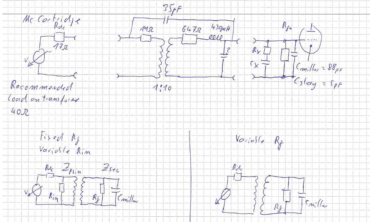

I have a nice MC step up 1:10 transformer which I will use as an input transformer of my new RIAA phono stage. The general math is clear so far but I do not know on which "side" it is wise to adjust to get the right load impedance for the MC system.
Resistor parallel at primary side.
Rg // Cmiller as impedance Zsec will be transformed as Zprim = N² * Zsec.
Now calculate the parallel resistor to retrieve the load of the MC like Rin= (Zprim * Zload)/(Zprim - Zload). For different MC systems I have to calculate/Switch different Rin on primary side.
Rg // Cmiller at secondary side.
This is in general the same. Calculating necessary impedance at secondary side Zsec = Zload / N². Then calculate Rg take Cmiller in account: Rg = (Xc * Zsec) / (XC - Zsec). Now I have to choose different Rg to get the right load of the MC system.
So what is the "right" or best way here?
The next thing is to calculate the possible zobel network. No idea here! All I know is, that it may necessary to damping the "ringing" but I do not found any hint how to calculate it or how to start with an emperimental approach.
Any hint on this toppic are warm wellcome!
Thanks a lot for all your help!

I read the linked thread....
Well done! I bow down pieter!
So, using a resistor on secondary side is the right way. I complete missed the DC resistance in my calculation. I wonder if it make sens to take the reactance of the capacity Cmiller + Ccable +Cstray in account.
But I follow the recommendation to let the Ears decide.
So now open is the question about the zobel network. If it is necessary and how to determine it ??

Thanks to Pieter´s description it´s now easy to calculate the correct load for the MC system ( or several once using a rotating switch ). As I develop the phono stage I´m free to choose the input impedance of the first tube stage.
You might be right if you want to use an external SUT. But at least this is the same story with the drawback that you are not able to increase the load to the MC above the reflected impedance which is resutled by the fix 47K input of your MM Phono stage.
Take my transformer in account this means the maximum load impedance with a fixed 47K input impedance will be 495.5 Ohm. Using a parallel resistor provide the possebility to align the load impedance below the maximum.
My transformer
Zsec = 47K
Rdc_prim = 19 Ohm
Rdc_sec = 647 Ohm
N = 10 ( 1:10)
Calculation
Radd = (N²* Rdc_prim) + Rdc_sec
Zload = (Zsec + Radd) / N²
Best Regards
Karsten
