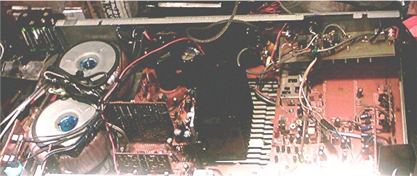

still dabble and create audio stuff, too. Here's a You Tube link to a
Technics SA-350 Restoration/VLF Retrofit that I've recently done.
YouTube - Tech SA-350 VLF Prt 1.mp4
The LM3886's idled too warm with the stock heat sink and +/-42v
power supply, so I took 2 used 20.5v, 123va toroidal transformers, a
couple new Nichicon 15,000uf, 35v electrolytics and built a very nice,
stiff +/-33v supply for that SA-350. I should be posting the video of
that power supply tweak job in a couple weeks or so.
