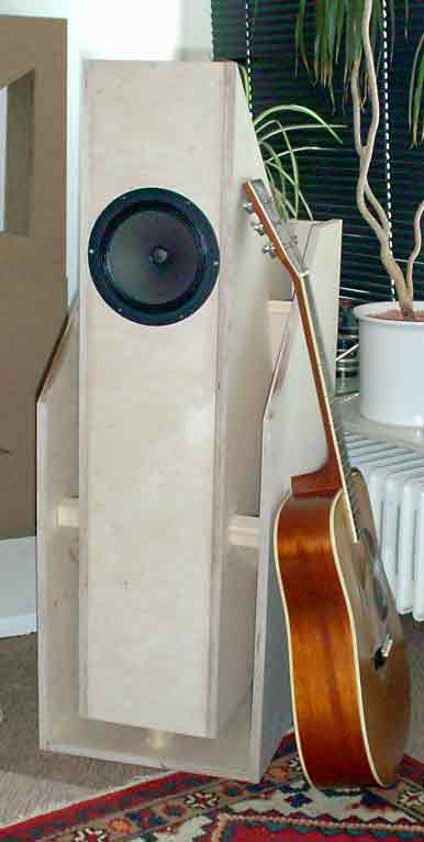

my double horns would be a good solution
to get bass and soundstage
look my SAxophon and the RDH20
audio Nirvana 8"
Fostex Fe206E
Sica 8" 38/1100
good value for the price
