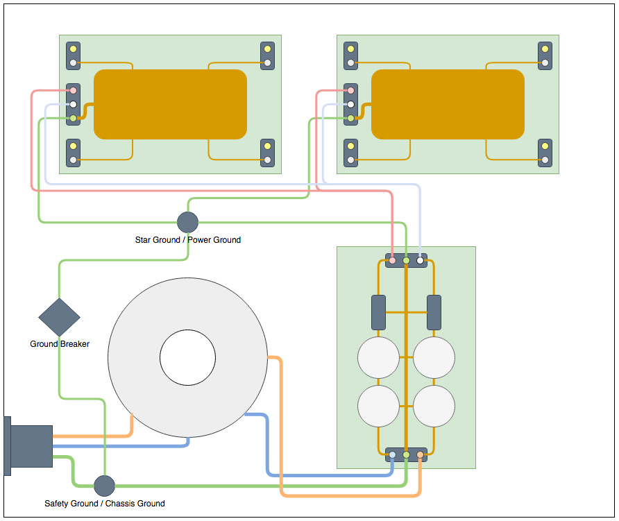

Power ground from power supply to star ground making a power ground star ground point (isolated from the chassis), star ground connected to chassis ground via a "ground loop breaker circuit". Each board connected to star ground. Is it right so far Fast Eddie D?
Next up is signal path with shield/signal return/signal reference. I removed power feeds except the ground in order to de-clutter the image. Now it I get you right Fast Eddie D. RCA connectors isolated from chassis and shields connected together and routed to in your case the volume/balance/voltage amplifier board. In my picture it is the second board but it could have been the star ground point instead (it's pretty much the same in this context).
The shield on the cables connecting the first and second board is only attached at one end. The reason this works I guess is because signal pads for inputs and outputs are already referenced by the connection to power ground on the board. I guess the signal return will also be routed this way back to the common point for signal ground, is that right Fast Eddie D?
There will only be one ground connection per board as laid out in this example, the same goes for each RCA connector, and it would be the boards power ground (or a common star ground / power ground / signal ground). Right?

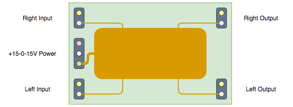

Let's see if I understand you right Fast Eddie D. I will use an imaginary preamp with more than one internal board. The board are also imaginary and I illustrate them like the picture below. They got signal and signal return/reference/ground pads for each input and output (both channels). It is single side boards with a common ground plane (signal reference connected through some copper pour/grounding scheme on board to power ground). The boards are powered by a +15-0-15V power supply.All audio grounds should return on only one end.

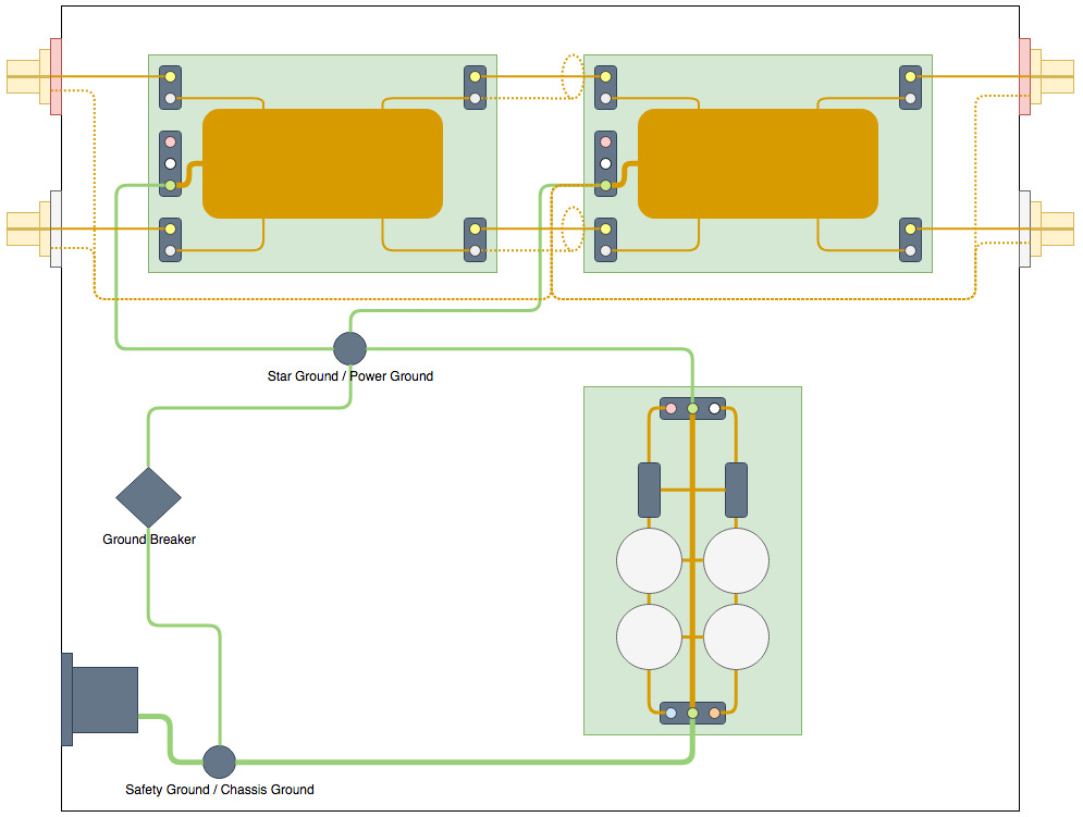

I also like a modular design. Below is a picture of the imaginary preamp with power attached to illustrate grounding scheme. AC in with safety ground firmly attached to chassis making a safety ground / chassis ground point. AC primaries are feed to a toroidal transformer and the secondaries to a power supply. Excuse my simplified drawings, no fuses and rectifier diodes etc. (it's all imaginary so you have to imagine them your self). I am just trying to highlight the ground path.I use modular designs for line level circuits so I can mix and match tried and true boards. The grounds on the boards are well parsed, and every board returns to ground in only one place - on the volume/balance/voltage amplifier board, right by the volume control ground. All RCA jacks return ground to this point as well. The power ground goes only to this board. The digital control board is grounded only at the power supply board. This is the only place the digital (noisy) and audio ground meet.
The signal flow and return should always be close coupled. Also you've shown the power supply 0V connected directly to the chassis

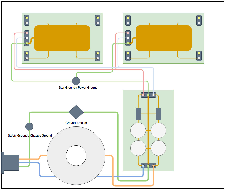

That is true! 😱 What about this instead?Also you've shown the power supply 0V connected directly to the chassis

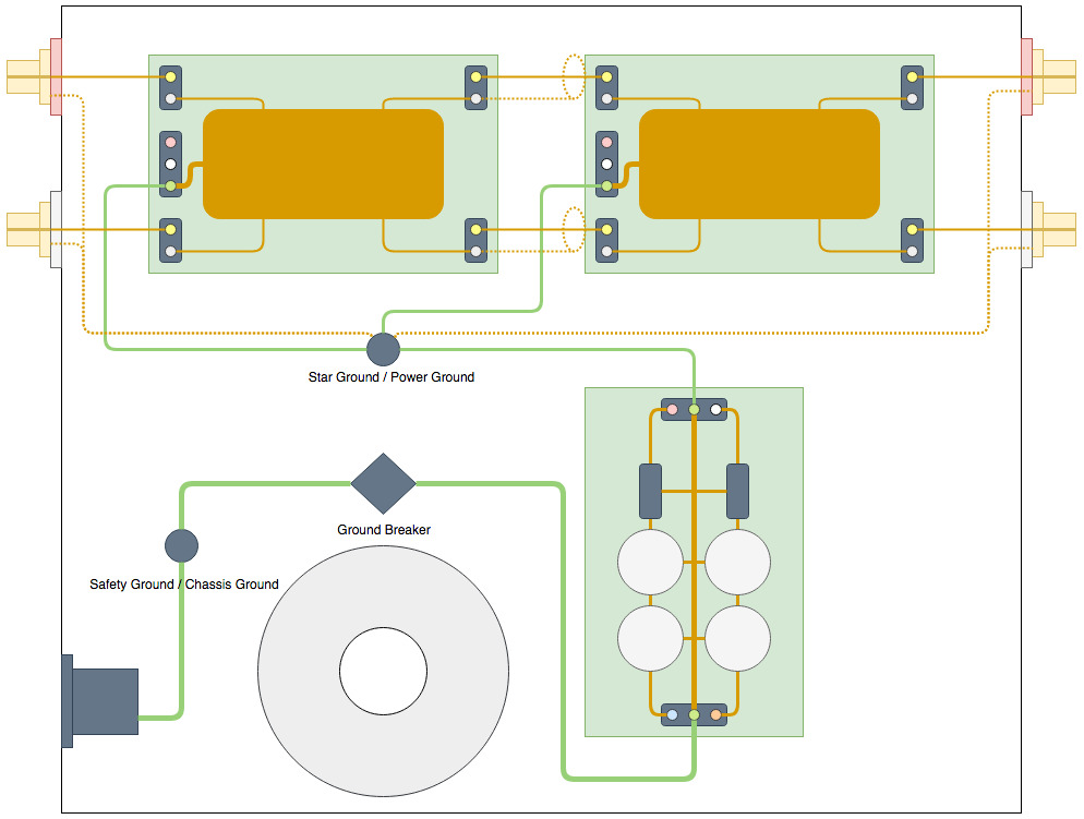

I routed the RCA input and output shields/returns/referenses via star ground instead of the "volume/balance/voltage amplifier board" à la Fast Eddie D.
Still curious if this is a good representation of what Fast Eddie D was laying out? Shield between boards connected at only one end and with signal referenced and returned via each boards 0V wire to star ground (or directly to star ground for the barrels of the RCA connectors)?
