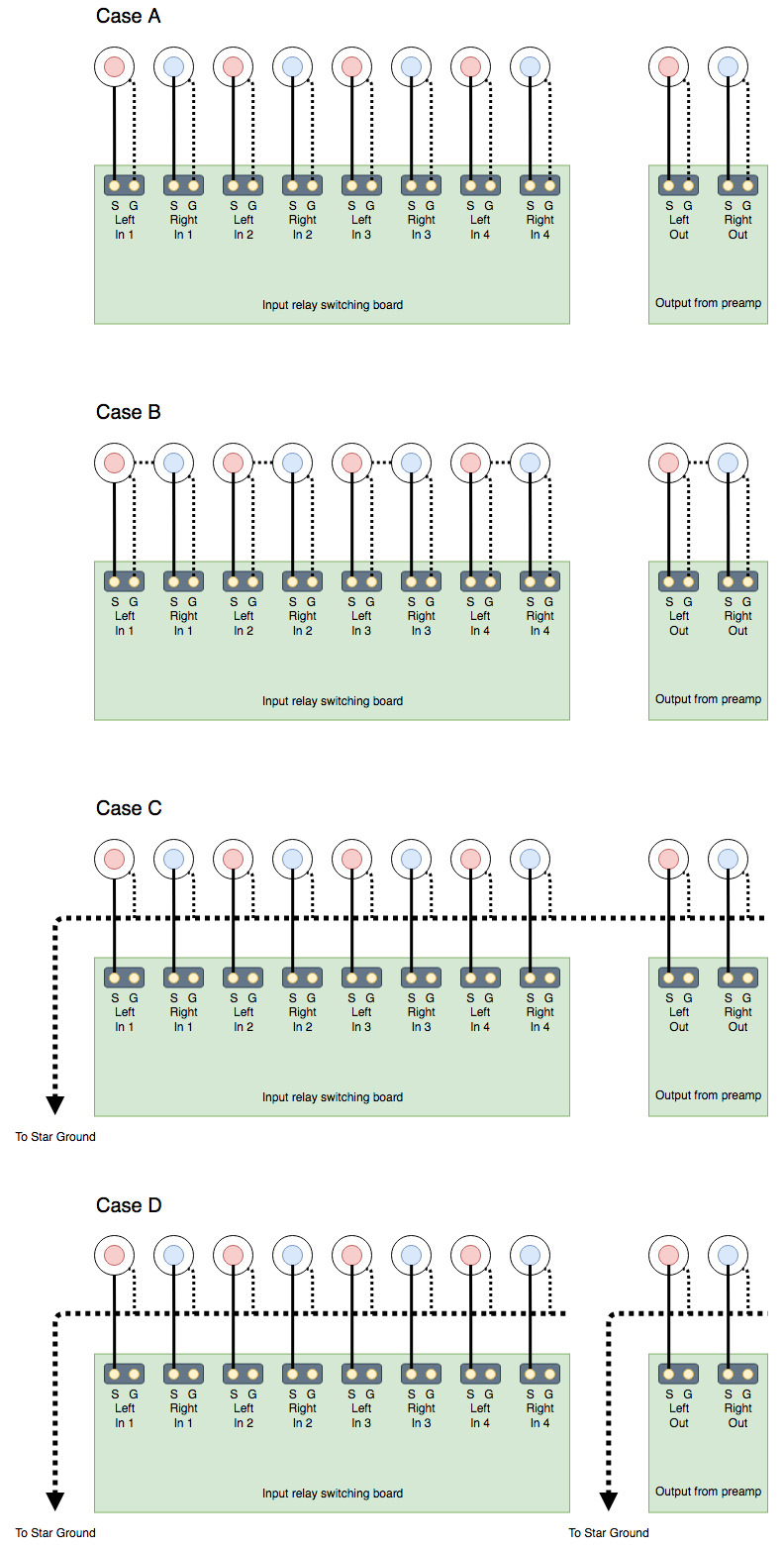

I have made a little sketch of an imaginary preamp. It got several boards inside where signals enter trough a relay based switching board. Each of the four inputs on the switching board got signal and ground connectors for each channel. The signal is switched and dispatched to another card with input buffers, yet another for filters and volume control etc. The signal is finally exiting through some output buffers on the board with the preamp outputs. I have outlined four different cases (based on information I have stumbled upon), A to D, as in the sketch attached below.
Case A, each input is connected separately to each input and output, the signal return and ground is probably carried in the shield of a shielded wire or as one of the leads in a twisted pair.
Case B, just as Case A but the RCA barrels of each couple of input and the output has been connected together.
Case C, is using a piece of wire as a ground bus shared by all inputs and outputs. The RCA ground bus connected to star ground and I assume any shield on the input and output cables terminated close to the RCA connector and not connected to the RCA ground bus.
Case D, just as Case C but with separate RCA ground buses for input and output.
Assumptions; all input and outputs are unbalanced, case connected to safety ground, RCA connectors isolated from the case, star ground available and connected to safety ground, all powered boards connected with power ground to star ground. Some boards with signal ground connected to power ground through a common ground plane on single side PCBs.
I know it would depend on the general grounding scheme and the design of the boards but in general, which one (A to D) would you prefer and why? If none of them what would you change and why?

Case B because any cross-channel ground loops are kept within the preamp where they can be addressed
Thanks scottjoplin, that's how I done it but I would like to know if there is a better way (since I stumbled upon more than one way to do it)? And why if it does...Case B because any cross-channel ground loops are kept within the preamp where they can be addressed
There is generally no issues either way as there should be no current flowing to produce earth loop hum.
A (or a variation on B) would be interesting if you are either planning on switching both signal and ground (which can avoid ground loops involving multiple earthed source devices) or using balanced input stages to accommodate unbalanced signals as suggested by Bruno Putzeys. Something that, incidentally, I would definitely recommend looking at.
Many commercial designs are using a variation on C, mounting the jacks to the back panel serving as a star ground point. This avoids having to RF couple each single input ground to case (that's a lot of hand-soldered ceramic caps, potentially) and does well at not letting RF leak in.
Neil Muncy (RIP) explained this almost 25 years ago. The shield/shell of any unbalanced interconnect circuit needs to be directly connected to the chassis.

So what you say is that the RCA connectors should NOT be isolated from the case and that the shield/ground/signal return (of unbalanced) should go to safety ground through the case (instead of via star ground), is that right?Neil Muncy (RIP) explained this almost 25 years ago. The shield/shell of any unbalanced interconnect circuit needs to be directly connected to the chassis.

I keep mine separate from the chassis, mounted close together with the grounds connected at the connectors. Power supply ground is also separate from the chassis/safety ground.

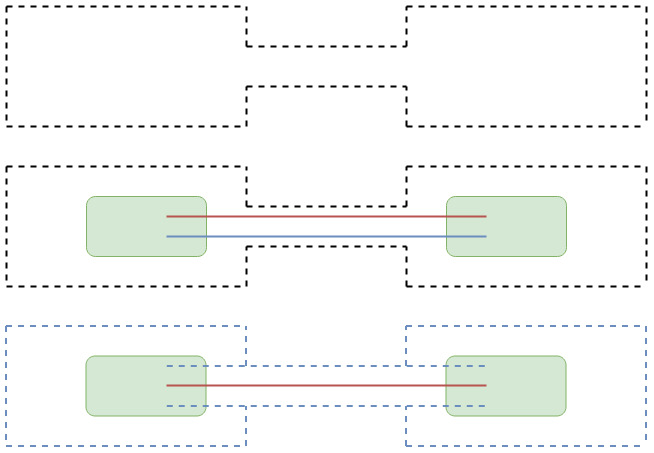

I have made a couple of new sketches. The first one, shield and earth in general.
The top sketch representing the schoolbook example of two closures where the shield of an interconnecting cable makes it into "one" shielded enclosure.
This is easy to grasp if you use for example a shielded twisted pair for unbalanced as in the next sketch. The shield can be attached to the enclosure and whatever earth potential it represents. The signal return has its own cable and can be attached to signal ground. Wherever they meet is another question.
But what about RCA connectors? They only got two pins so signal return and shield must be combined as in the last sketch making the enclosures signal ground, right?

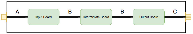

I have read all kind of statements and recommendations about the shield, mostly in the context of interconnect wires between enclosures (I have had a hard time finding material about internal wiring). Terminate it at both ends vs. leave one end floating etc. A common recommendation seems to be - connect both ends on inputs and only one end at outputs. If only one end is connected, connect it closest to the source etc. If the shield is efficient or not with one end floating is a question of its own but I would like answers to another set of questions. This talk about leaving one end unconnected, where does it apply? Have a look at the sketch below. It represents an imaginary preamp with RCA connectors for unbalanced inputs and outputs.
What about the input cabling (A in the sketch), shield connected at both ends or just one end? Connected to what if connected?
What about the internal cabling (B in the sketch), shield connected at both ends or just one end? Connected to what if connected?
What about the output cabling (C in the sketch), shield connected at both ends or just one end? Connected to what if connected?
There is generally no need to use shielding inside a metal enclose so long as the external cable shields are terminated for RF where they enter. Have you read this? Audio Component Grounding and Interconnection I think it will answer most of your other questions

I bet you actually wired it differently and created a ground loop. Typically shielded cable is connected at one end only.

All audio grounds should return on only one end.

You can't have "one end only" with coax - there are only two conductors in your cable - are you going to delete the signal reference at one end so you can leave the shield open at one end? How does your signal get to the other side?
Barring that impossibility, you can use shielded twisted pair and then connect the shield at only one end, but I'd prefer to connect the "open shield end" with a small RF grade capacitor (100nF or so) to the remote side chassis to make an RF ground. This is known as a "hybrid ground" system and it will do well to knock down RF but it will still leave the shield open at low frequencies.
A still better idea is to use a balanced, differential signal connection where there are two shielded signal wires of equal impedance, each carrying equal and opposite voltages and currents between the two devices. In this way, the net signal current between the two devices is zero, because the equal and opposite signals cancel completely. Since a net zero signal current is sourced to the remote device, and a net zero signal current is consumed by the remote device, the push pull signals completely cancel, and any ground connection between the two devices carries zero signal current.
In this case, it makes sense to connect ground solidly at each end of the connection - at this point, the shield (and ground) carries no signal current, and it behaves like a large chassis that encloses the entire system. With this structure, any additional metal added to the ground system, such as cable braid or additional chassis metal, will only serve to reduce the impedance of the "chassis" around the system, so it should be exploited as much as possible.
