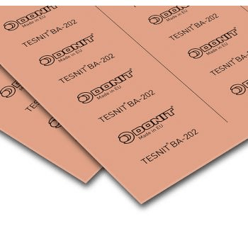

I did say:
"Any thick slightly soft material will do."
Alternately, rubber sheets, softer than tread rubber, bitumen washers, silicon caulk, whatever is handy.
For me, gasket paper is handy, and in fact here too asbestos roofing sheets are out of production.
Did not check the composition for gasket paper. Used to have asbestos, 20 years back.
3 mm thick, we cut with a chisel, no power tools or powder flying about. Draw shape with marker, chisel is an old HSS tap, and a 1 kilo hammer.
Simple...
Water gasket sheet sample.
This is what I have handy, locally made Champion brand, or similar.

Stick the shield back on the transformer, and as for foam, the transformer can get hot, so use automotive grade heat resistant material.Or alternates, as described above.
Shield is more for EMI shielding than noise absorber, check for continuity with chassis after fitting.
And check if the unit has an Earth connection, if yes, then transformer shield to Earth must be continuous.
Could be the transformer is having resonance with the body.
Also, if you took pictures, put it back in the same orientation.
If the noise is mild, leave it alone, the varnish will fill the gaps in a few warm cold cycles.
