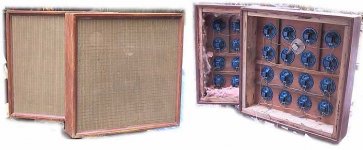

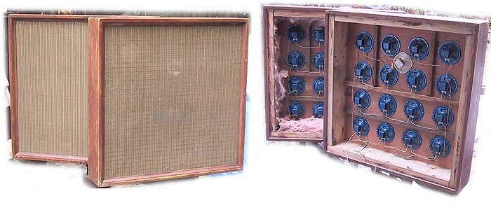

Anyone old enough to remember the Sweet Sixteen?
I was a kid when the article came out, but had a pr go thru here.
dave
