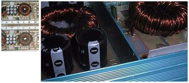

How Works upper volt in car Amplifier???
Disabled Account
Joined 2002
i need it in Circuit and image
(the upper volt is up from 12V in the car AMPLIFIER to high volts (30V + )
thanks alll !!!!!!!!!!!!....
It's a special powerssupply called "switchmode". The basic idea is that you generate an AC wave from the car's battery DC, increase it's voltage via a (usually small) transformer and then rectify it again with a diode bridge to get DC again, but at a higher voltage. Usually the AC wave is square and high frequency, so the efficiency of this kind of circuits it's rather high (90% is not uncommon), yet, they're NOT trivial to design or build.
