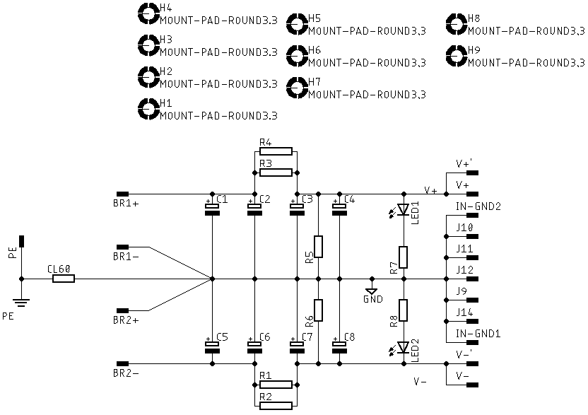

How useful do people find a CCRCC psu for class A amps?
I think this is a regular PSU, as you also can find in PASS LAPS AMP i.e F7..Very close
So what does the CCRCC mean.. No need to place that circuit again, it does not explain the C C R C C.
And I can assure you I really don't know.. Even USING GOOGLE *which I'm not a friend off* sends me to a Aircraft site named CCRCC, and they using PSU named CCRCC for their Radio Equippment. But only 7.6 Volts.. and with this you will not be able to Power on a Class A Outputstage.. OH BTW I'm not actually a Friend of Google, so no Vote for this Question. enjoy weekend..

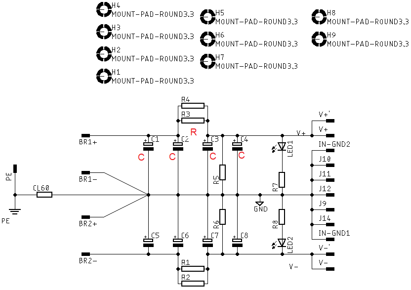

What I suspected, that is not CCRCC (which makes no sense) but plain old CRC.
C, R, L, etc. indicate filter elements, and , say, C1+C2 count as *one*, C3 and C4 again as one, and so on.
By the same token, R3 + R4 too count as 1, as so on.
EDIT:this also answers Avtech´s post.
i thought it should have been clear once i posted the schema, what i really meant.
i didnt want people to visit an aircraft manufacturing site and question themselves whether google is their friend & be confused....
Yes its CRC (no aircraft technology). The simple reason is, more often than not, i have seen people piggy back resistors to arrive at appropriate value(being light in weight). whereas big bulky 35-40mm dia-4 pin /5-pin caps, are used in row and are stuck to the bottom upside down or held down by some other measures. So I thought if people would be in a simple diy pcb (home etched) to make it convenient....Ah, forget it...

Hello Jeffrey,
just had a look at diyastore board and mine would have been same as diya board, except for
1. no on-board rectifiers,
2. may be somewhat larger cap dia (40mm),
3. with more pitch options 10mm/22.5mm/25mm
4. i was thinking slimmer profile ~100mm X~200mm
but I am no longer interested in making it, as it seemed to attract all manner of comments not conducive for "making something for the forum and members". ..
