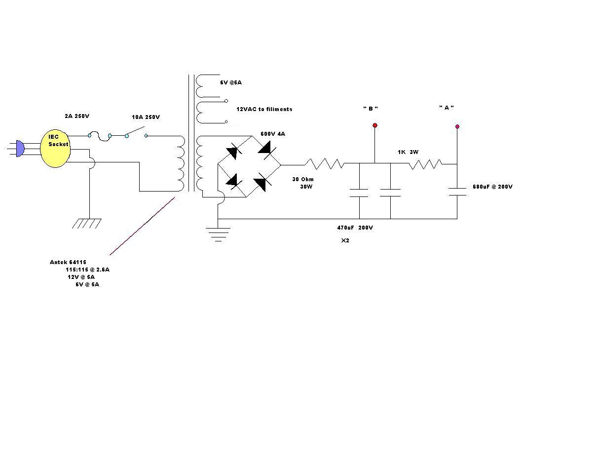

So then it would be easier (relatively) and safer to convert from 2 wire to 3 wire?

In some countries, it's illegal not to have ELCB. Any ideas why it's illlegal in this country and how is an ELCB dangerous?
The ELCB itself is legal; in fact required to be used here (in CA, US) on all circuits serving moist environments etc.
Adding an ELCB to an autotransformer connection as shown in post #1 does not make it safe or legal, or even render it functional.

What type of sheath, if any, on this cable? Is it an armoured cable or just USE/SE (gray jacket). National Code is most clear, and has been for at least 50 years, on bonding standards for service entrance. California Code has not taken exception to the NEC 250 section.
The utility always (not usually) bonds their neutral at the pole (or padmount, or vault) transformer. The ground is typically not carried through from transformer to service entrance, however- just the phase and neutral conductors (google messenger supported wiring). A separate rod system (there are many options) is required to generate a unique ground grid for the house. Most of us recognize this as two ground rods, though only one is required when under 25 ohms (electricians can't measure rod resistance, so they by default install two). Water main, if available, is to be bonded to this unique grid, though there are some changes to this requirement that are outside the scope of this thread.
Point being you will not have a common ground with the utility, but you do absolutely need a ground.
There is an additional required (not optional) bond at the customer's service entrance. This bond might be as simple as a green screw driven from the neutral bus into the back of the panel, but it needs to be there. Sometimes there is an additional bond in the meter socket, but that's maintained by the utility.
Now if your 200A panel is not considered service entrance, as might be the case for multi-family dwellings, you will not have the neutral bonded at your panel. But you still need a separate ground conductor going back to a grid, wherever it may be. It is possible an armoured jacket is being used for your ground. There must be something; the use of the conduit for an approved ground has disappeared from the Code quite a while back, and I doubt in a newer home you refer to that any conduit is being used at all.

It's grey plastic up (def not armoured ) from the slab and no other single heavy gauge to be seen.
