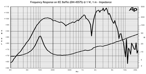

I am guessing that the resonances will only appear once a certain sound pressure level is achieved - cranked with resonance for lead, no resonance for clean rhythm or ambient.
Back when I was repairing guitar amps it seemed like very few were even close to flat and some couldn't be made flat with any settings.
When your speaker looks like the enclosed graph, how flat can your amp be?

And EV is considered a "mild/flat" speaker by Electric Guitar standards, and is much preferred by Jazz and Fussion players for its "smooth" sound, closer to a PA speaker than to a Guitar one.
This is the response curve of a Jensen P12N , the classic "Fender Speaker" and fitted to the early Twin Amps (even before they became Twin Reverb) and as American as apple pie:
Alnico magnet of course 😉
Such response is exaggerated because of typical guitar amp low damping factor (1) , and doubly so in amps with no feedback which are very popular.
Pentode outputs turn them into practically constant current sources, so adding a built-in EQ boost following the impedance curve as seen above: notice the strong resonance peak at 100Hz and the rising impedance at 6dB/oct from 400Hz up which are equivalent to fully rising the 100Hz band in a Graphic EQ plus setting the treble control to full, with a low turnover frequency of 400 Hz.
