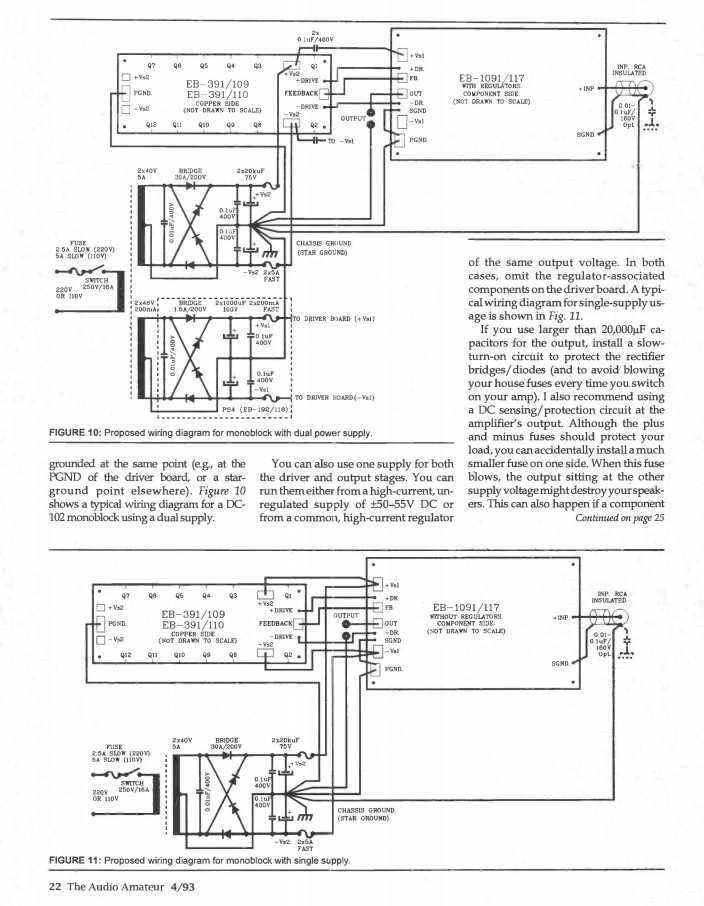

_Please, do publish schematics ( lesser text ) and on those be clear about the physical implementation, give typical wire lenghts. Do not assume all that is obvious to you, goes obvious to readers.
Nothing new, but scattered here and there, reinvented over and over, in various ways. I wish you end up with THE reference way to do it, for Class AB audio amplifiers, once and for all.

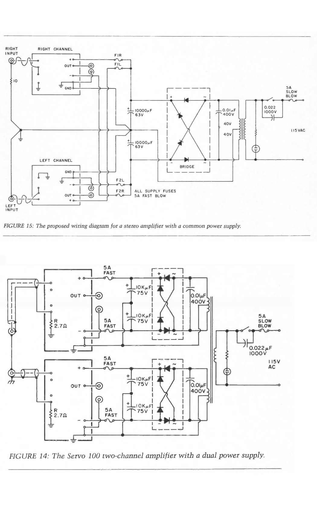

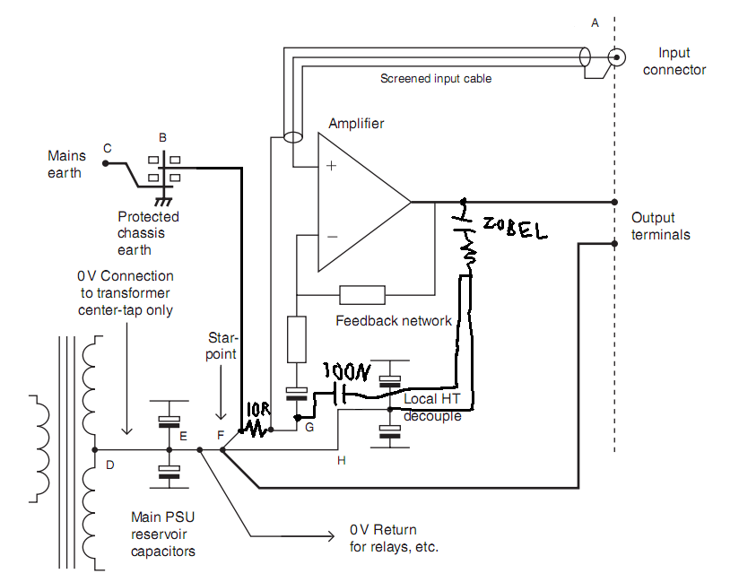

I read Douglas Self's section again that relates to that graphic. He does recommend a connection from the star point to the mains/chassis ground. It's just not shown in the graphic.
In APAD6 he wrote:
Mains/chassis ground will need to be connected to the power amplifier at some point. Do not do this at the transformer centre-tap as this is spaced away from the input ground voltage by the return charging pulses, and will create severe ground loop hum when the input ground is connected to mains ground through another piece of equipment. Connecting mains ground to the star-point is better, as the charging pulses are excluded, but the track resistance between input ground and star will carry any ground loop currents and induce a buzz. Connecting mains ground to the input ground gives maximal immunity against ground loops.
Quite correct. An HBR will help here, or his proposed method shown in the posted graphic a bit earlier.
But, he says very little about cross channel ground loops which I think are the most pernicious IMV.
Hear, hear. Bonsai's presentation already includes a layout that is probably good enough for most amps. This thread started because I proposed my layout and Bonsai wanted to move the discussion to a new thread. So really this is the research stage, I'm not 100% sure about my layout, hence the discussion.

Sorry, I meant the cap marked 100n
That is the correct cap.
In your diagram, Self would argue you have any externally generated ground loop current across the 10R resistor
So you are saying the noise voltage between point F and board 0V causes a voltage drop across the 100nF cap and 10R resistor? That is correct. But, by your own admission the ratio of the currents through a 5mohm umbilical and the 10R resistor will be 2000:1. Add to that the capacitor, and you get an even smaller current, and only above audio frequencies.
I am still thinking about the capacitor. Not sure whether it's really necessary or whether it's the best way to address the problem.
