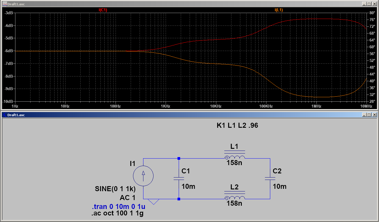

There are a lot of comments to the effect that the local decoupling on an amp PCB prevents PSU return currents from going through the power umbilical. This logic makes the mistake of thinking that a capacitor has less impedance than a twisted pair (only at RF, and even then not necessarily as much as you think). In reality, even if you load the PCB with capacitance, you will usually not reduce the umbilical currents to less than half.

Why don't you sim it and put it up so we can discuss it?
I think you are correct at LF, but the situation changes quickly once you get above 1kHz and up at 10 kHz, with decent on-board decoupling, most of the speaker current will be getting supplied by the local decoupling loops.
This simply reinforces the case for good layout, good decoupling, twisting wires and making sure you terminate the speaker return back at the amp module and not the PSU 0V in order to control the loop areas.
If you are trying to build amplifiers >> -100 dB noise I don't think you can assume anything.
I don't need to simulate to know that the 1KHz capacitive reactance of a 10mF capacitor without ESR is 15.9mohms, and the resistance of a foot of 14ga wire is 2.5mohms. And that calculator gives 6.23nH per inch for a 14ga twisted pair.
With 10mF 12nH 10mohm ESR on both sides of the umbilical, the current wants to split evenly between the two capacitors. 6 inches of 14ga twisted pair reduces this by a whopping 1db.
I don’t get the sim results you do but then my model is a bit more complex. Above 1 kHz, on board decoupling provides benefits by localizing the loop and that improves with frequency.
My comments about good layout, good, wideband local decoupling, twisting wires etc still stand.
I am hung up on taking your results to their logical conclusion: don’t bother about local on board decoupling. If you can explain how to get away with that in a practical amplifier where the PSau and amp modules are separated, I’m all ears.
