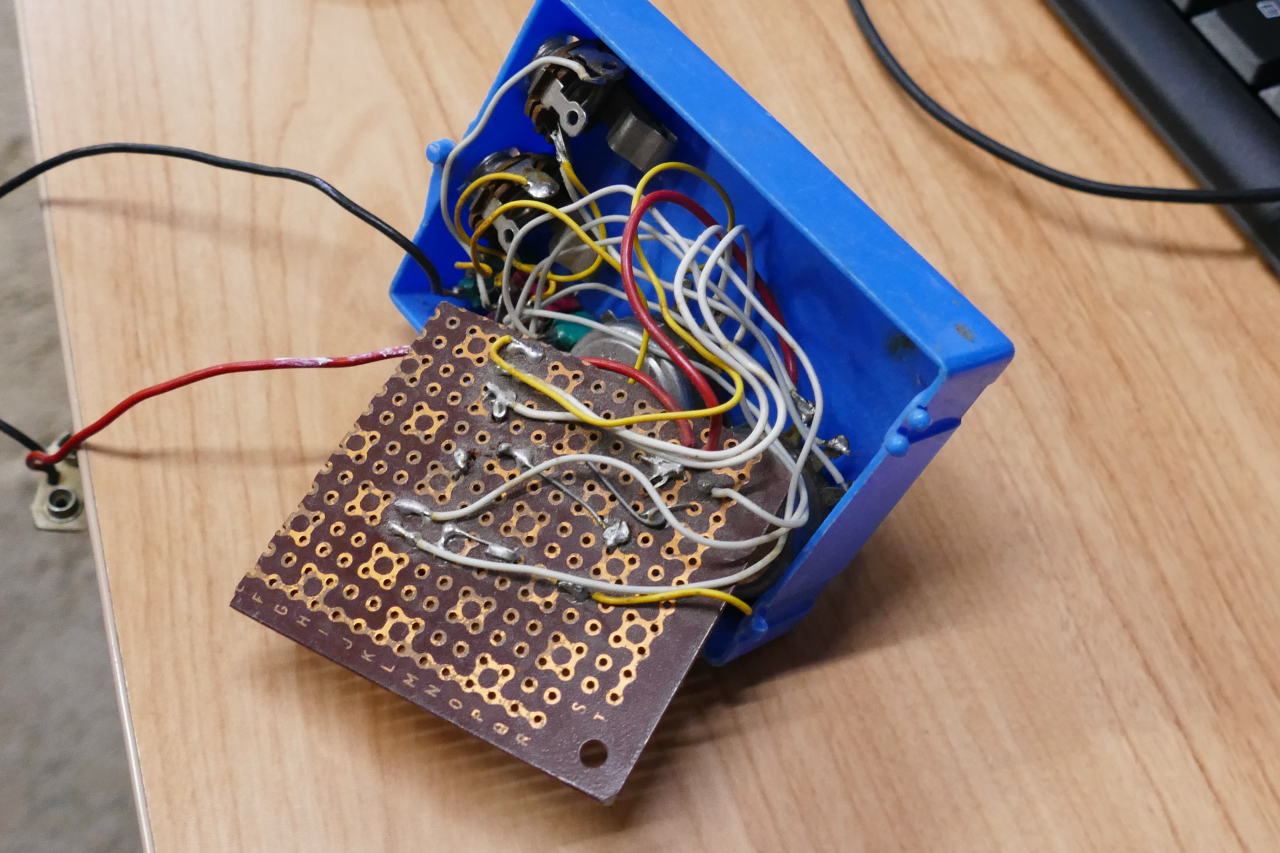

I was digging through boxes that were packed during a rushed move out of Florida over 5 years ago when I found the oldest yet relic from my childhood....the DIY germanium fuzz.
This had to be made when I was in middle school, 11 to 13 years old. Its transistors were selected from my junk box for best tone with my crappy guitar. This one went into the junk box when I got a Hagstrom in high school. It did not have a foot switch since DPDT footswitches were not common in 1960's junk. The second one had a relay operated by a SPST footswitch.

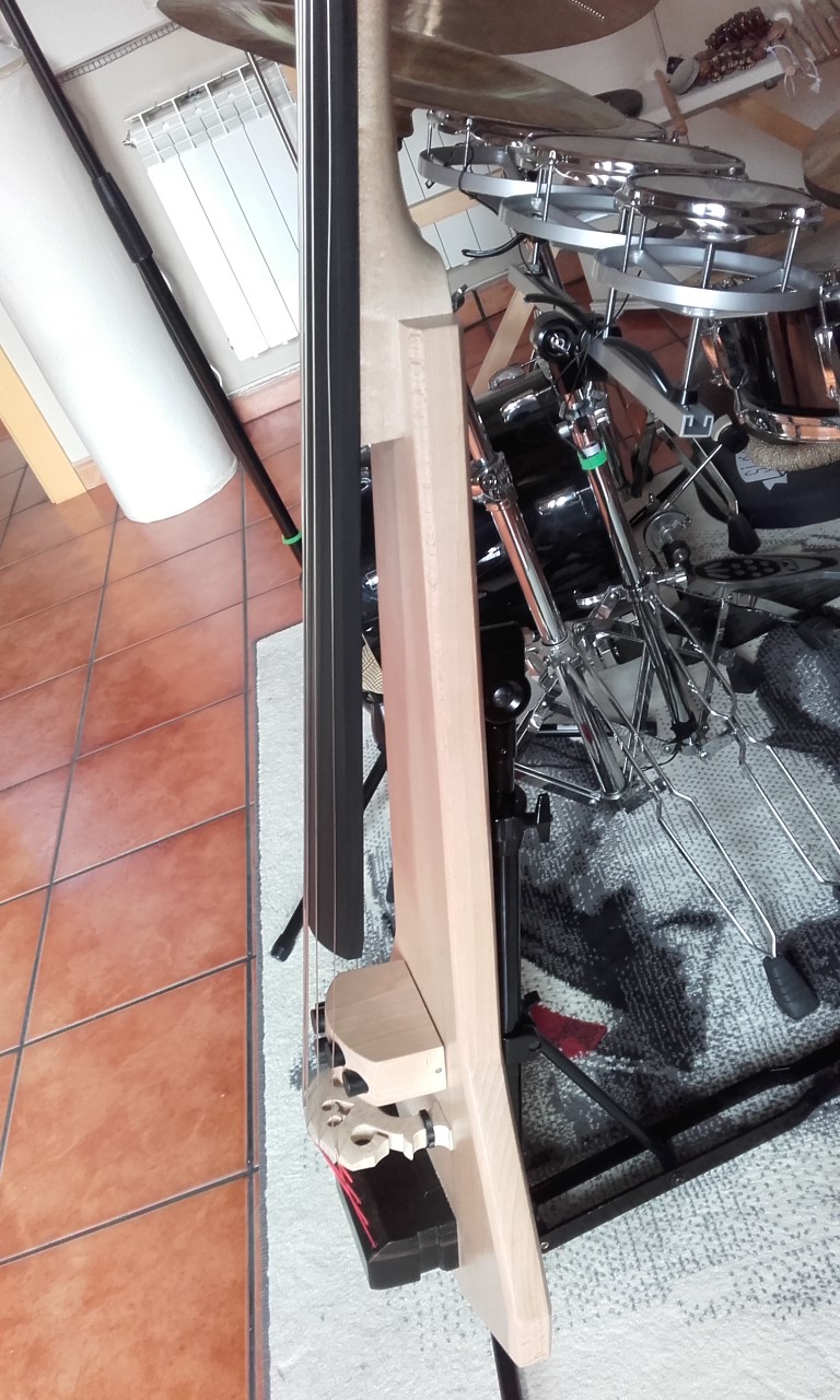

weltersys, thanks for asking. I promised photos but I haven't posted any yet. Ill try to do it asap.
I connected the magnetic pickups in parallel and it works great, in combination with the piezo. I just moved the magnetic further away from the bridge because the sound was too bright overall. (cosmetically disappointing because now the cable can be seen going into a hole in the wood where the pickup used to sit)
Now the piezo provides the brightness and the nuances from the fingers and the magnetic a solid body to the notes.
My main instrument is the sax. I've just recently taken up guitar and bass, so I'm a total newbie. I have been lowering the action progresivelly to where I feel comfortable, so some notes on the mid to high end of the fretboard are buzzy. But I'm learning a lot and am totally happy with my creation.
Photo coming soon.

A couple pics as promised:

VERY Nice looking instrument. What's the body made from? It seems thin enough that warpage might be a problem...
Look where the drummer has his china mounted - and the hanging metal. I can only imagine the music you guys play!
I agree, nicely done!

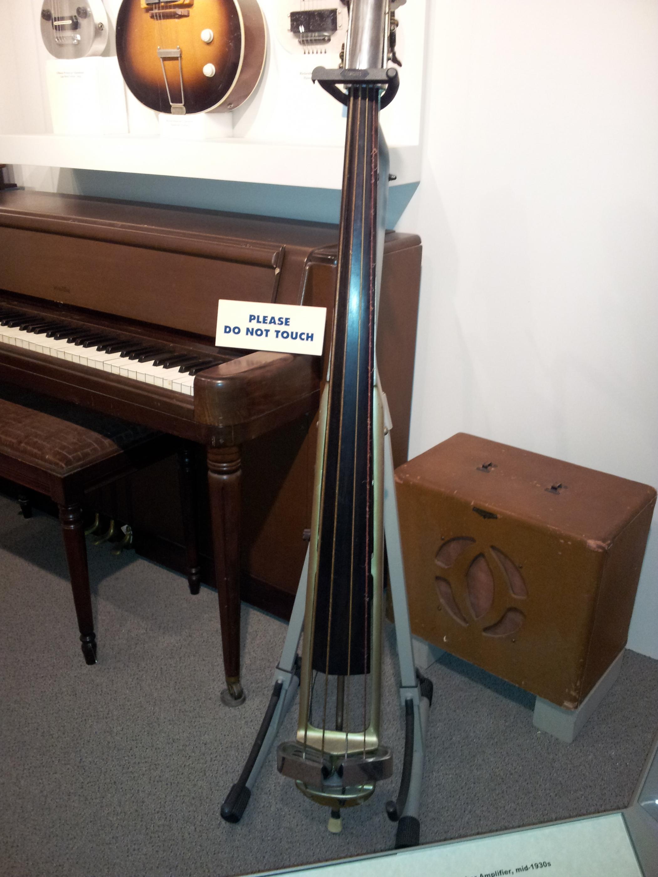

I remember watching a Pink Floyd video in which Guy Pratt was playing an upright electric bass that looks very similar, but I can't seem to locate an image online to confirm that memory.
The two attached images are of early (1930s) production electric upright basses by Ro-Pat-In (later changed to Rickenbacker) and by Vega. The Rickenbacker has a double-horseshoe pickup that appears to be a very similar design to the groundbreaking one George Beauchamp designed for their 1931 "Frying pan" electric slide guitar.

Thanks for the compliments. the null is inside the wooden pickup case. It has no magnet that I can tell and will pick up no sound at all.
The body is maple, like the neck. I figured the overall shape and thickness from some photos of Eberhard Weber's bass. It holds the intonation well enough for me.
By the way, the action is pretty low and comfortable right now and only the octave point on the fingerboard is buzzy. I am afraid to start sanding it in case I mess up.
