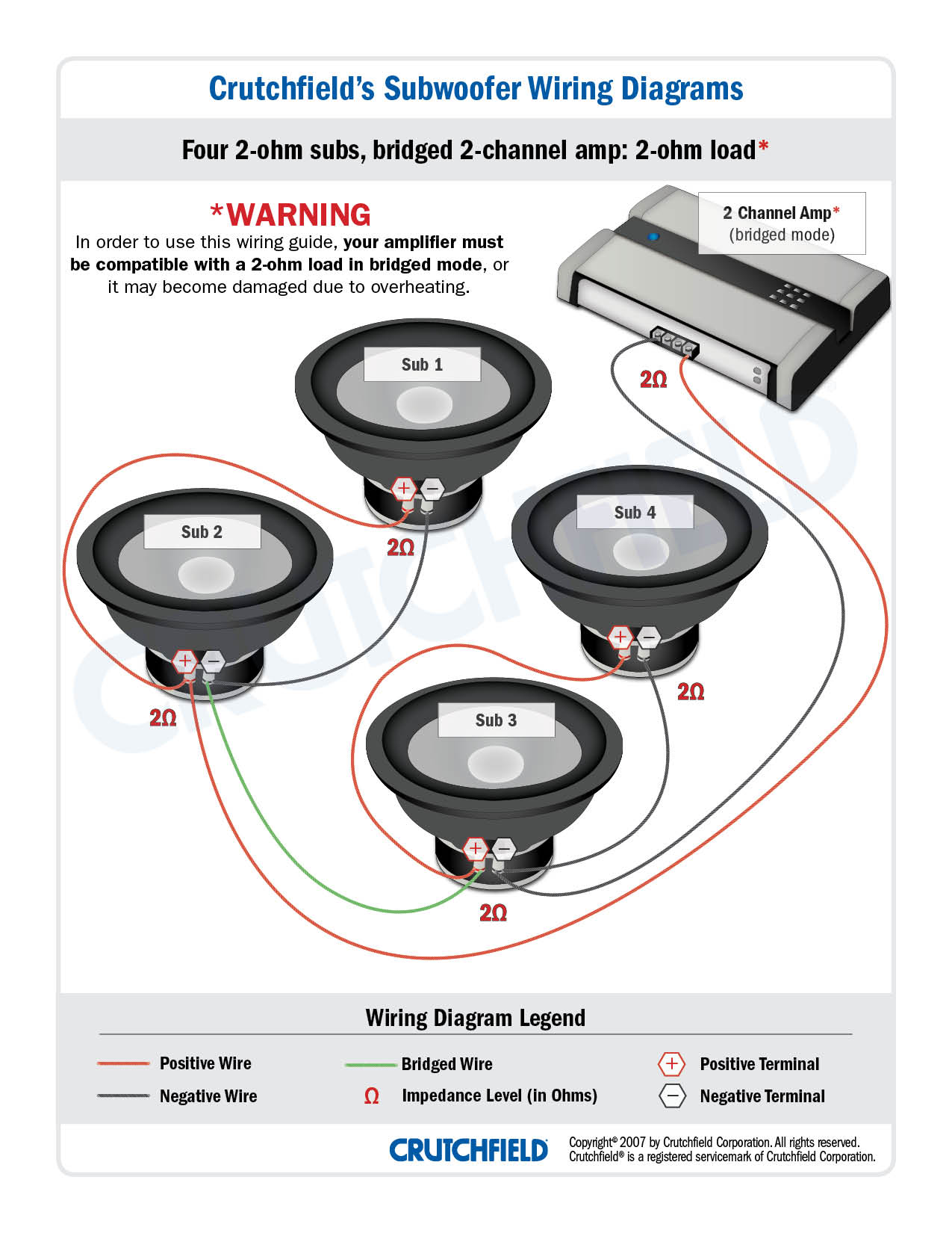

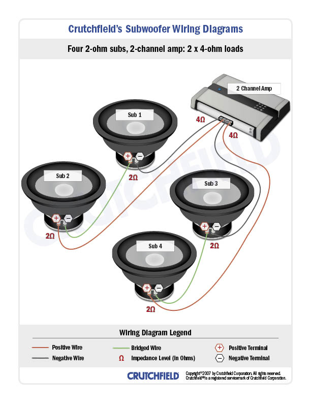

Ok. After doing more research I found the infinity reference 6832 are 3ohm which is why I'm seeing 5.7ohm-6ohm on each channel. They punch very hard at 24volume (max 35) and the amp shows very little heat after several hours of trap music. Does copper coated aluminum 18ga wire add any resistance that im not seeing? If I wire them up in the pic this will put a 3ohm load on the amp right? will it worker harder or more efficient?
First pic is my current wire up and second pic is the wire I'm thinking of trying.
The diagram you have posted it for subs. If you wire your door speakers like that you won't have stereo. If you just wire each pair in parallel you will have 1.5 ohms - TOO low! Leave them as they are.
If you don't have them already you next need a crossover to remove the low bass from the doors ( this can be a capacitor , or your amp or headunit may have one built in ) and a sub to do the bass properly.
