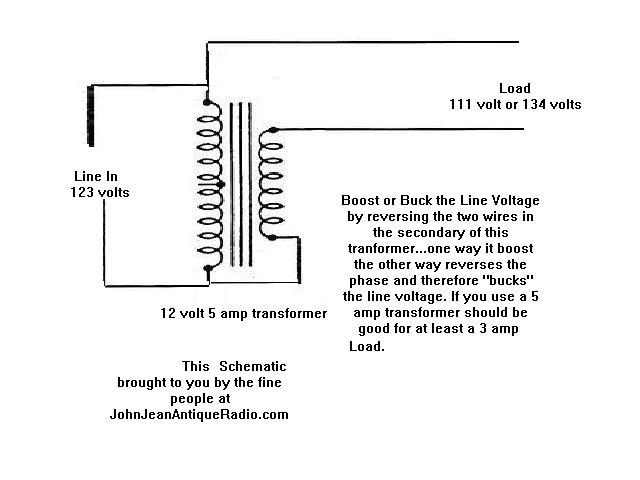

Regardless, none of those diagrams match the buck wiring that I use, which is input mains to primary, output mains connected to input neutral, then output live via secondary in series from input live.
I'll try to post a picture later.

The diagram - as promised, dug up on the internet.
You should assume neutral is on the top and live is on the bottom. It doesn't matter of course, just a little safer to take some off the live and leave the neutral alone if you end up touching it one day.
Simply the secondary in series with the line, adding or subtracting it's voltage.
QED
QED
