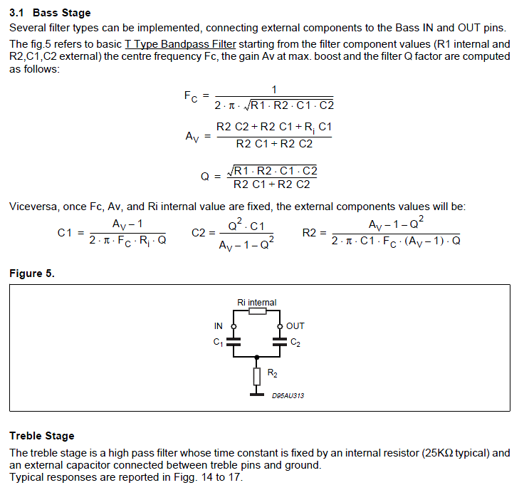

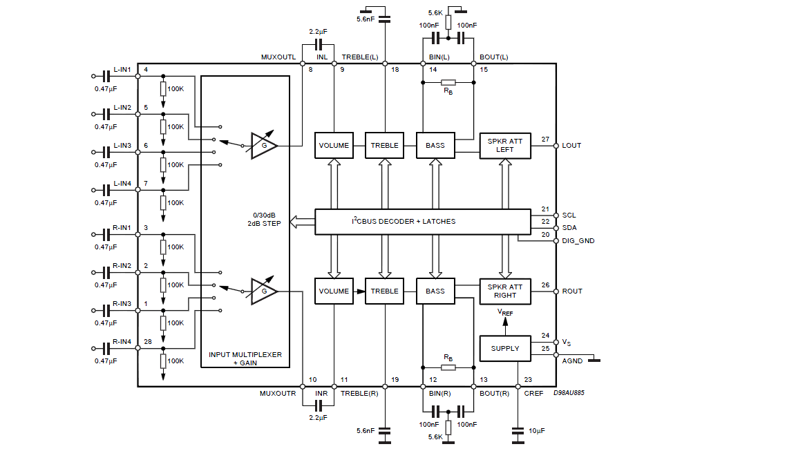

I'll try to explain it better. Each channel has its own filters.
- If I adjust something (eg bass, both left and right will adjust together - I can't address left or right channel only). Only both at the same time
-I would like to use one half of the chip for center speaker and the second half for a subwoofer.
That mean that I have to somehow bypass or modify the:
-lowpass filter for the channel that will be used for the center speaker (as I don't want to feed the center speakers with bass)
-highpass filter for the subwoofer channel (as I don't want to feed the subwoofer with trebles)
The schematic is from TDA7440 (not 7439) to make it easier (7439 has an extra midpass filter, which is identical to the lowpass filter, only with different values of the capacitors)
The question might sound stupid, but if I remove the capacitor connected to the treble section, will the highpass filter stop working? (For the subwoofer channel) and if I remove the capacitors for the low pass filter and connect it with wire, will it work? (for the center speaker channel)
Or is it better leave it as it is and add another filters after (or before?) the TDA chip to filter the signal further (lowpass and highpass with op-amp)?
