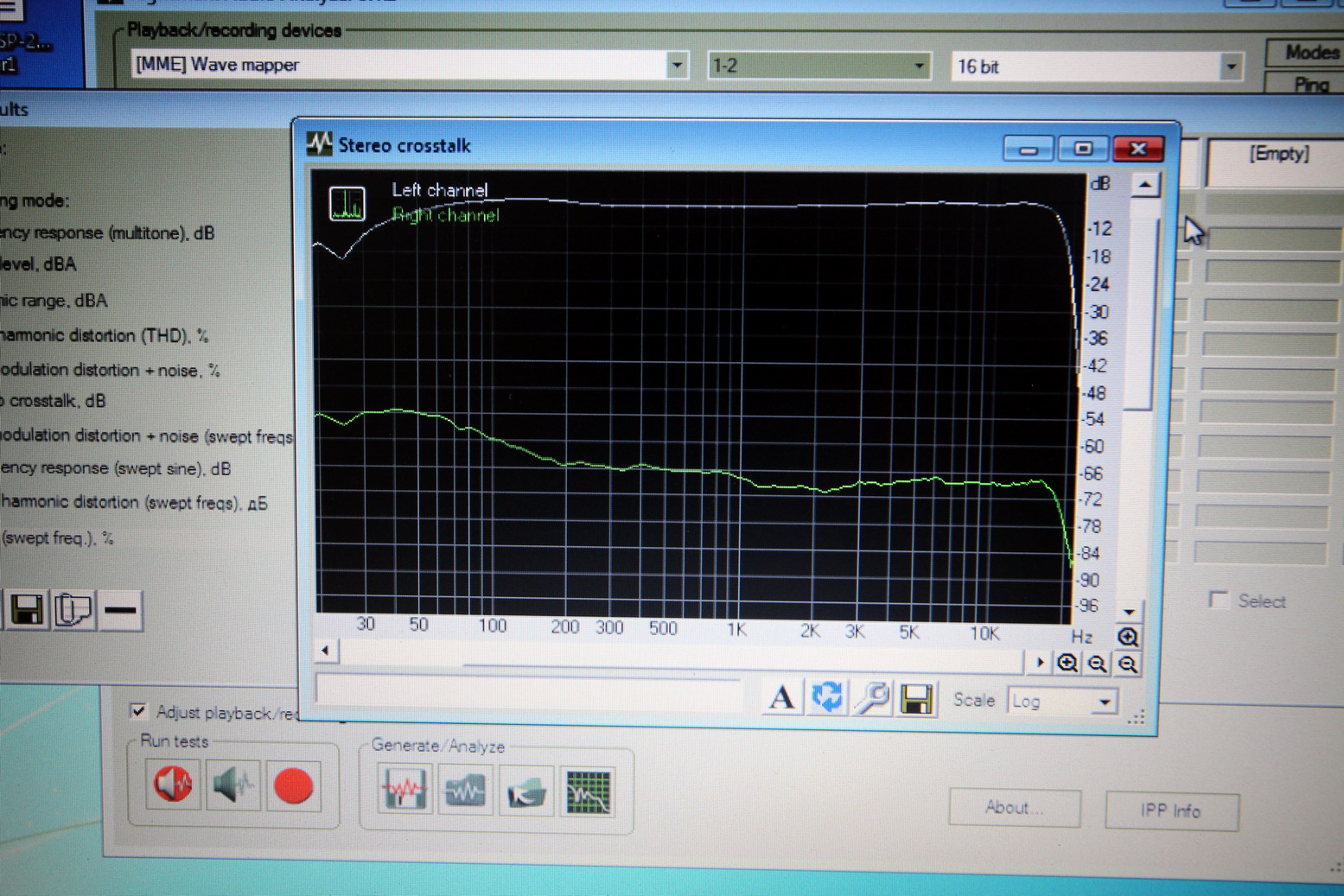

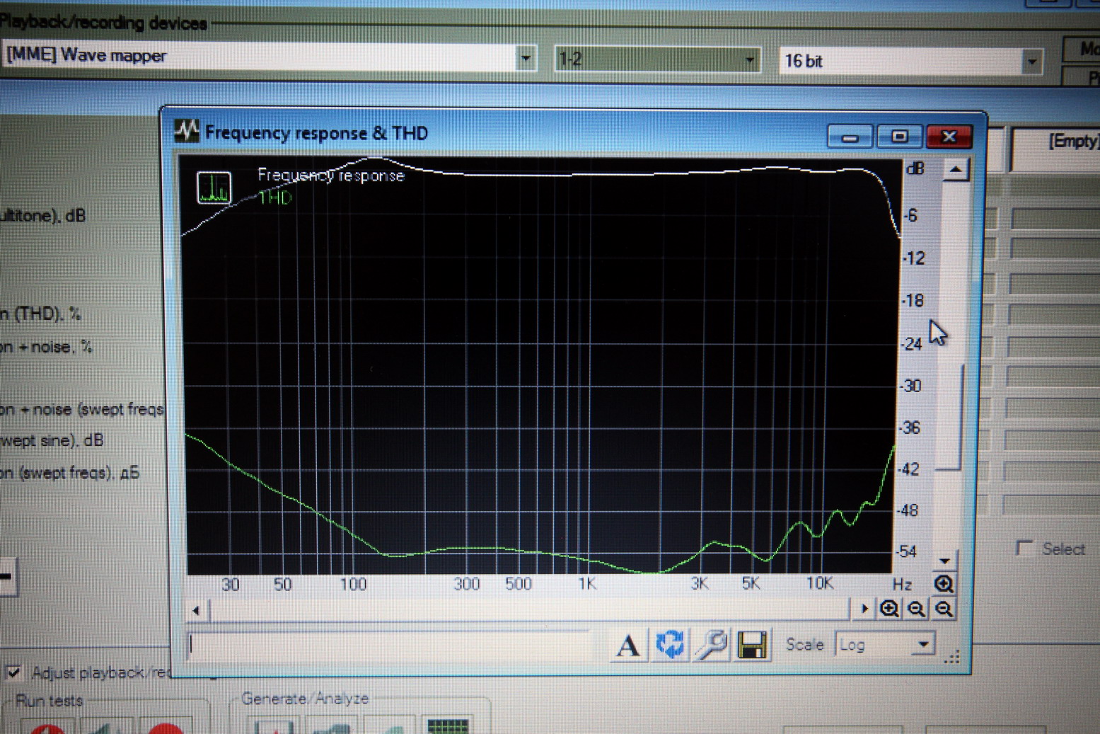

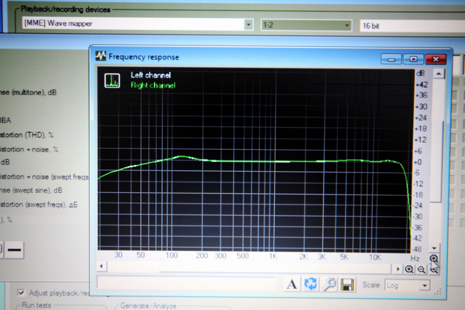

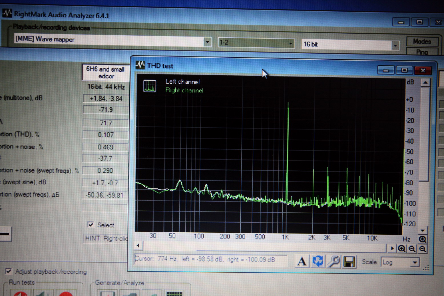

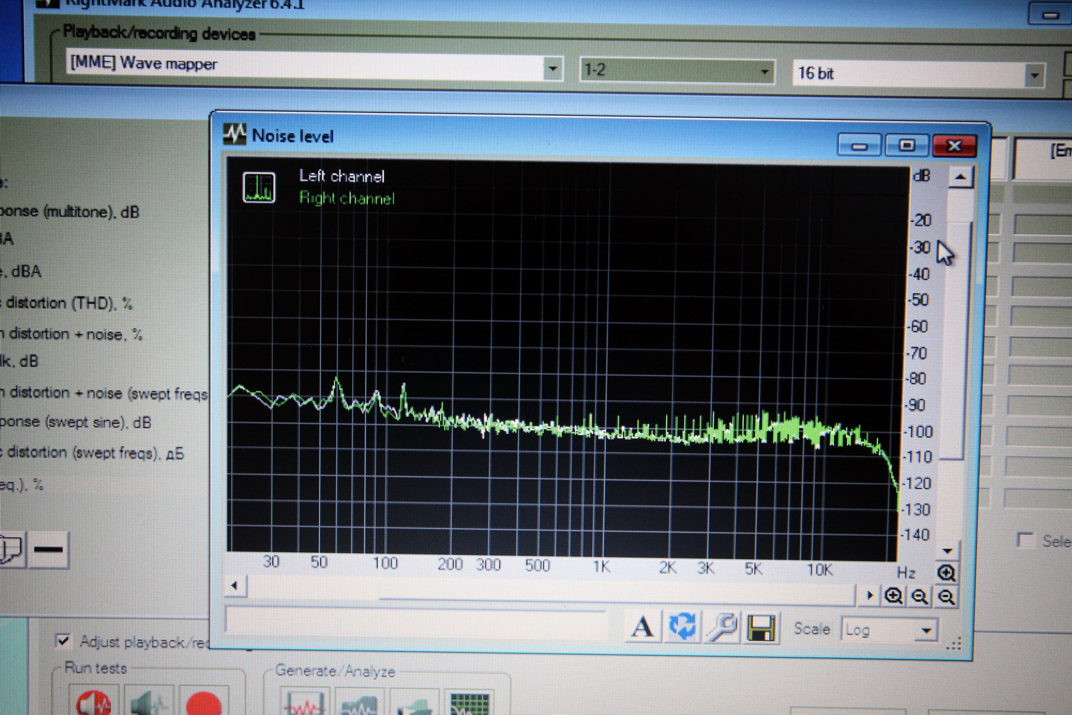

and some test results...I do not know how much watts it can make, but plenty for normal listening, and especially for headphones
It is reasonably flat, -5dB from 30 Hz to 15 kHz, with small hump at 120 Hz, and slowly rolling of below 100 Hz.
It has very low noise (no preamp tube), at about -100 dB, and it is quite clean, respectable at ~0.107% at normal listening level.

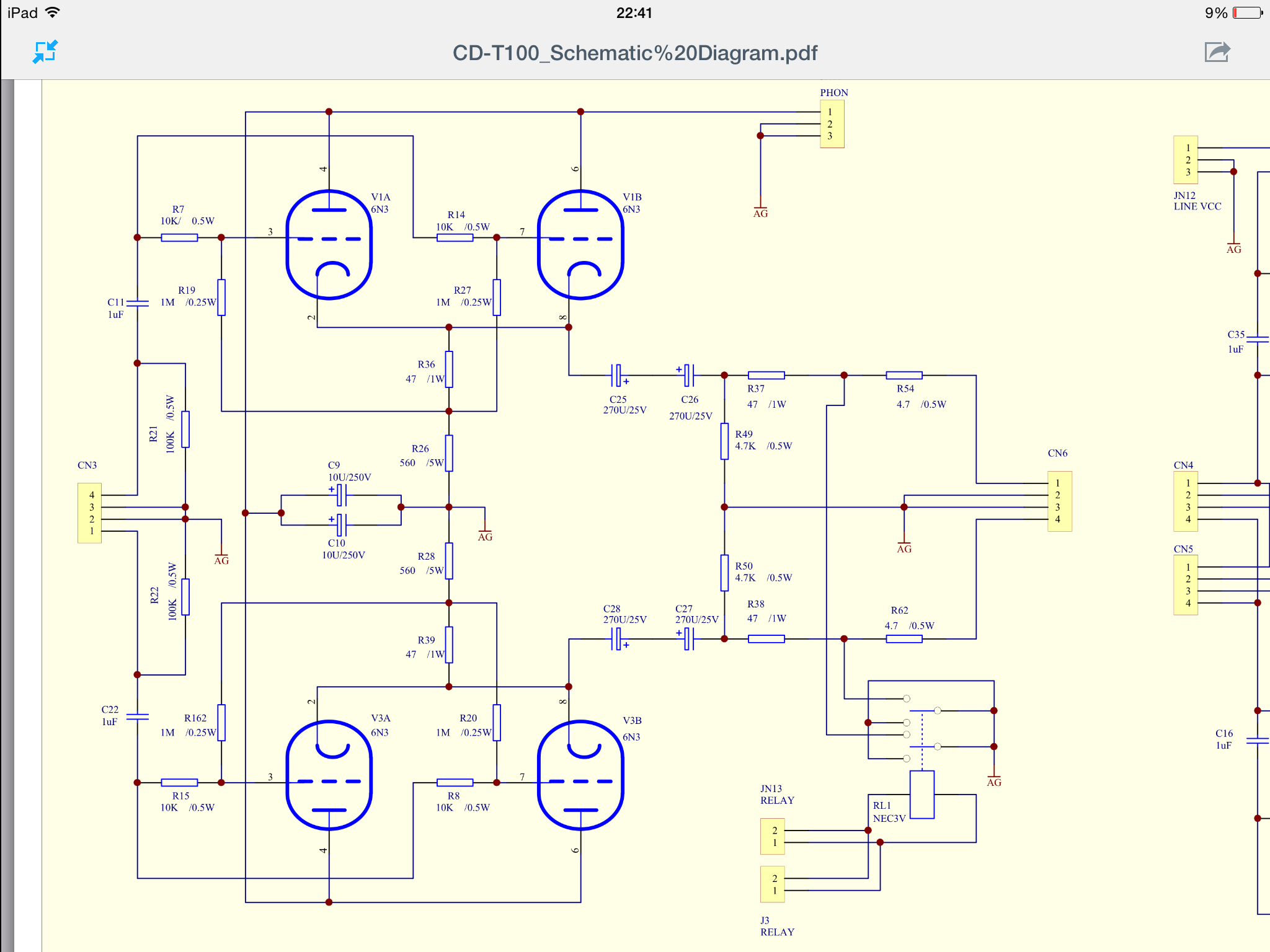

I have 6n6p parallel in OTL for headphone amp. Same schematic as below but then i used 6n6p. Anode voltage is 200v. And if you need some amplification ad a 6n6p srpp stage.I know this is an old thread...

Koifarm, that is precisely what I am looking for...except I would like to drive high efficiency (98dB) speakers with it, so paralleling more tubes would be the way to go. I got plenty of those 6N6Ps. Thanks for the schematics.
Could you give some informations about that amplifier?

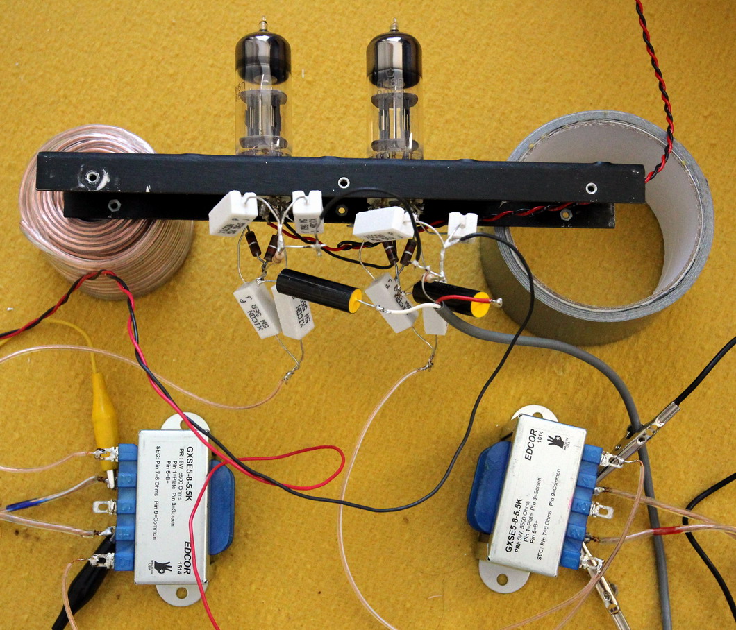

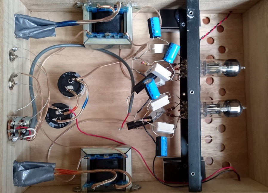

adason, could you please post the schematics with the final component values?Some edcor trafos arrived, so I made simple se amplifier with 6H6P (6N6P) one dual triode per channel. I got some help from lampizator (thanks Lukasz). It works reasonably well. Here are some pics.
