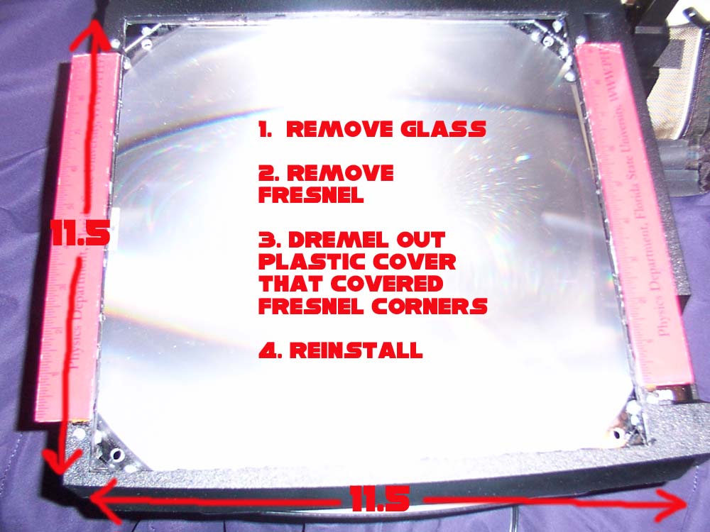

this is how to make a 15 inch lcd fit on the Dukane Starfire 4030 which is a high quality projector.
the 11.5 inches of fresnel under the plastic and glass aperature is just big enough for a 15 inch diagonal lcd......
enjoy........ but i'm gonna salvage the parts and make a box projector.
although the results are good as is........ i can't imagine how much better it will look if all the light is capture to go through the final projection lense.. it should be worth the effort.
