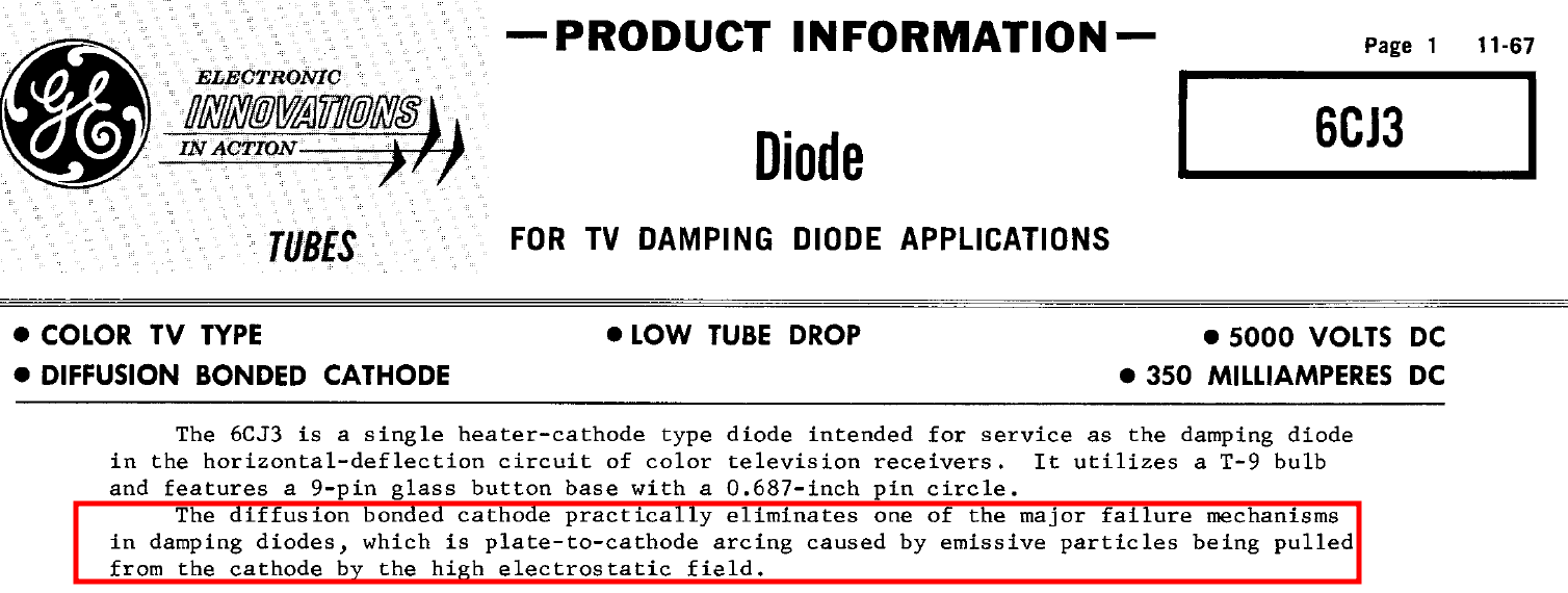

Never quite understood the reason for 6CJ3. Much prefer the 6DE4 - octal socket, less heater current, lower capacitance, same dissipation, readily available.
For 60Hz rectification in tube amplifiers, we don't typically require a full blown 350mA rating, especially when you have two diodes per. Maybe a slightly better voltage drop, but the hassle of those sockets is just blech.

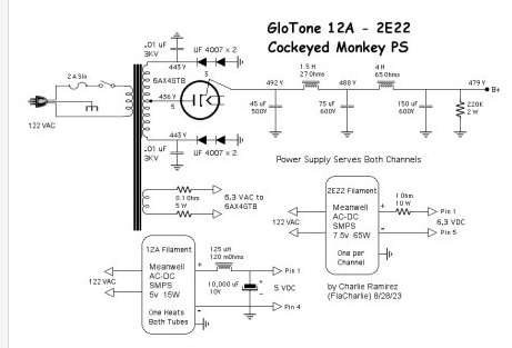

How about as a damper diode, rather than a rectifier? Anyone try using them as flyback diodes on an audio amp? On some of my bigger stuff I put inverse-parallel silicon rectifiers across the plates for protection agains an open circuit secondary. Two UF4007 in series each has worked well in the past on 700 volt supply. But pushing the supply higher I might consider using vacuum state diodes, which would have a 5500V PIV rating (and a higher cool factor). Or would it be an issue to have zero cathode current 99.999% of the time?

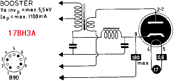

When I carefully observed the internal structure of the tube, I found that pin1 was connected to a white thread that seemed to extend from the inside of the heater. There was no special instruction in the manual, only that pin1 did not need to be used. I wonder if there is any hidden function?

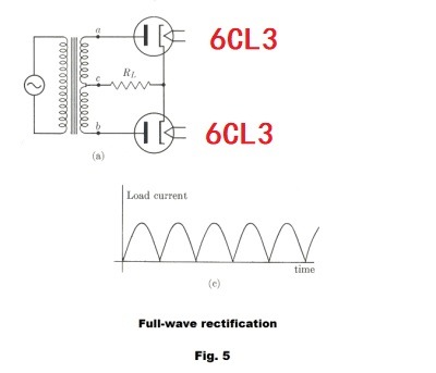

There is no HK voltage limitation problem in damper diodes. 300 V heater positive WRT cathode is the condition of RECTIFIER CONDUCTING, under which cathode-to-plate voltage is internal voltage drop in forward direction, which is about 10-15 V for a typical DD under its rated steady current. In pulse applications the peak current could be about 3 A and internal voltage drop about 150 V (still within the allowable 300 V HK positive). In rectifier application, the positive HK voltage is way below the limit.
With this in mind, I've never had problem feeding heaters of the two DDs in a full-wave rectifier from the same 6.3 V winding.
