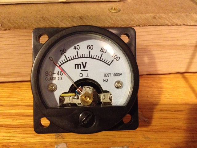

This is really back to basics. I have used nothing but digital multimeters and panel meters in the past, but decided to buy 2 analog panel millivoltmeters to display anode currents in a tube amp, because they look cooler; hopefully one of them is shown below. I measure the input impedance at 13 ohms in both of them.
Am I missing something? Should there be some kind of circuitry in front of this thing to increase the input impedance to maybe the megaohm range, where it would be useful. Could they both be defective?

Perhaps they are actually ammeters, which would explain the low input impedance.
Perhaps fullscale, 100% needle deflection represents 100 microamperes rather than 100 millivolts.
You could rig up a variable power supply, a 100K series resistor, and a couple of DVMs, to tickle the meter and find out. If I were you, I'd make a 3 column table: V_across_meter, I_thru_meter, Front_panel_indication. Then I'd plot the data in Excel and see whether one of the curves is a straight line that passes through the origin.
Fundamentally all meters are ammeters, deflection is related to passed current.

What needs to be done is to determine the sensitivity of the meter (ie, x amps = full scale), then determine the shunt resistance required to create the new scale.
I don't remember off the top of my head the test procedure for determining the sensitivity, but it isn't difficult. Most meters seem to use a standard, eg. 50μA or 100μA. I'll see if I can post a good test procedure.
I doubt you'll need a series resistance. The meter operates via current through its coil; it is only the scale that is calibrated and marked for voltage.
What range of current are you looking to display?
Thanks. At 7.8ma, the needle deflects fully to 100mV, and I measure 100mv across the unit with an accurate digital voltmeter. So that makes the input resistance about 12.8 ohms (100/7.8), I think.

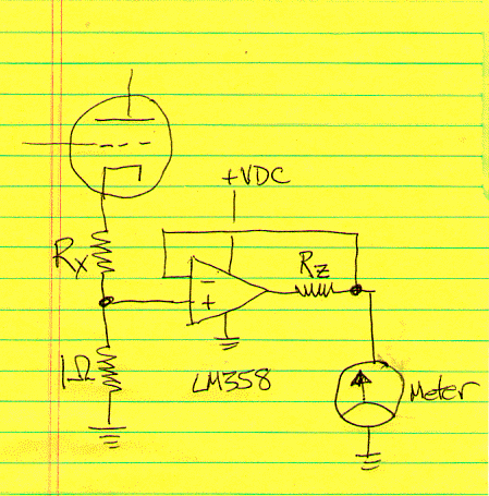

I want to measure (milli)voltage across a 1 ohm resistor (at the cathode). I don't want to put this unit in series and measure current directly.
But I still haven't figured out how to do it with this beauty. Putting a large series resistor in there seems like it would reduce the current so much that there would be no needle deflection at all.
I'll look at allaboutcircuits.com or something similar to see how to get the input impedance up, although I guess putting 12.8 ohms in parallel with 1 ohm is not the worst thing in the world.
You could install a gain-of-1 buffer amplifier between the current sensing resistor, and the meter. Here's one way to do it, using a "single supply opamp" (which continues to function properly when inputs and output are all the way down at its bottom supply rail).
The voltage across the 1 ohm sense resistor, is copied to the opamp output at gain = +1.000, and applied across your meter. Resistor Rz is optional, you can replace it with a short circuit (Rz = 0) if you wish. It limits the current through the meter if things go haywire. Opamp input impedance is > 100K ohms, output impedance before current limiting is extremely low, thanks to NFB.

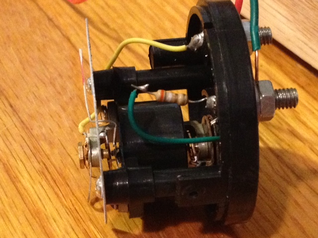

Hi Mike, yup, I expect there is a shunt resistor fitted internally....I have never seen a moving coil meter measuring such low internal resistance natively.
If you open the meter, you should be able to remove this internal shunt, and wire the movement directly to the terminals.
Then you can use external series resistors (trim pots) to set the sensitivity that you require....ie no need for external amplifier circuitry complexity.
Regards, Dan.
Dan,
I took it apart and there is no shunt resistor. There is just a 4 ohm resistor in series between the input and the movement.
Rechecked everything. 8.3ma to full deflection, 98ma across the terminals at full deflection.
Mike

Fair enough, it is what it is, designed to indicate 100mV
across some point that has a low source impedance.
You still haven't said what voltage (hence current) range
you want the meter to indicate, across 1R it will indicate
~ 0 to 100mA .
rgds, sreten.
It is always A GOOD THING to use some kind of amplifier to feed a moving coil meter, which is what you have.
The reason is that they are not very forgiving of overload and/or reverse connections.
Many years before the flood, I worked as a tech in a production test lab straightening pointers (gulp!), replacing meters (expensive even then) and finally adding a protection op-amp so that;
1) forward current could not exceed 120% of FSD
2) reverse current could not exceed -10% of FSD (ish)
Easy to do with diodes and a DC coupled amp.
Edit: so have a look at your circuit and see what is the worst case fault mode for the meter.
BTW I still use an AVO model 8 wherever possible. Much easier to believe it rather that jumping digits when fault finding.
Cliff
Thanks for all the information, guys. The maximum voltage (measured across a 1 ohm resistor) should be around 60-100 mV. The meter is pretty accurate - it tracks my DVM perfectly, so I think I'll use it, definitely with the op amp buffer.
