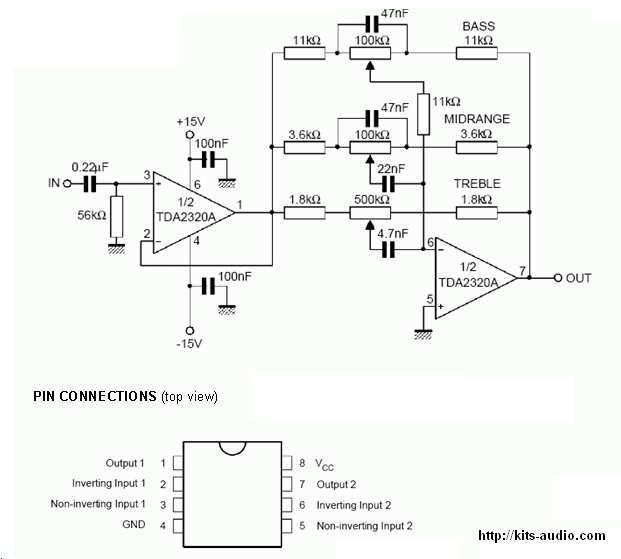

Hi Friends,
I want to use 30Volts DC single ended power supply instead of +15 0 -15 volts which is a split power supply.
I will appreciate if soneone can suggest any kind of modifications needed in this circuit inroder to use with the single ended power power supply.
